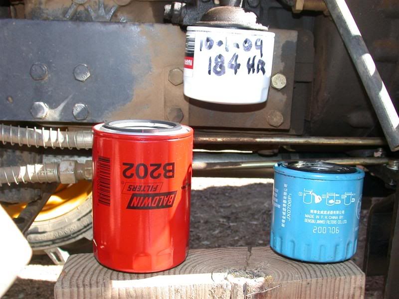

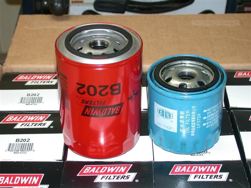

Hi guys,
I used that Napa 1381 oil filter for on Loretta's 284 which has 20 X 1.5mm threads.
I found a Baldwin (B202) cross over with 20 x 1.5mm threads. It's a little larger in diameter and a lot taller. It fits perfectly on her Jinma and has a lot more filtration surface I believe.
Click here for the specs on it: Baldwin B202 Oil Filter Specs
But I didn't buy it from that link.
I found a much better price on this link: Icon Heavy Duty Baldwin B202 Filters
I bought a case of 12 filters for $5.74 each.
Below are some photo comparisons of the stock filter and the Baldwin B202. Also one showing the stock filter, a Napa filter (2nd line) and the Baldwin B202 filters. They all have the 20x1.5mm thread.
