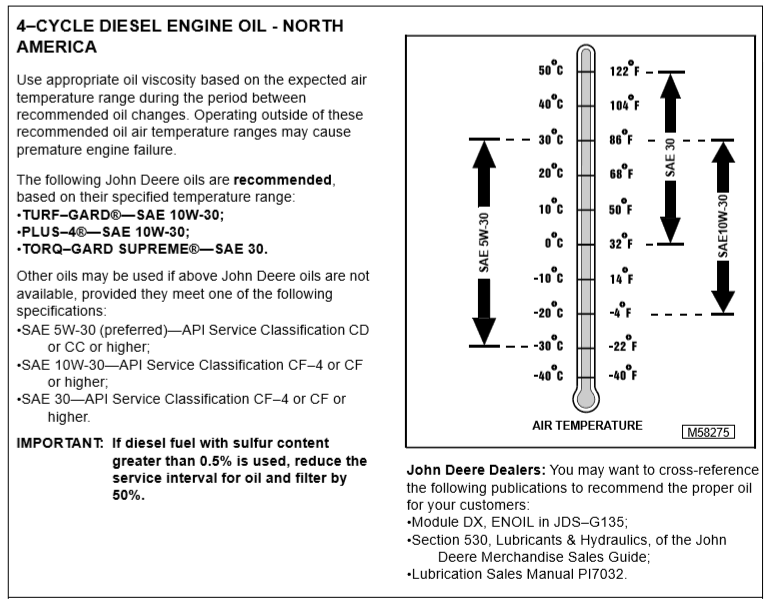

DO NOT use filters with lower micro ratings unless it's a very tall filter with more surface area. You will starve the engine otherwise and cause the flow to be greatly diminished.
Ideally, 20 to 30 micros is best for our diesel tractors.
And we need to discuss the oil as well as the two go hand-in-hand. Yanmar engines for the YM, F, FX, KE, RS are 10W30 summer and 5W30 winter diesel oil. These are JAPAN Made tractors to JIS standards, not SAE tractors that use 15W40. Using 15W40 and very low micro rated filters will cause a short life for the engine needing a rebuild much sooner.
The Yanmar Deere Engineering group worked all these details out long ago.
