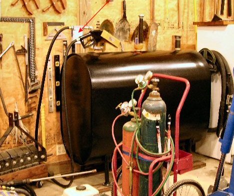

Most, if not all, fuel pumps have a spin on filter just before the fuel delivery hose. Often times it is hidden inside the cabinet.
   / Filtering diesel, at the source? #3
Doitmyself is correct. You can see the spin-on filter indicated by the red arrow that will catch any impurities as they come from the bulk oil tank.
