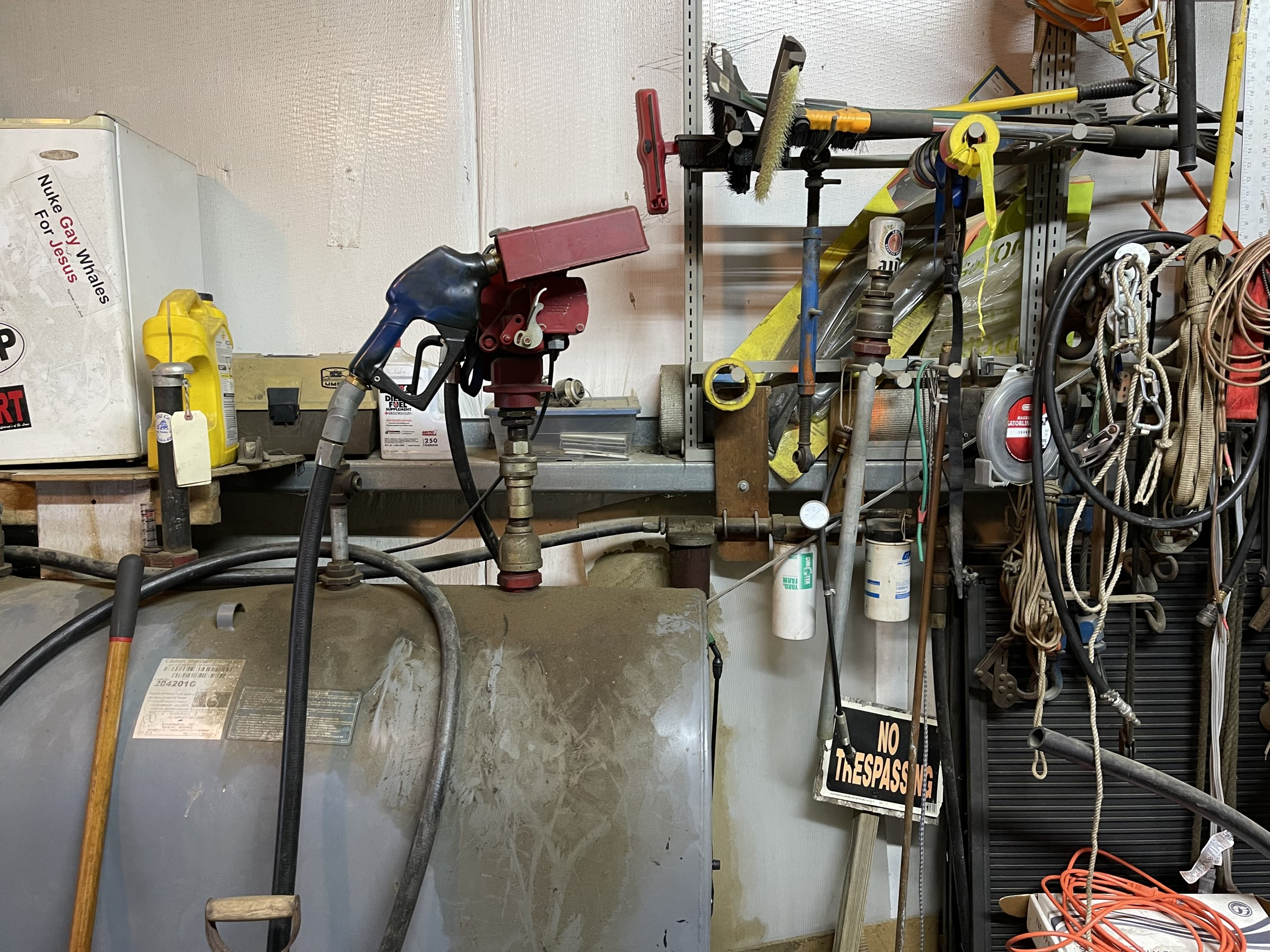

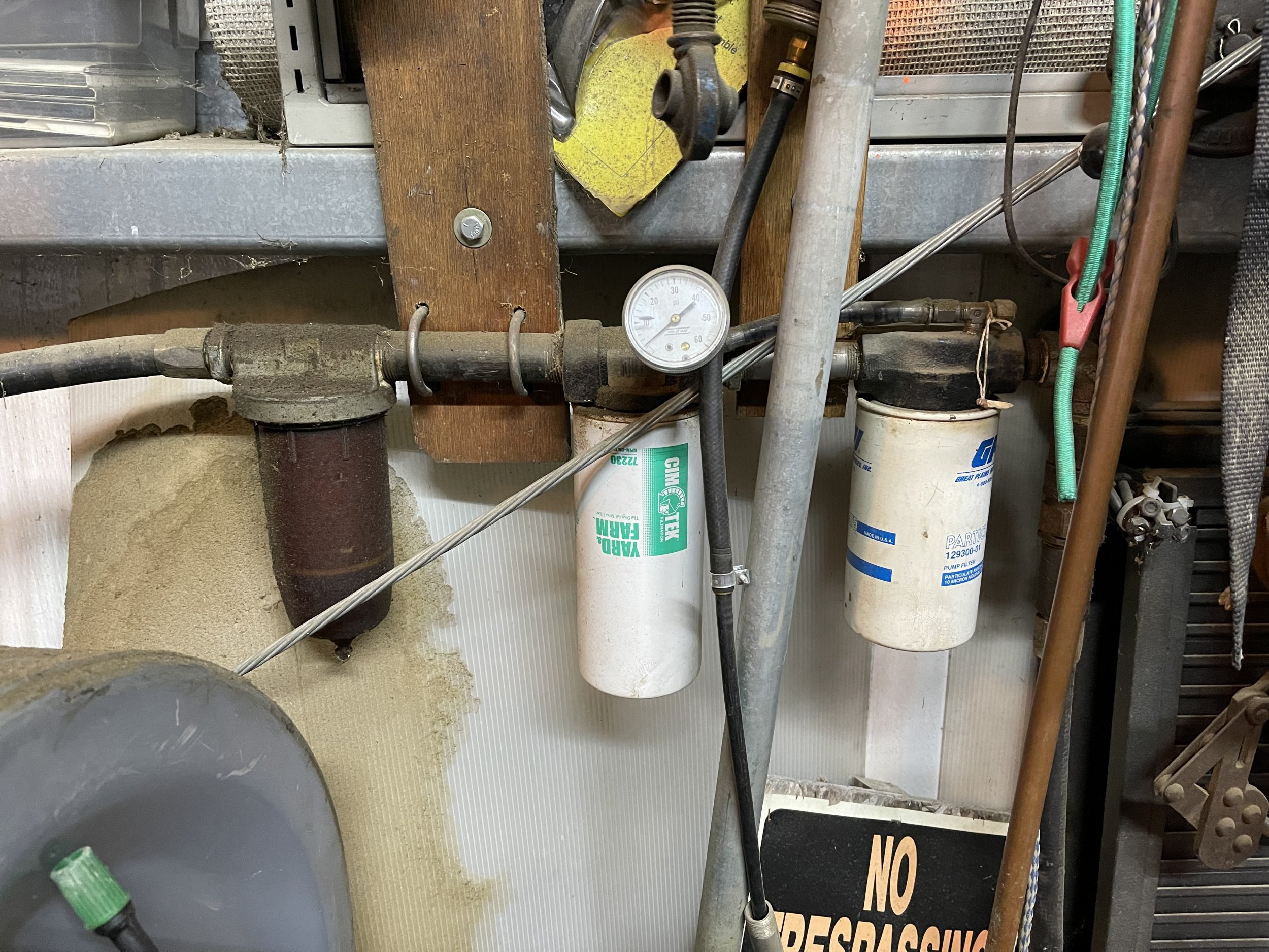

As you requested photos of my fuel filters.
First filter is 10 micron, second is 2 micron with a golden rod water-block final filter.
90cummins

I don't see any benefit from running two filters in series. I also don't use a water block filter on my diesel tank. These filters are all pretty much a standard thread size so it should fit, but wouldn't hurt to check thread size. Any moisture in the tank should condense and fall to the bottom, since water is heavier than diesel. I use a water absorbing "snake" that drops to the bottom of the tank and pulls back out with a string. I've never noticed this thing to have absorbed any water either, and I've never had any issues with water in my fuel. Maybe I'm just lucky. Who knows?
You know, I've stated that condensation in fuel tanks is WAY overblown. I too have never encountered any water in my fuel tank. I have a separate water filter, and while it might not really be doing anything it's nonetheless there- don't run through so much fuel that I have to be regularly looking to replace filters.

If by some chance you received a load of (bad diesel) you will wish you had an overkill filter system like mine. I had an issue with fuel once, don’t know how or why but I said it would never happen again thus overkill!!

Works for me. I see you have a pressure gauge too. I presume to monitor the pressure drop across the media?
