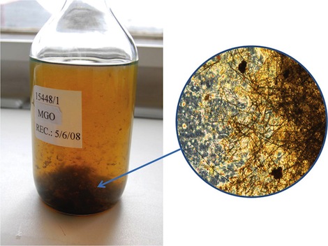

If you are getting a black slime in your filter, it's biologics.
Get a good biocide, dose the fuel, run it till its close to empty, keep changing filters as needed.
Or, treat the fuel with biocide, agitate it, drain it, repeat once and then go.

Do you have (or can get) an 'inspection camera'? You'll need this to look down into the bottom of your tractor's fuel tank. (If you've got a biological growth in your tank, it'll look like cotton-candy mixed with phlegm :ill:) = you'll need a few doses/treatment of diesel biocide and a tank cleaning if that's the case.

sounds like algae to me , FWIW put an inline filter before the can filter after you treat the tanks for algae you can see the particulates and if you change those filters soon enough you will eventually get it clean.
