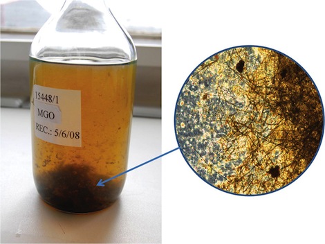

   / Filters #16
For lack of a better more scientific description it looks like someone blew their nose in the tank:
   / Filters #17
Yes, that's exactly what a tank full of algae will do.
Yup plugged fuel system... you need to get the tank off and have it flushed...
Or the easier way you can take the fuel cap off... then the fuel line on the tank side of the filter.. blow pressured air back into the tank MAKE SURE THE FUEL CAP IS OFF THE TANK... anything that is and it is blocking the outlet... will get pushed back into the tank... then you need to try and let it all drain... hoping the clog was broke up by the air enough to pass...
