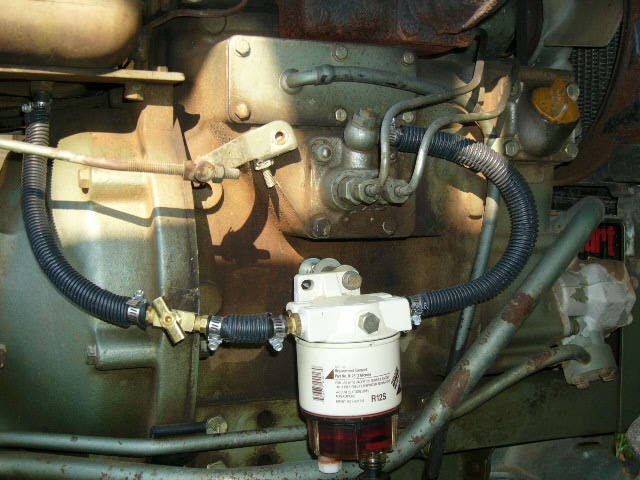

I decided to get rid of the leaking Yanmar fuel filter system and install the Racor 12A. Here is a photo of the installation.

</font><font color="blue" class="small">( I decided to get rid of the leaking Yanmar fuel filter system and install the Racor 12A. Here is a photo of the installation. )</font>
Looks nice. I've used racor filter setups like that on my boat for years. How do you bleed the air out after changing the filter element?

   / Filters #7
as far as bleeding the system, I cracked the two screws above where the fuel line comes in on the pump, and cranked the tractor with the decompression lever down for about 10 seconds..tightened the screws and away I went....

   / Filters #9
There is a drain on the Racor if you look at the picture. It is the white knob on the bottom. First sign of water in the fuel you can drain the water out without any disassembly. Yanmar doesn't have this on the factory set up. For just a filter, sure the yanmar part is cheeper. If you have to buy the housing or bowl, Racor might begin to look atractive. Nice units that work well with parts available almost anywhere.
chris
   / Filters #10
