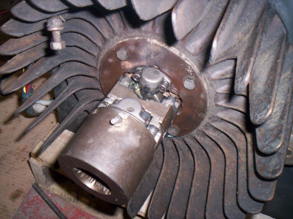

Got most of my parts and have reassembled and installed the right hand final drive gear box. Oh yeah, I had to replace the two universal joints in the engine coupling. Here are a few pictures.

   / Final drive out of my Bobcat 743
coupling shots
