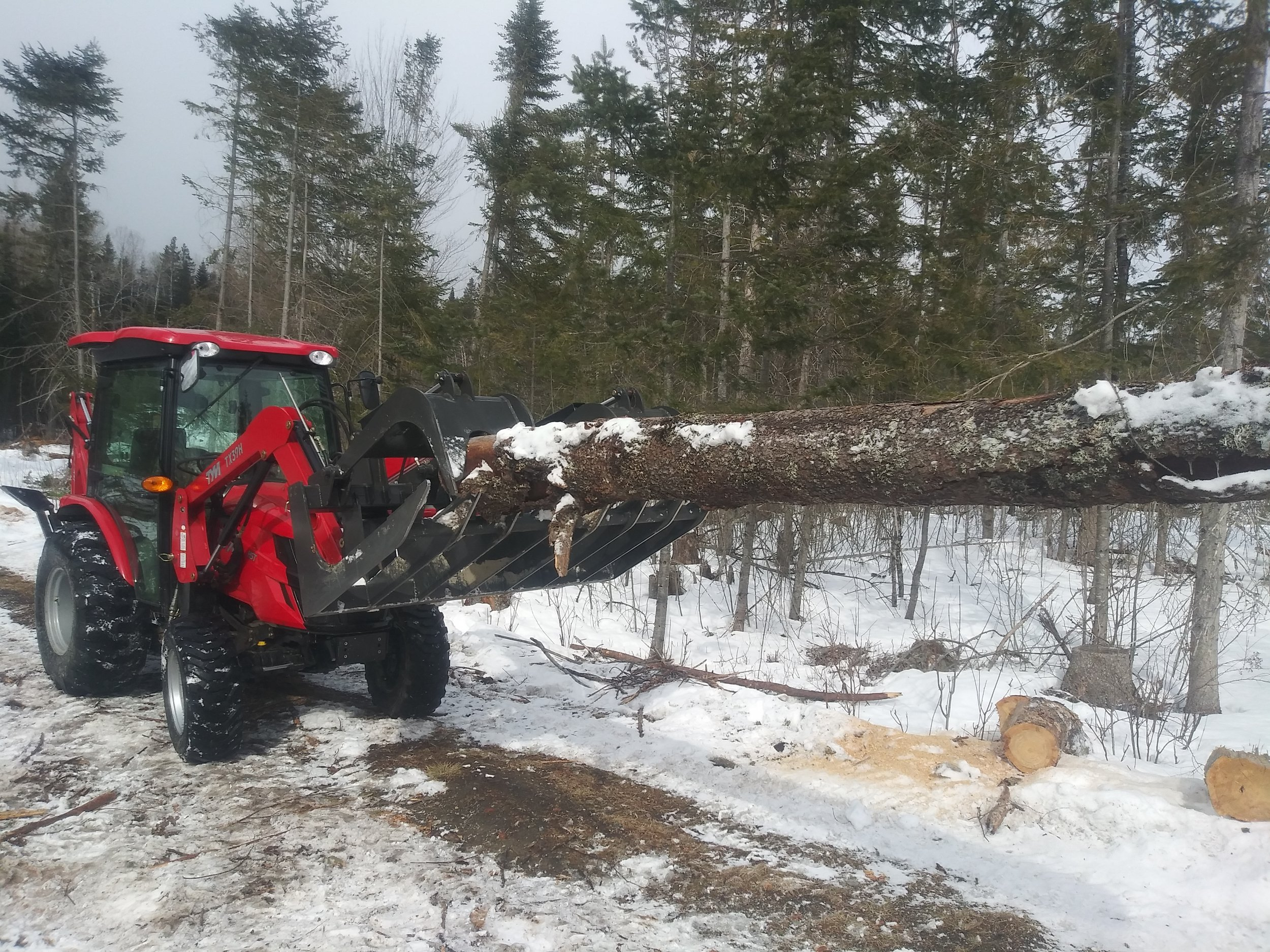

I havea TYM and Scott's was great to deal with. They email frequently to see how happy i am. I haven't needed any warranty work but they are very helpful with questions i have about service. I Have about 200 hours on my T394 cab model which i have had for 8 months. I am very happy with my tractor and the dealer. I live in Jackman if you are close enough and want to give it a try

With Loaded tires and backhoe its VERY stable. I wouldn't be without by backhoe. I dig a lot of trenches, stumps, trails etc. But the biggest advantage to a backhoe is when you make a mistake in the woods in the middle of winter. So many times i was able to free my tractor with the backhoe from the snow filled ditch.
