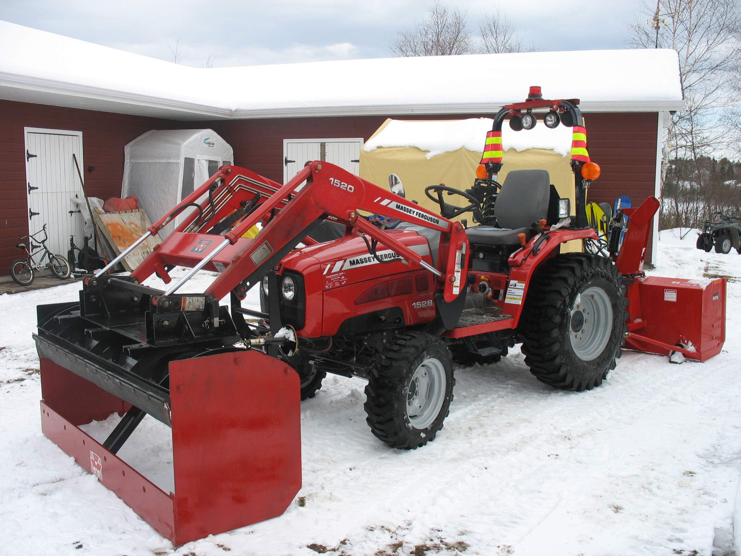

Hey all, have dropped a word in a while but always come by to snoop around when I get a chance. Here are a few pics of some of the projets I did last summer and over the winter..

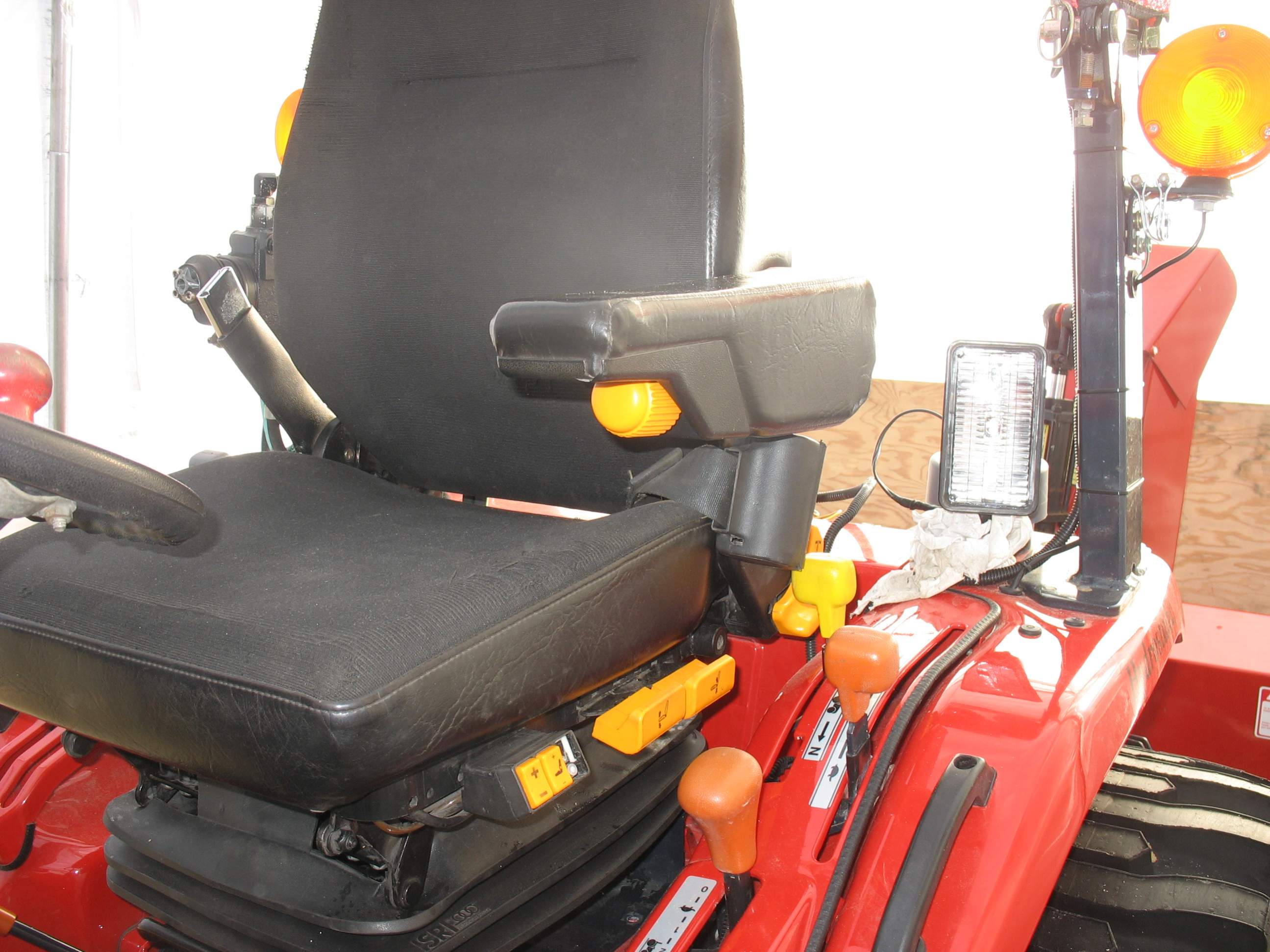

019 and 021 are the new to me ultimate confort tractor seat it is an Isri Hausen fully adjustable air seat......wow what an improvement, I have since removed the headrest and added the right side arm rest.

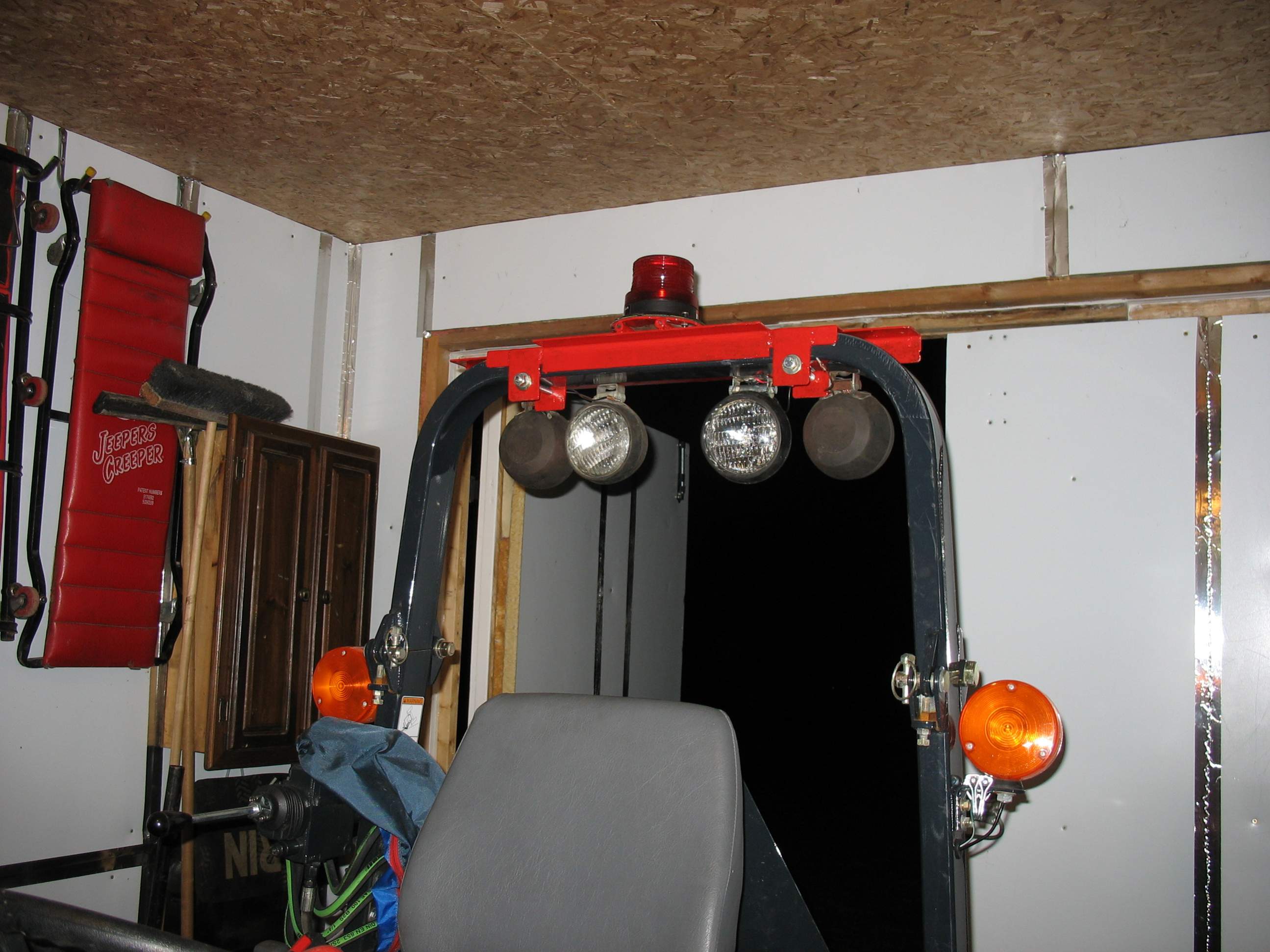

0044 is the light bar i fabricated to hold 2 forward and 2 rear spot beams and a top strobe light

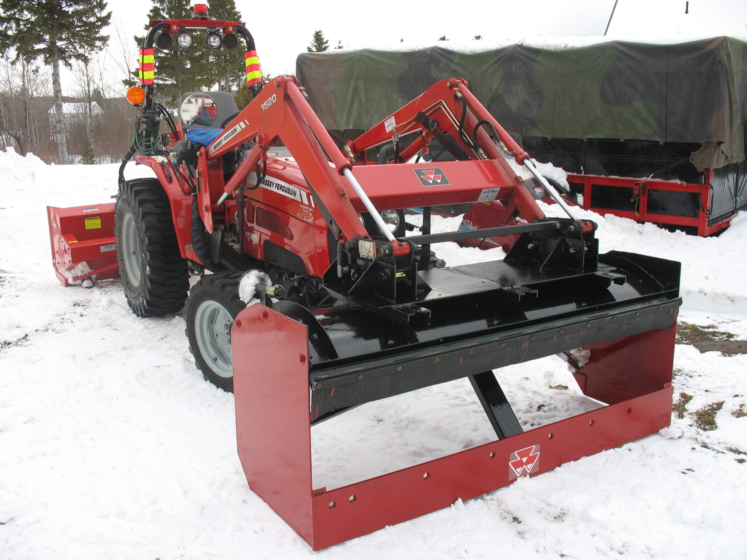

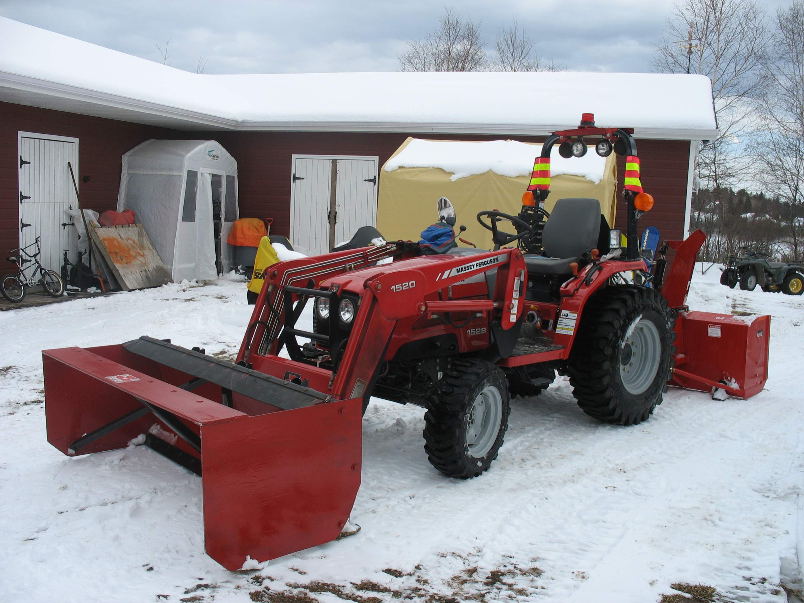

51 to 57 is the scraper plow I built from an old truck plow......man does this thing ever work nice!!!!

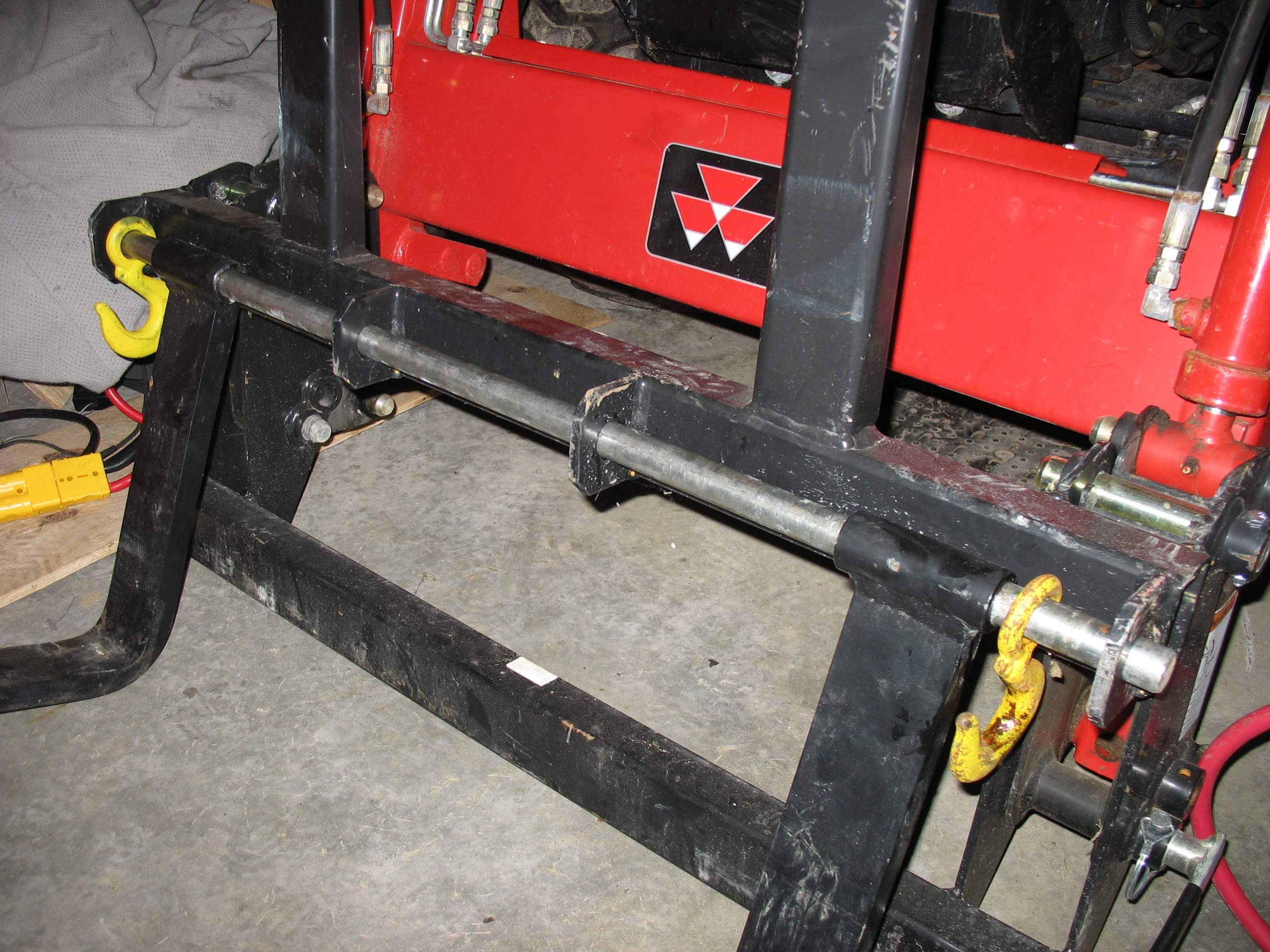

010 are hooks I put on the pallet forks

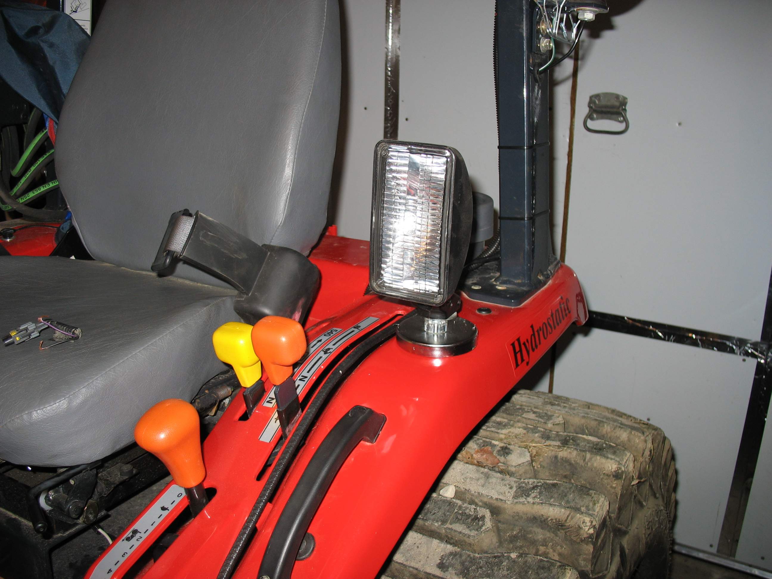

013 is a magnetic spot beam

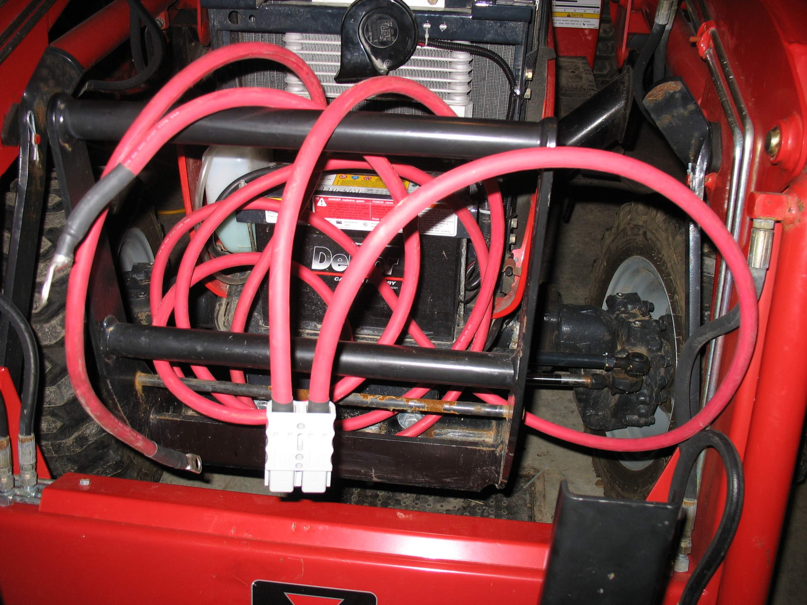

015 is front and rear 12v power quick connect for winch or whatever

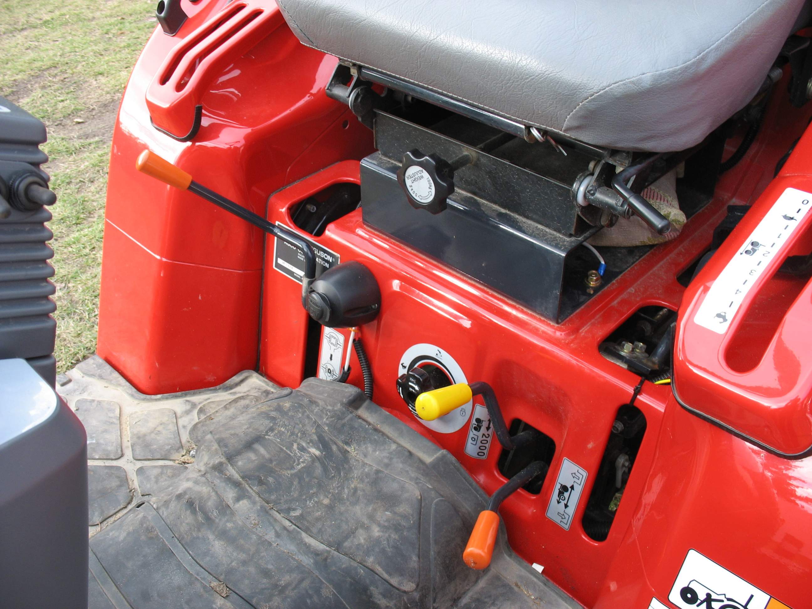

037 12v power outlet under the seat
so here you go feel free to comment....good or bad (well constructive)....:) :thumbsup:

Thanks for posting the picture. Thats the best way to share ideas on how you build stuff. Looks like you like electrical enhancements - some good work there.

Thank you....and if anybody have any questions just ask away, I'll be glad to help if I can. As soon as I find the pics of the ballast box and box scraper weights, I'll post those too.

Nice set up! Im a light addict - spotlights, flashlights, worklights, lightbulbs, etc.
IMO, the orange & green "safety flags?" that are wrapped around the ROP and the red strobe light look gay. If you cant be seen in a RED tractor, you shouldnt be out on it!!!!
   / Finally a few pics of my projects
Well for your information,they may look GAY, but the strobe is required by law here if you go on public roads and the orange and white safety arm bands.... well I just had those lying around the garage with no real use for them so I threw them on the ROPS for now, they are just velcroed so come off easy!!

Doesn't look too bad for me. I am always mindful of the output power of the Alternator. IE if you have a 20 amp alternator and drive with tractor lights and two aux lights you might be drawing 16 amps which does not leave a lot of juice to maintain a battery for winching.
Yeah I see your point David, I haven't had any problems so far and usually the tractor lights are off cause either the bucket or the plow are in the way of the lights so I turn em off and use the aux lights on the rops.... I haven't tried the winch yet either, I bought it cause I got stuck at the bottom of a hill in a trail I made not far from home, could not make it back up cause too steep, so had to leave the tractor down there for a couple of days......wasn't a happy camper...anyways got the slope down a little by grooming it with the boxblade and was able to make it up, got the winch afterwards but now have no problems going up or down.....:)

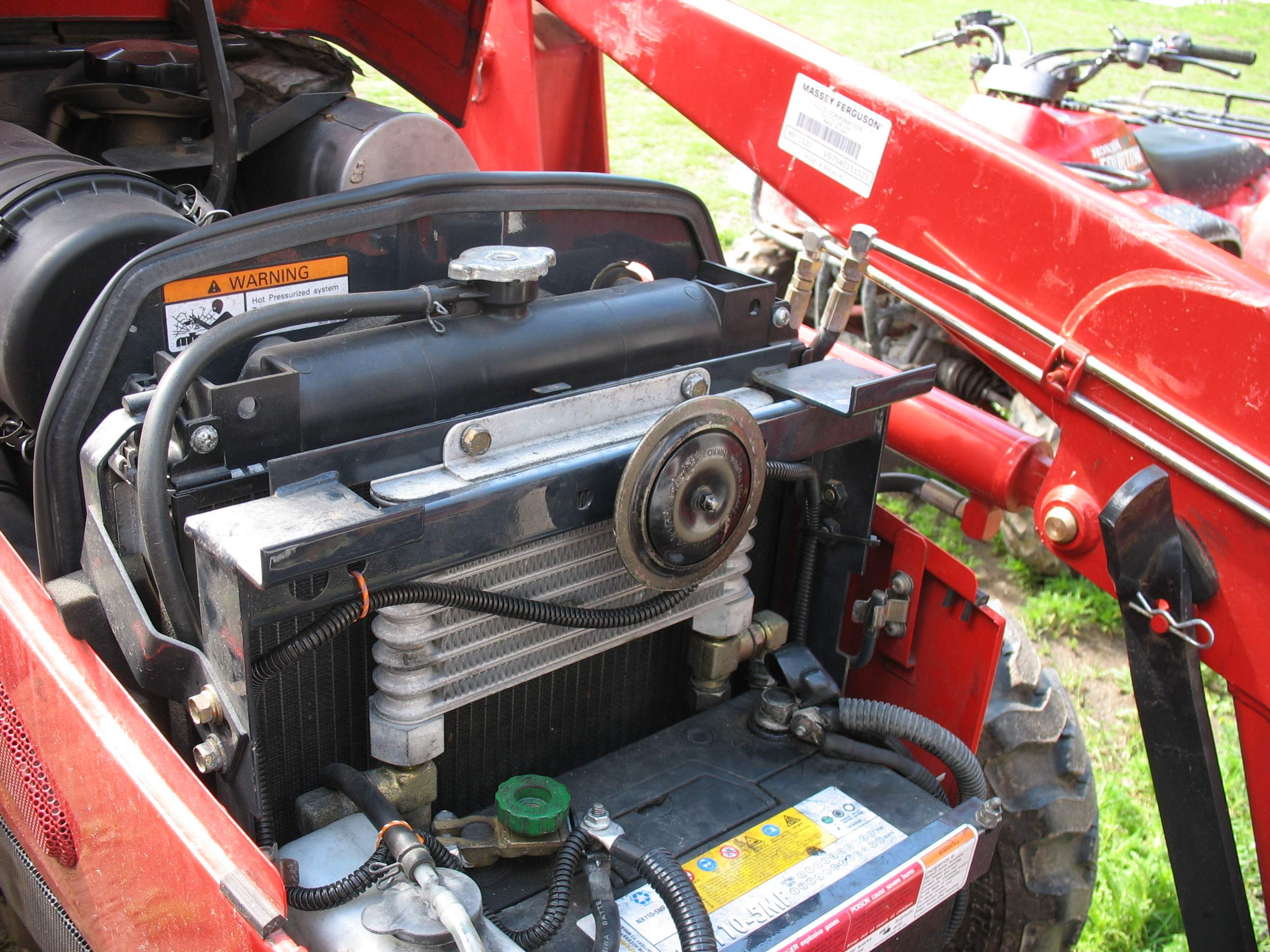

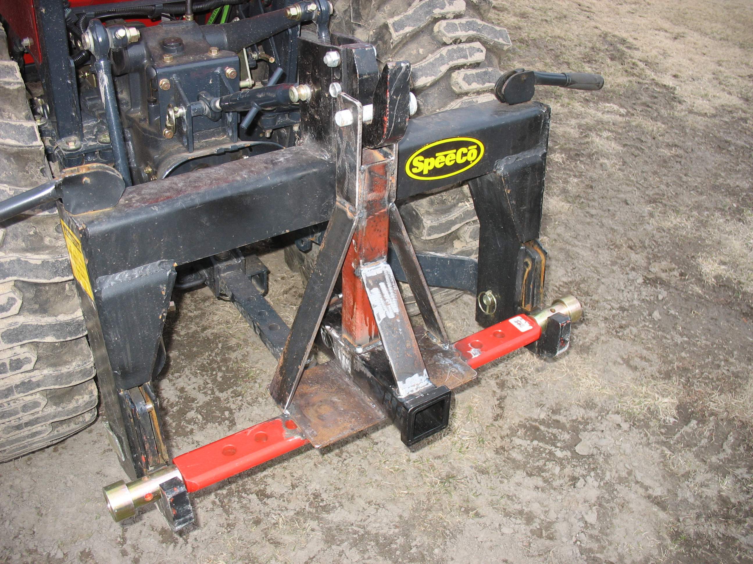

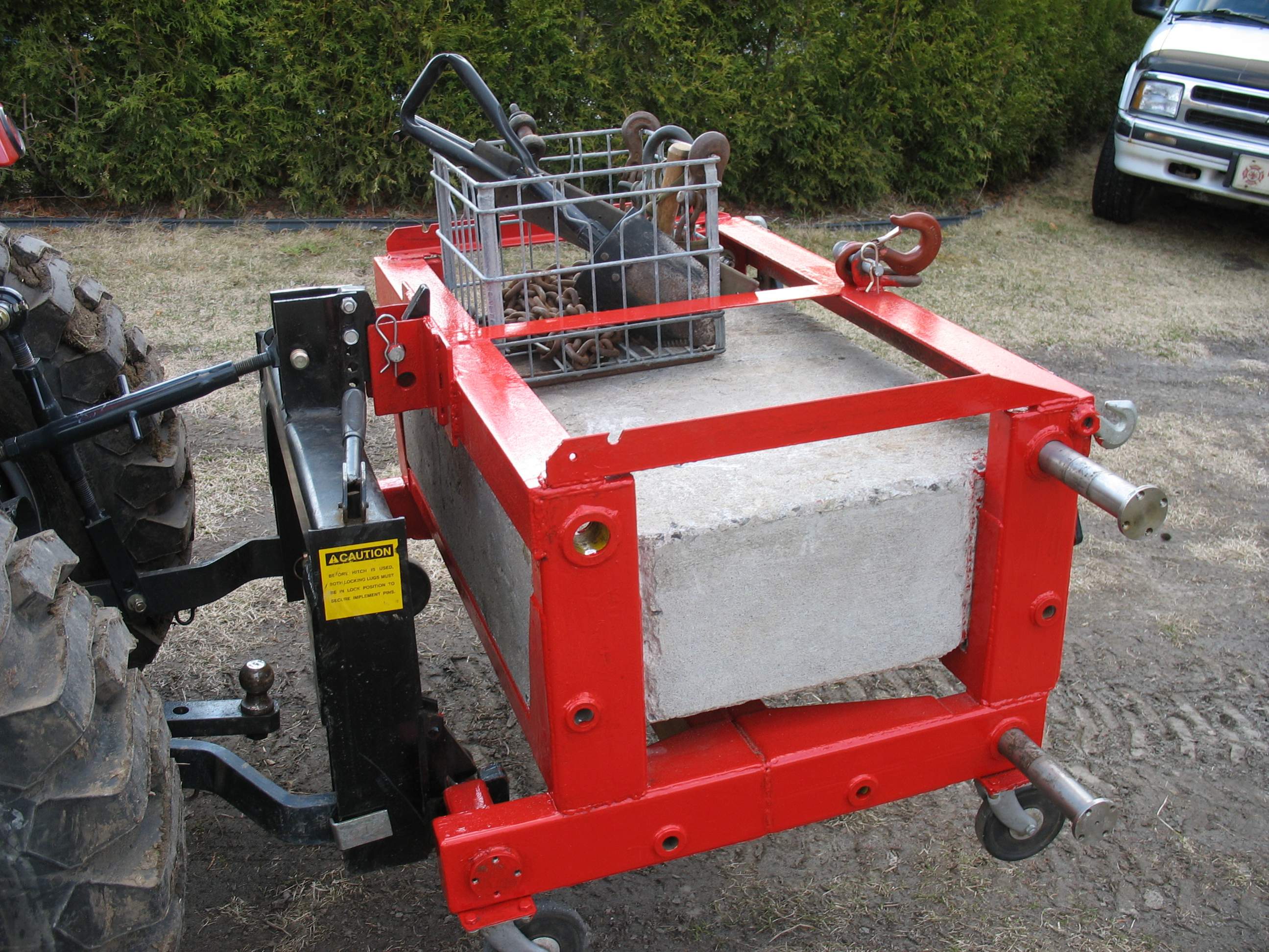

Attached are the 3 pt drawbar receiver project, counter weight (balast box), bucket mods and the horn install.
