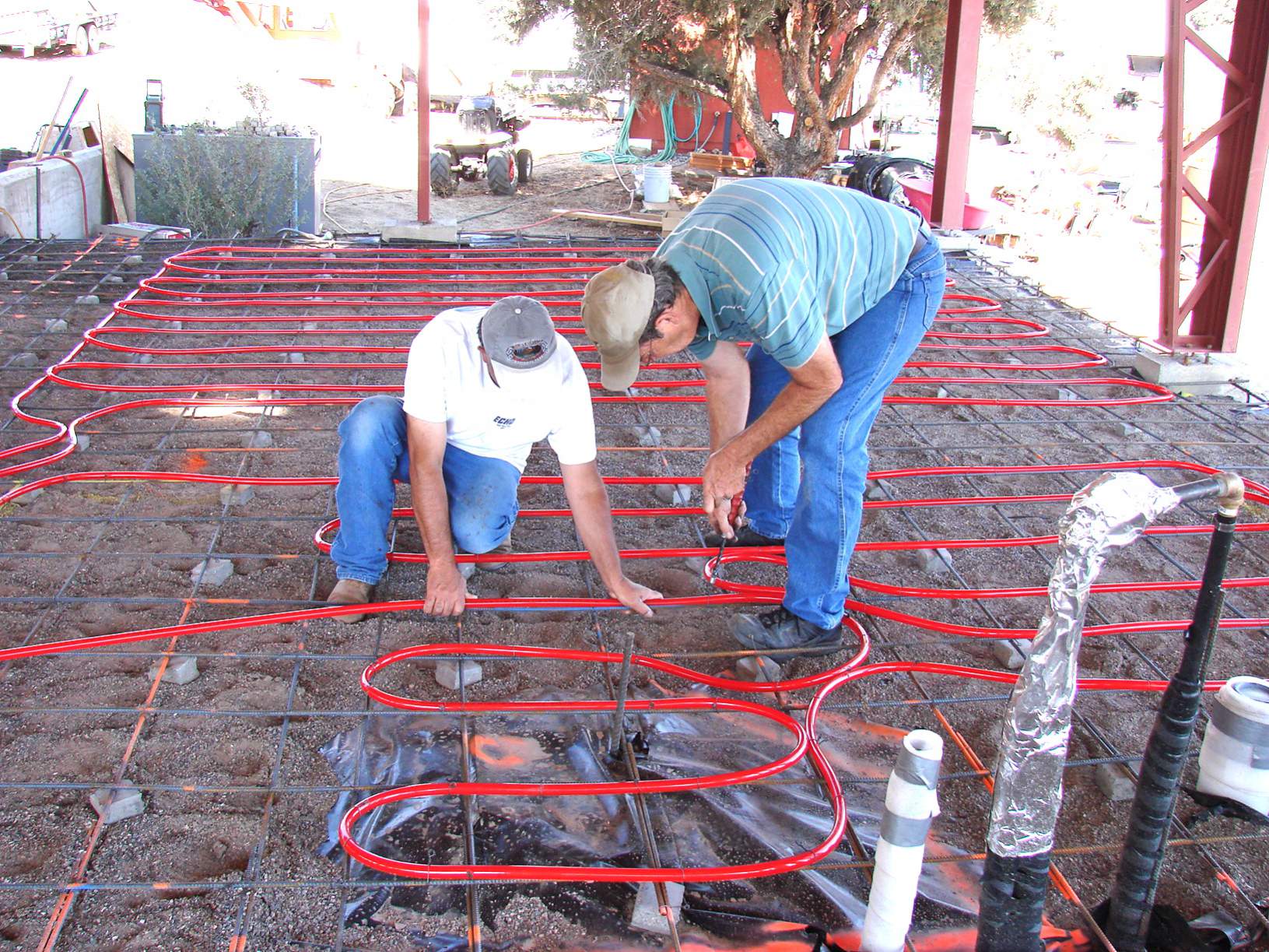

You are most likely to get cracks around your posts and especially from the ones near the door. If you hammer the sharp edges off the post footings and lay a few last minute diagonal bars or ring bars around those posts it will help. Cracks radiate from inside corners in the pour.
Be prepared to bark at the concrete crew as they walk all over your carefully laid tube where it is unsupported by bar. And be sure it is under pressure during the pour!!!!!!!
You'll love the radiant! Good luck.
Diamond shaped cuts around the poles will control cracks

Nawh......no sound and no red:dance1: I don't know if it was just luck or what, because I had to leave the building a couple times:pullinghair: because I couldn't stand to watch it any more. The guys did the best they could to stay off the tube but it was impossible for them to work the mud and stay completely off it.

radient heat is great,it should"nt crack with heat if it is just scored . from Rickshaw

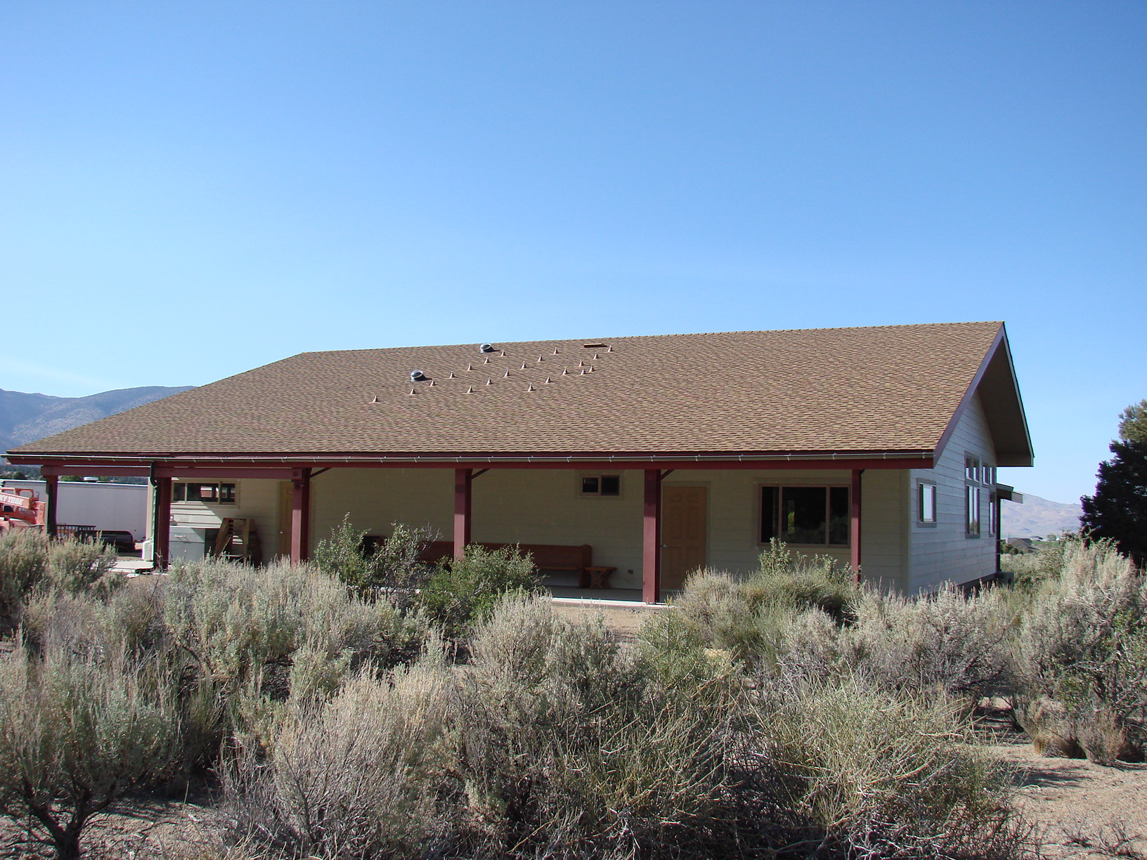

I'm building a 48X60 with a 12' overhang out back, so it comes out to 60X60.
It has rigid beams for seismic strength that are 12" X 8" box steel and 8" X 6" box steel. They have 19" square pads that bolt on with 1" bolts. Well, no need to measure them before pouring the footings, right? I had to shorten both of then by 8" to fit the structure. Then I misunderstood the end wall design and decided the steel company had made a mistake, so I built a new steel post out of 12" X 3" channel with all of it's mounting brackets and base foot. Primed it and stood it in place. Only to realize it was my mistake and it wasn't needed. Etc, etc. Lot's of cutting and welding heavy steel. Breaking out concrete. Being creative at adjusting the design. Then my helper poured my porch slab too high and almost all the bolts became too short to set the rest of the posts and pour the main house slab. A few words and a few weeks later, that was worked out.
It's all part of the fun.
