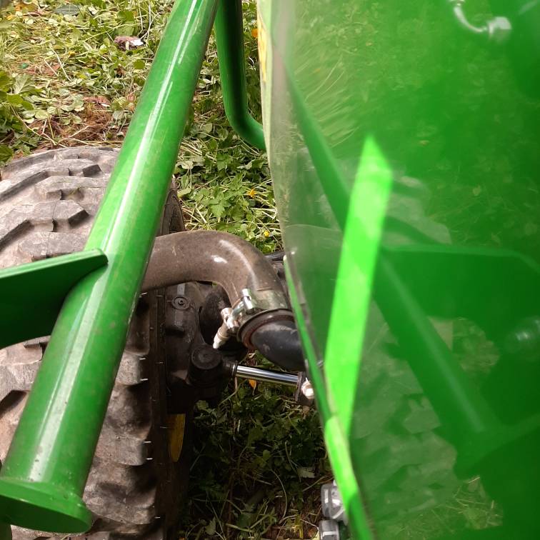

Get a high heat silicone 90 to keep the exhaust from trashing your loader. It's well worth it. Doesn't cost much. You can find them on Ebay. JPEG_20200604_174716_4151550396941933313.jpg
