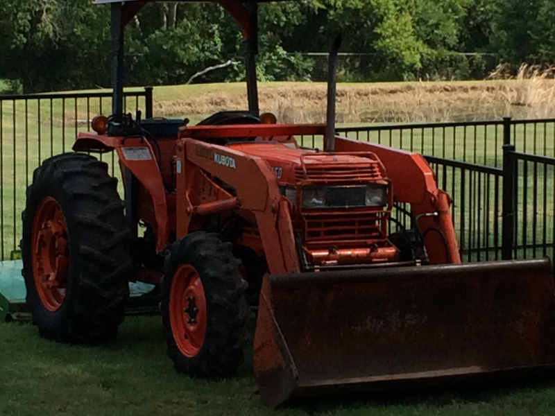

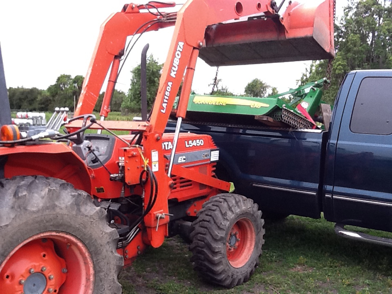

Man I tell you what. I used my new JD MX6 cutter this weekend behind the new L5450, and I must say, I am very impressed with both machines. Honestly, I feel that the 5450 could easily swing an 8' cutter in all but very thick and tall grass. This tractor has gobs of power. Here's a morning pic of it at my house. About to tear into her and try and repair the 3pt hitch.

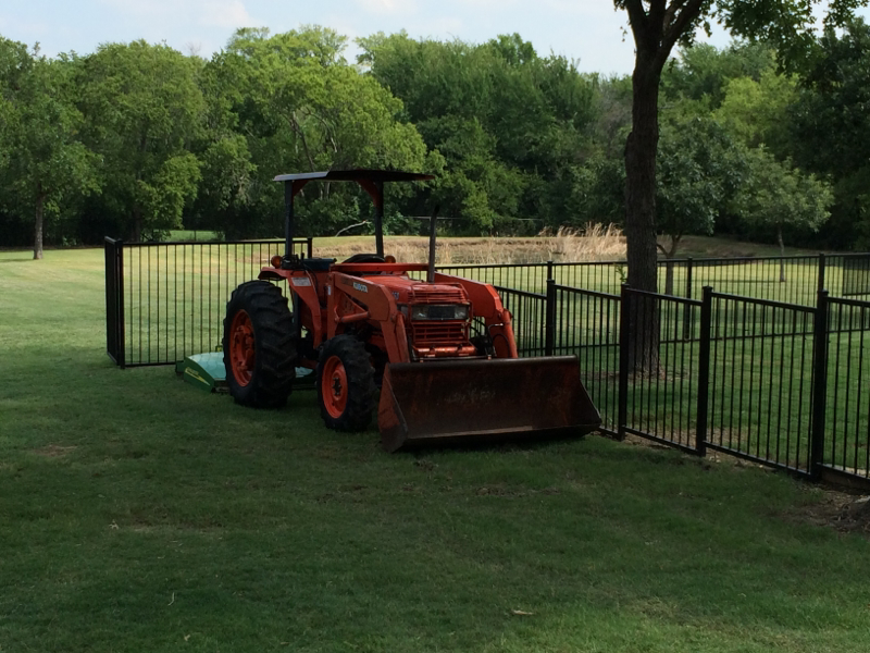

My L5450 is used more than I would have imaged when I bought it 3 years ago with 200 something hours. Very solid tractor. Replacing fence posts in the attached picture.
