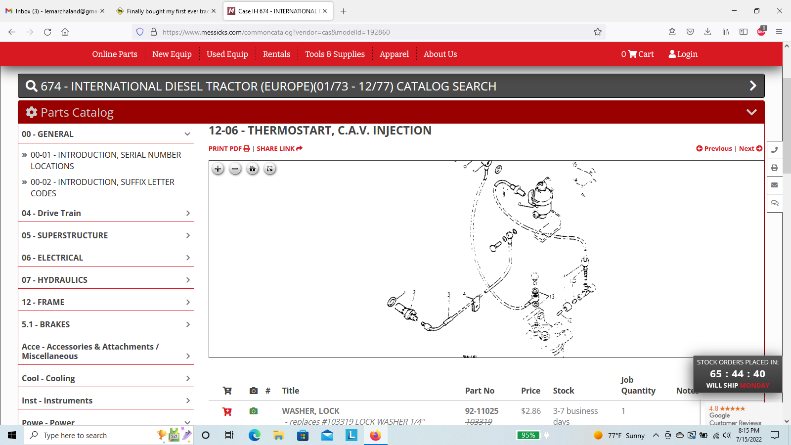

Check your glowplug or thermostart...same thing.
No not the same.
Many of those engines had neither.
The Thermostart was popular on the European models not the US ones.
Thermostart used a small electrical igniter to start a fuel burn in the intake manifold.
Oh contrare. My USA built 1986 Ford 3910 has thermostart. You are correct that it is in the intake air plenum, but it doesn't burn anything--It just heats the air.
   / Finally bought my first ever tractor! International 674! Help a rookie fix it! #25
I'm going to be disagreeing with you on this issue.
IH 674 European version with thermostart;
the little reservoir is for fuel (filled by the excess return line) and #2 is the igniter.
The US version had an ether injector system.
I have been trying to find the reservoir and the lines to add to my system on my 574.
   / Finally bought my first ever tractor! International 674! Help a rookie fix it! #26
Ops, you're partially right. Mine does have a line that tees off the injector leak-off line (the line that runs back to the tank). I forgot about that. I replaced the heater plug when I was restoring my tractor and forgot about that line. But it doesn't burn the diesel, it just heats it as it passes over the heater coil in the thermostart plug. The plug must be hot to open the fuel check valve. (Otherwise, it closes and stops diesel from entering the intake runner.) The hot diesel then passes through the intake manifold to which ever cylinder has the intake valve open.
I looked in my shop manual and there was an optional reservoir. Mine doesn't have it. I rarely use the preheat other than passing through it while cranking to start. Mine starts immediately and I turn the key back to the run position.
