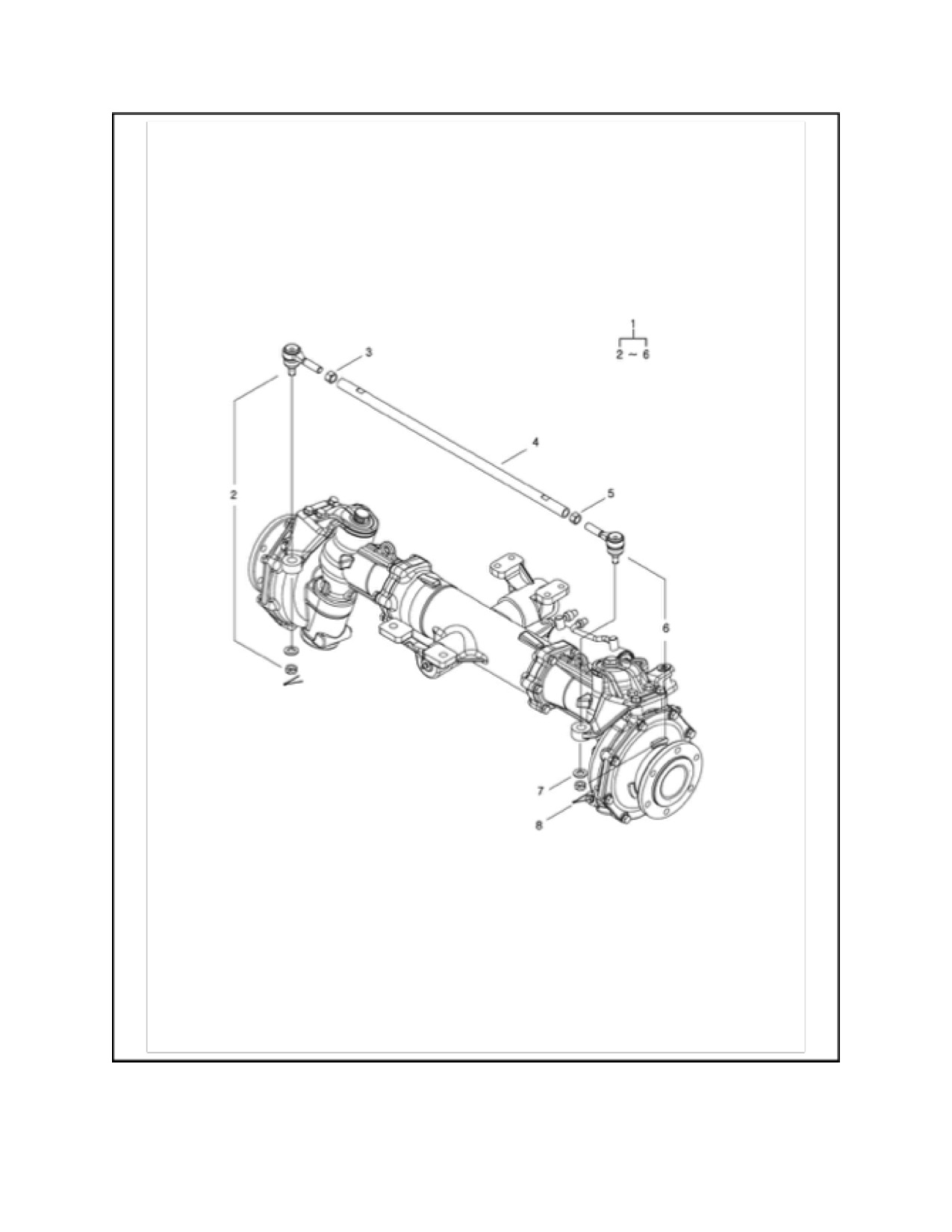

Went to move some small downed trash trees today and when I looked down one of my front tires was pointed the wrong way. The bar that goes between the fronts broke just a bit inboard of the joint at the wheel.
This sucks. Tractor is still in warranty, so shouldn't cost me anything, except maybe a wrecker to pick it up if I decide to send it in instead of just getting the part.
I may do that as it's time for the 50 hour service anyway.

As you can see, we need pictures and more details about what happened and how. If it was a bad weld for example, you might be covered. If you ran into/over something, you probably won't be.
   / Finally broke something
I'm not going to get pics right now, but it's flat ground, no stumps, I'd just driven it ~800ft in largely straight lines down my gravel drive and across a yard. Was just moving back and forth with a light load in the grapple.
It looks like it's broken just behind the the threads for the toe(?) adjustment. Any time I am working in the woods, I have the grapple pretty low to scrape stuff up.
I really don't think this is OP error (not that I haven't made such), but considering it was just a week or two ago that my tractor was fully operational from the dealer (leaks, more leaks, and a bad 3rd function switch), I'm more inclined to go with this is warranty. Especially considering the other guy who had a similar failure and he modified his. Mine isn't modified.

Sometimes, where it broke you can see half of it is rusty or darker, meaning it had been cracked for a while.

I'll look at it again this evening, but other than mud, I didn't notice any discoloring. My dealer is ordering parts today. :)
I'll try to take it apart and get a good look at it 'soon'.
