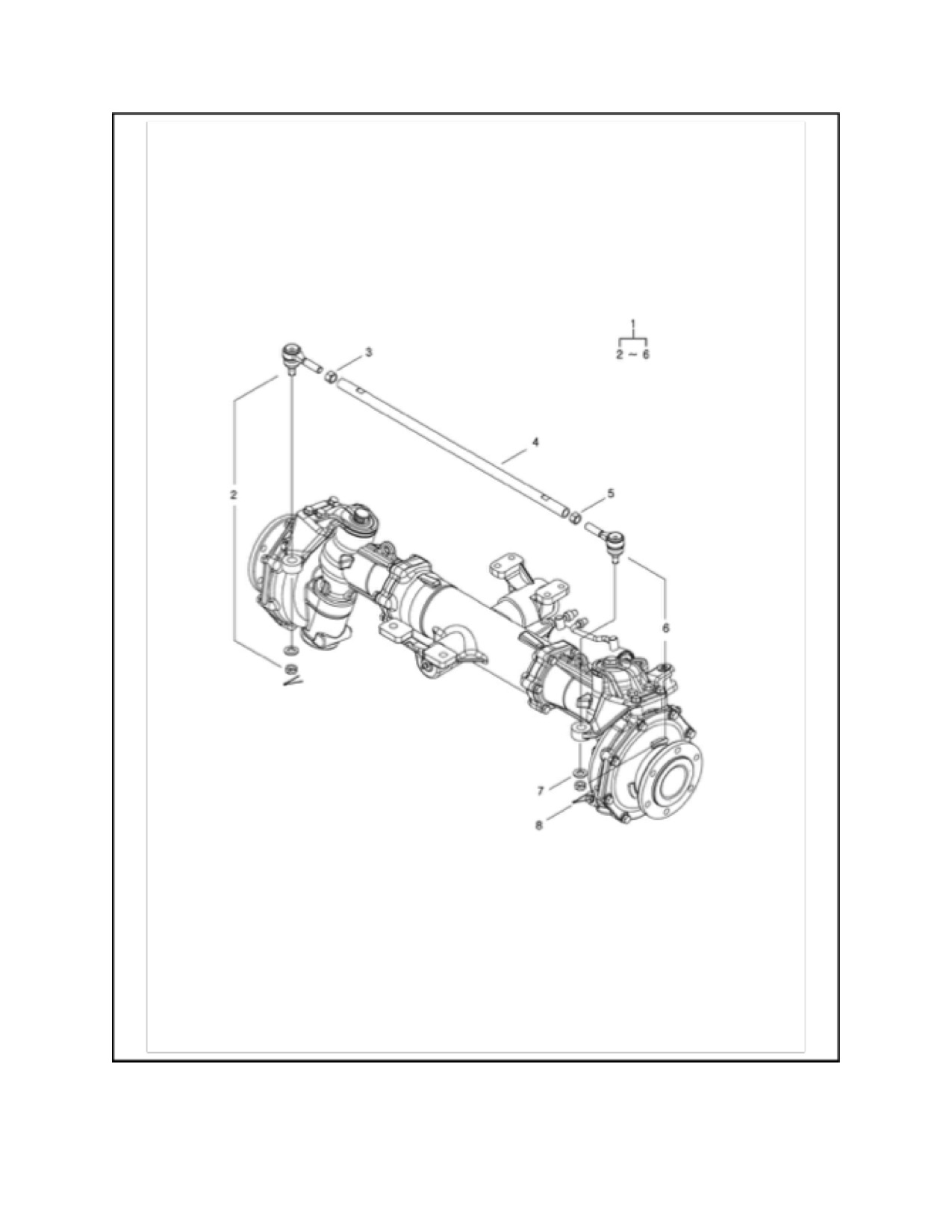

Picture: Shared album - Ty Mixon - Google Photos
So . . . looks like one of us did hit something. Just after that silver scrap there's a noticeable bend.
I'll email my dealership and see what they say. :)
I wouldn't be surprised if your Dealer didn't say something like, 'sucks to be you' and wishes you luck. Maybe you can work outside the Dealer for a solution that does't cost you an arm and a leg and will allow you to get your Tractor up and running in hours rather than days or weeks.
1. I don't want to be in the same Zip Code when your Wife sees that bar on her tile floor.
2. I don't see why you can't find a track bar, drag link, steering bar or whatever they want to call it from a supplier along with the appropriate sleeves and thread your tie rod ends into it.
I would think a suspension shop in the area should be able to hook you up. Hopefully.
I'm just wondering, just asking. I don't know from applebutter but keep us informed.

1. No wife, cheap roll out linoleum in my office.
2. Just emailed the dealer with the pic, and waiting to see what they say. As they dropped the ball on properly installing my 3rd function, and I didn't try to get one over on them, I'm hoping they will go above what is minimally required.

The tie-rod is a common part, and should be too expensive. You were able to disassemble it already so reassembling it with the new one is doable. Since you know you caused the failure, I would be very thankful if the dealer paid for the part, and not upset if they didn't. You're lucky you didn't break the cast portion when you ran it into something. That would be more expensive to repair.
Yep, that's my mind set too. I won't ***** if they don't warranty it, and I'll say great things about them if they do. :)

I think my dealer would warenty it but then i do have a great dealer, but if not i would just straighten it out the best i could replace whats needed and reinstall and readjust the tow in.

Walter,
That bit at the end that's broken off is where the threads are. I can't fix that, and I'm not sure it's be easily fixable any way.
And as the tractor is under warranty, might as well replace it with an LS part to keep the warranty up.

Good luck with your dealer. They have latitude in what they can cover under warranty. They are in business to make money and also in business to keep happy customers. It's not easy. Since that arm is bent they may tell you operator error and not warrantied. They may tell you operator error but we will still warranty it. Or they may just charge you cost for the part and then make it up on the install. Good luck and keep us updated.

They warrantied it. Put it back on in about 10 mins w/ my brothers help. Tractor is now doing well, but it's too muddy to do the work we need done.
