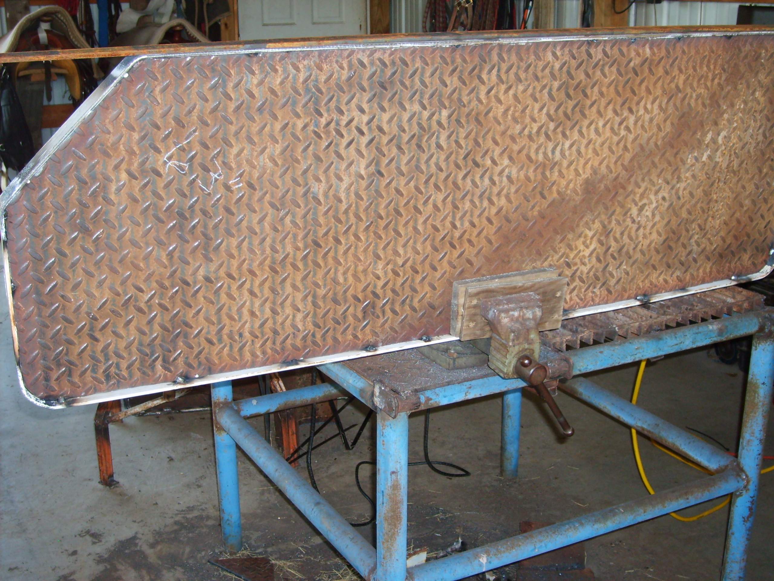

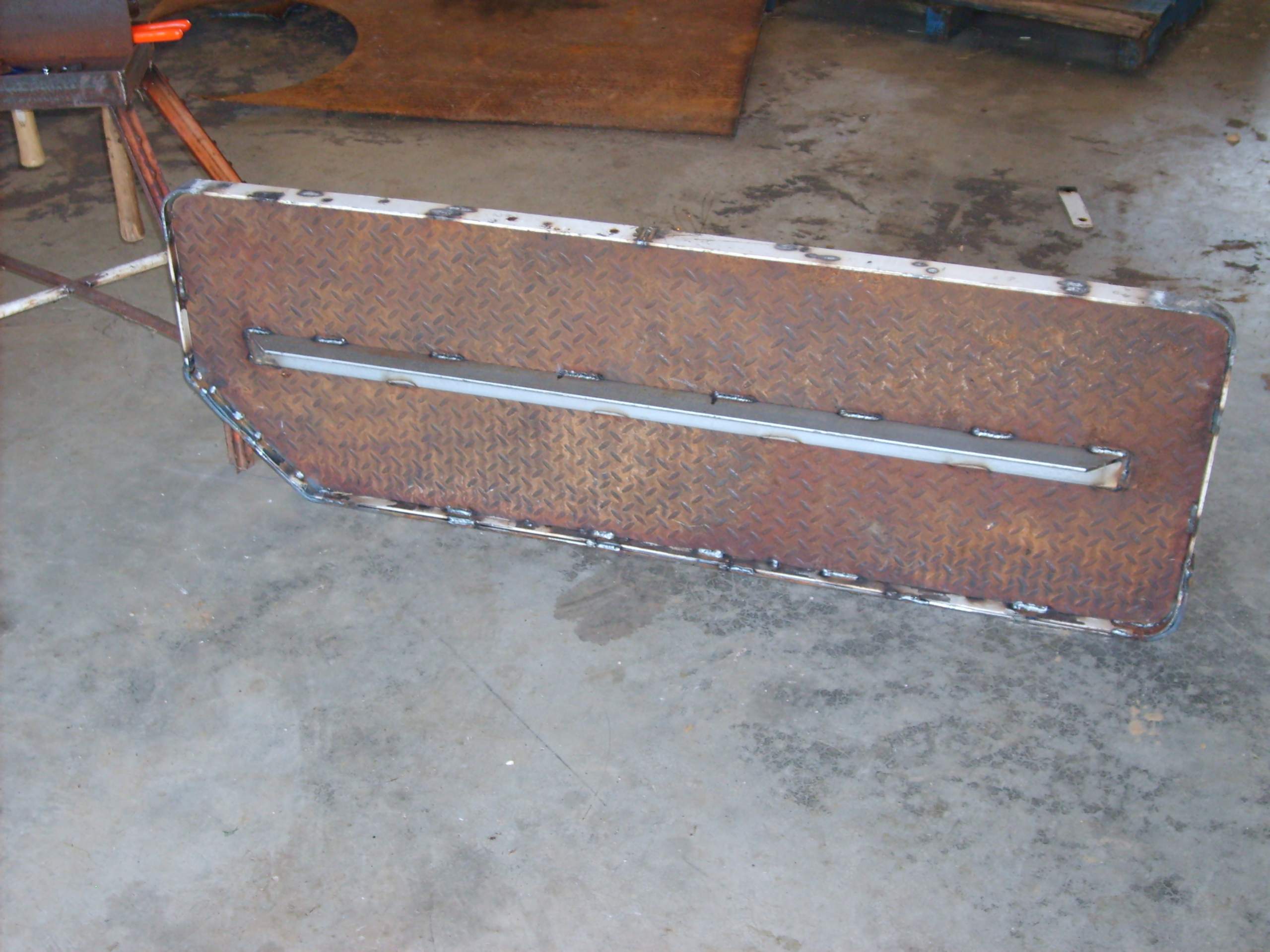

mcd176, the side pans are 3/8", the square cross tube is 4" X 3/16", the round tube is 4" X 1/4", and the riser and braces for the top hitch mount are 3" X 1/8". All the angle is 2.5 X 1/4". I used the extra material from the blades for wear plates on the bottom of the skids, and it is 5/8" thick I believe. It is a lot of mixed up stuff, but I tried to use what I had and could scrounge as much as possible.
