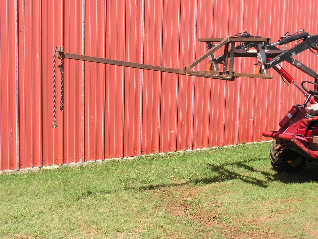

Built my boom pole in the summer of 2005, for long reach light duty lifting. The front axle is solid to the frame, no pivot, so very stable with weight up on the loader.
It sets on the forks, with a brace to the top of the fork frame:
   / Finally got a Boom Pole #28

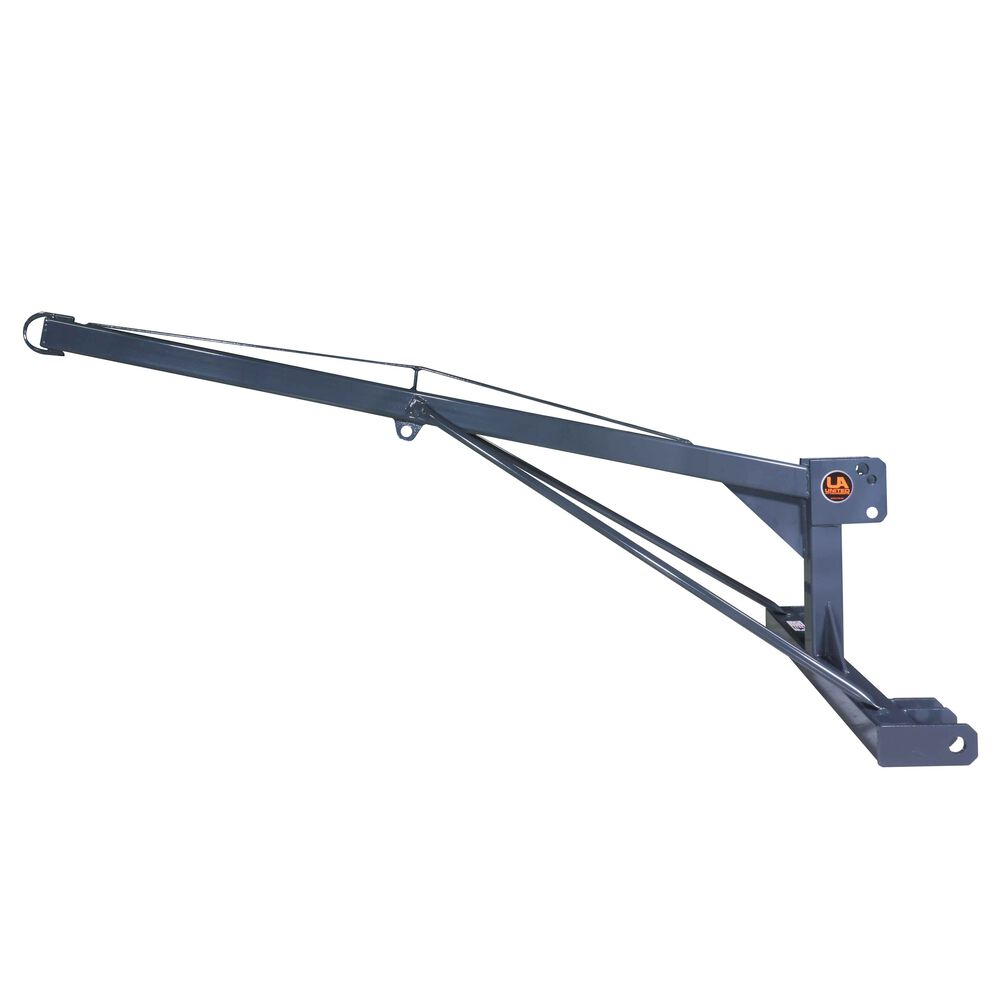

What boom pole is that? I know you are using the titan SS adapter, but I like your setup.
Thanks!
I use this one from Titan:
The design has changed somewhat since I bought mine. The current model is slightly different than the one in the pic I posted.
