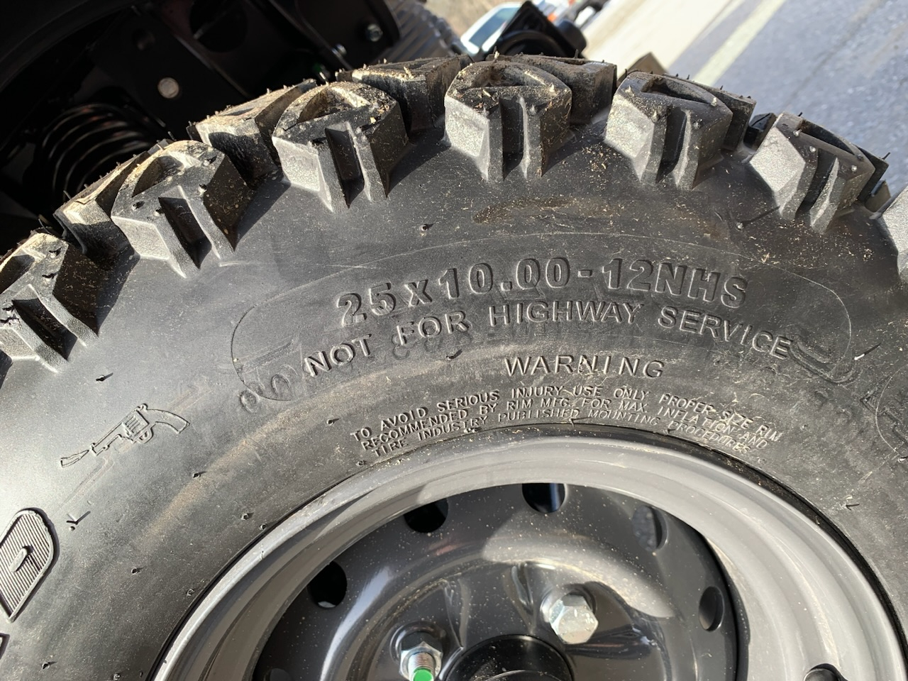

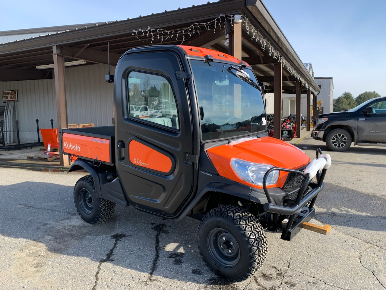

Just back for the dealer and signed papers for an RTV1100C. I ordered it 6 months ago(!). The Boss v-plow is also in and both need to be prepped and set up before they’ll deliver by the end of the year. I’m very psyched.
While there, I took a photo of the tires so I can order a set of chains for the rears (I live on a hill and ice will defeat any tire without chains). I noticed an image of a handgun on the sidewall and wonder what it means. Anyone know?
View attachment 775280View attachment 775281

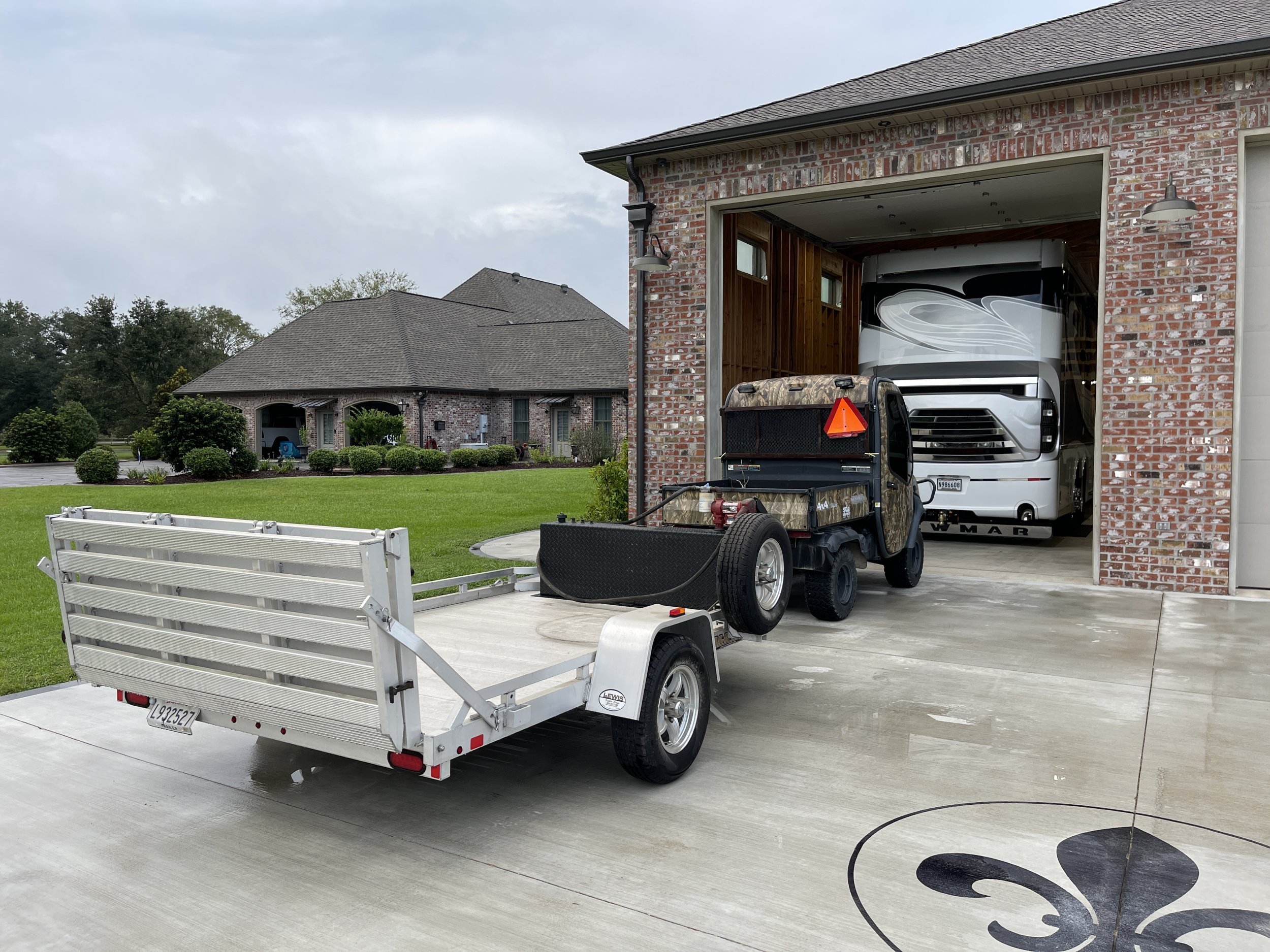

I built a rack for my old 900. Has a headache rack to help protect the seating area.
