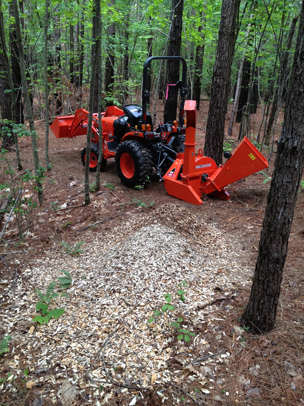

The Wallensteins do cost a pretty penny, but they were one of the best options I came across when shopping. I was really impressed by the easy access to the blades, the standard blower and 360-deg discharge chute, and the ability to swing the feed chute up and stow it. Really helps when maneuvering in the woods where space is tight. And a side bonus I noticed -- the large bolt used to access the flywheel/blades is the same size as the big end of a chainsaw "scrench" tool.
In the interest of balancing colors in the thread, here's what an orange one looks like:
