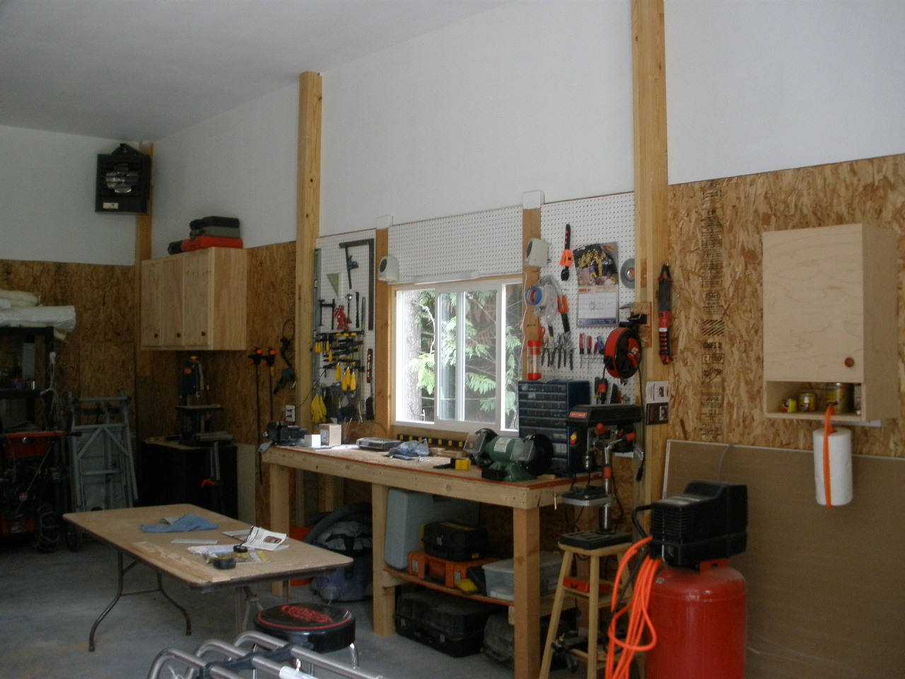

Thanks for the reply's.
Started putting the osb on last week then had to stop to lay plastic for planting. Hopefully can get back on it this weekend. I decided to attache the osb with screws so if I ever need to remove a piece it would be easier.
I also used screws to attach my osb panels, I have had no issues after almost 6 years. The builder left behind enough insulation that I doubled it up behind the panels. I cut it to fit between the 2x4 girts which were installed flat. I like your storage on the side, I wish I had done that originally. My front apron was poured separate from the floor and not pinned so it does heave in the winter when the ground freezes. Well live and learn!
I installed joists in the ceiling and dry walled the ceiling and upper 4 feet of the walls, then added blown in insulation. With electric heaters it is very comfy when working in the winter and even though we regularly get in the 90's it is comfortable in the summer.

It is a slow process right now. I did get the osb around the bottom part of the inside. Talked to electrical about installing the meter and power ran but have not had time to schedule. Only advise is build a lager as you can afford.
I hope by late fall to get started on the loft and would like to get it completed before wiring. I will be coming here for advise once I get close.I was hoping to rent a truck to go get all my wood working equipment at one time but can't seem to get it scheduled. I could use my trailer but unable to make the turn into parents long driveway due to power pole and fence.
Right now the problem is time, harvest has started for the Farmers Market and one evening it is irrigation and maintenance of the crops and the next evening it is harvest. Working 45-50 hours a week then trying to run 2.5 acres of produce is about to kill me this year.
Next year will be different, the field will only have a cover crop, taking a year off to get the shop up and running. So it will be October before I can get back to the shop.

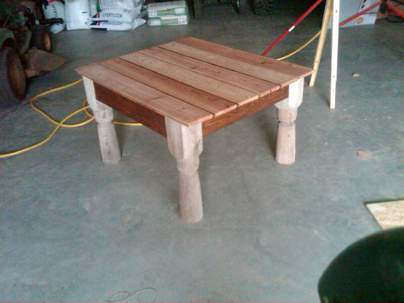

Before harvest started I finished putting the osb up and had a couple of hours free time, looked over and saw some scrap wood and thru this coffee table together, it will be October before I can get back to it to finish:D
