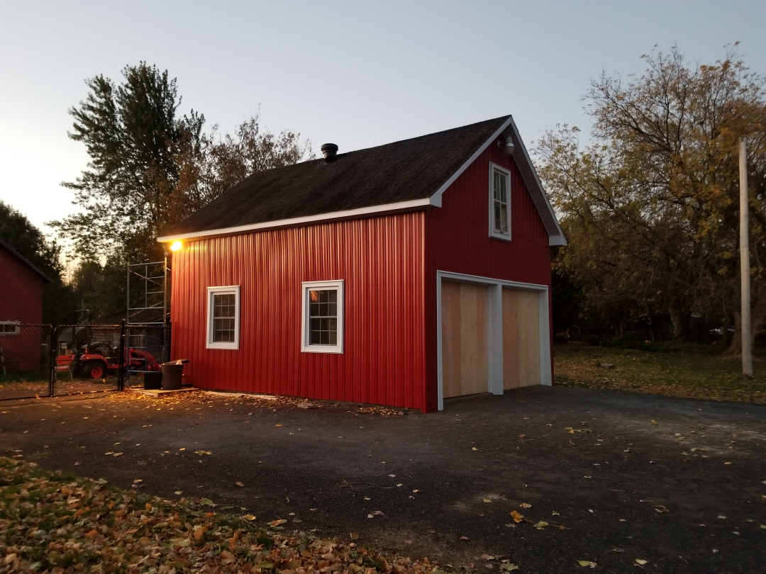

Not "dusting" - stone dust, as in crushed limestone, sometimes called "screening".
Get to know your local excavation guy/dump truck guy/gal. I did my driveway myself, removing 8" of topsoil. I asked the excavator about material and he said that he was contracted to haul asphalt from a local highway resurfacing job. I paid him like $100 a load. I leveled and flattened it myself, simply running back and forth over it with the filled tires of my B7500. I then finished it off with said stone dust (2 loads I believe). The only downside, and it could be a significant one for you - the small stones stick to your shoes.
Sorry for slightly veering off topic - but I wanted to clarify.
