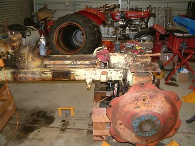

I just finished cutting the heads off the 5/8"x3.5" fine thread bolts that held the outer rims of the rear wheels onto the 1951 Minneapolis Moline BF tractor that I'm restoring. No way those rusted old things were coming apart normally.
I'll replace these with $1.50 5/8" coarse thread bolts and split ring lock washers. Won't lose any sleep over any differences in torque levels betwen the two types of threads since the BF will be a parade tractor.

Lotsa guys with 6 loop rims have went to coarse thread stuff with no los of sleep..

Save yourself a few cents and skip the lock washers. There is more rim-to-disc hardware out there without LW's than with. Hardware installed and torqued properly doesn't need lock washers. Ever see a cylinder head bolt or main bearing cap bolt with one?
