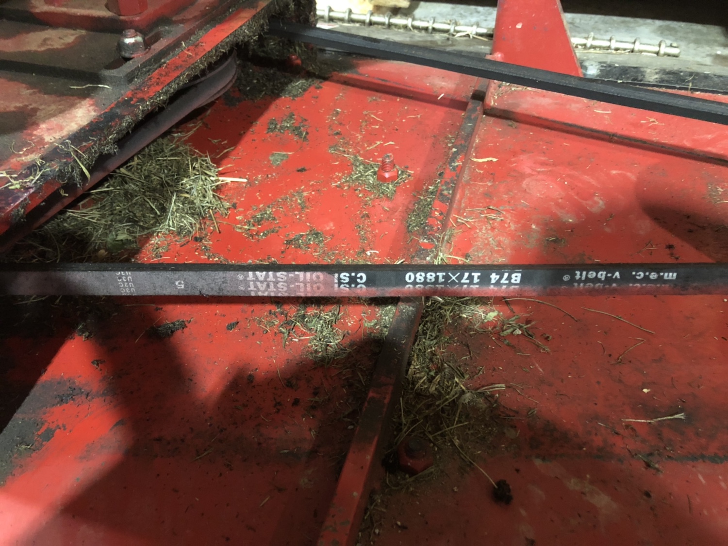

I’m trying to find a replacement belt for my finish mower. It is an Edge Attachments MR-180 which is a rebadged Major Equipment model. Anyway the number on the belt is in the picture below. I’m having a hard time finding this belt and I’m not sure if I’m searching incorrectly or what but I was hoping someone had some insight. Thanks.
   / Finish Mower Belt
It says it is 5/8”x77”. Is the 77” the diameter or end to end length if you cut it and payed it out? I’m not very familiar with how belts are denoted.
   / Finish Mower Belt #5
On a 5/8” belt the inside length is most likely 74” and 77 indicates the outside length.
   / Finish Mower Belt
Ok so 77 would be the outside circumference. That sounds very close
   / Finish Mower Belt #7
Yeah a BX74 shows to 77.6 oc or outside circumference and maximum width as 21/32 or .6562 inches
   / Finish Mower Belt
Thanks everyone!
