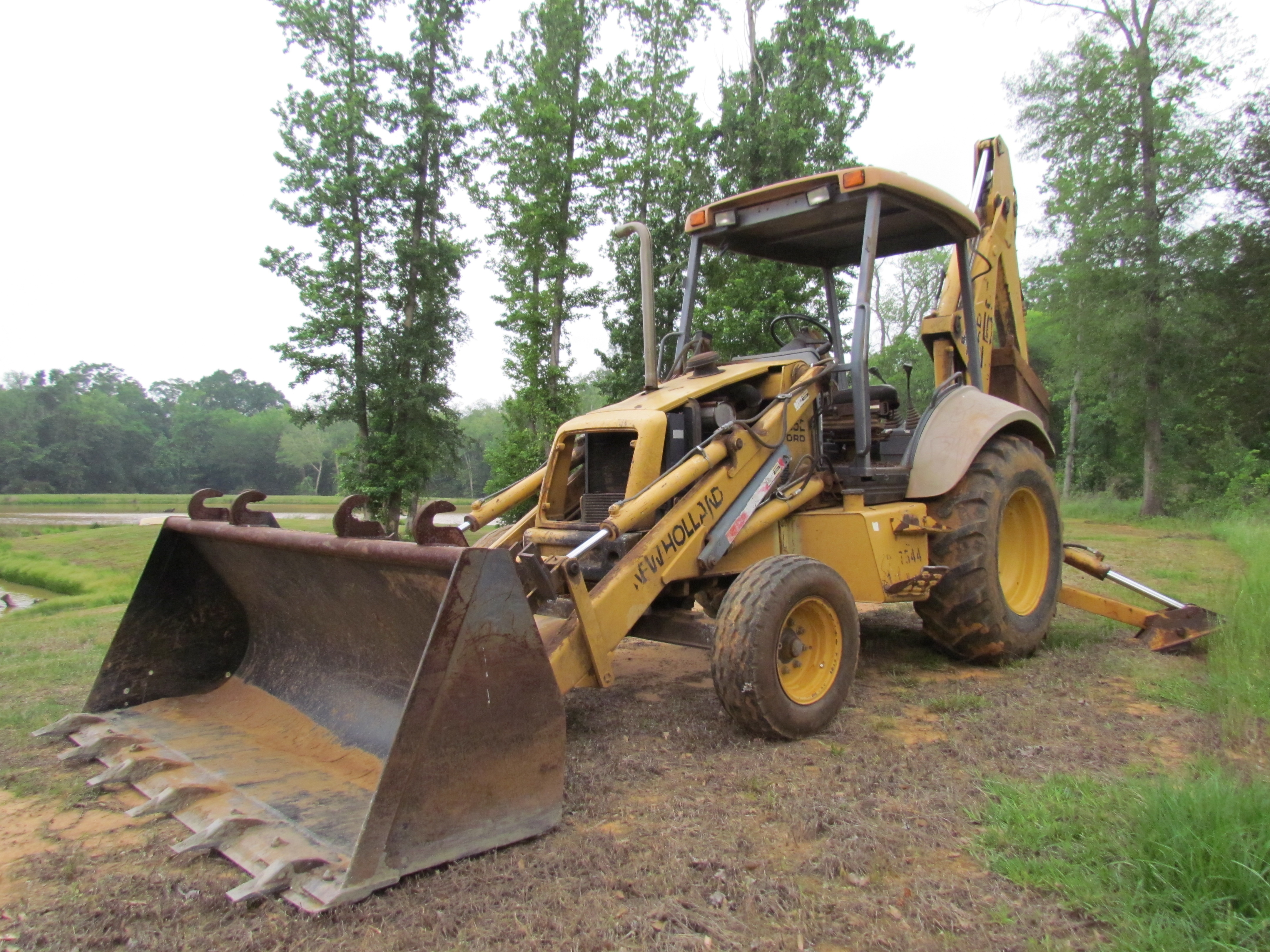

My Backhoe needs and engine rebuild

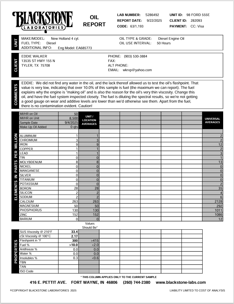

The Oil Report is in from Blackstone. This is what the "Comments" say
EDDIE: We did not find any water in the oil, and the lack thereof allowed us to test the oil's flashpoint. That value is very low, indicating that over 10.0% of this sample is fuel (the maximum we can report). The fuel explains why the engine is "making oil" and is also the reason for the oil's very thin viscosity. Change this oil, and have the fuel system inspected closely. The fuel is diluting the spectral results, so we're not getting a good gauge on wear and additive levels are lower than we'd otherwise see them. Apart from the fuel, there is no contamination evident. Caution!
I really don't know what the rest of it is saying, but for me the main thing is that my issue is the Fuel Injector Pump and I'm lucky to have stopped running it when I did.

I was wondering how you were progressing with the oil sample. Thanks for the update.
Are you going to have the fuel injector pump re-built, or just replaced ?
