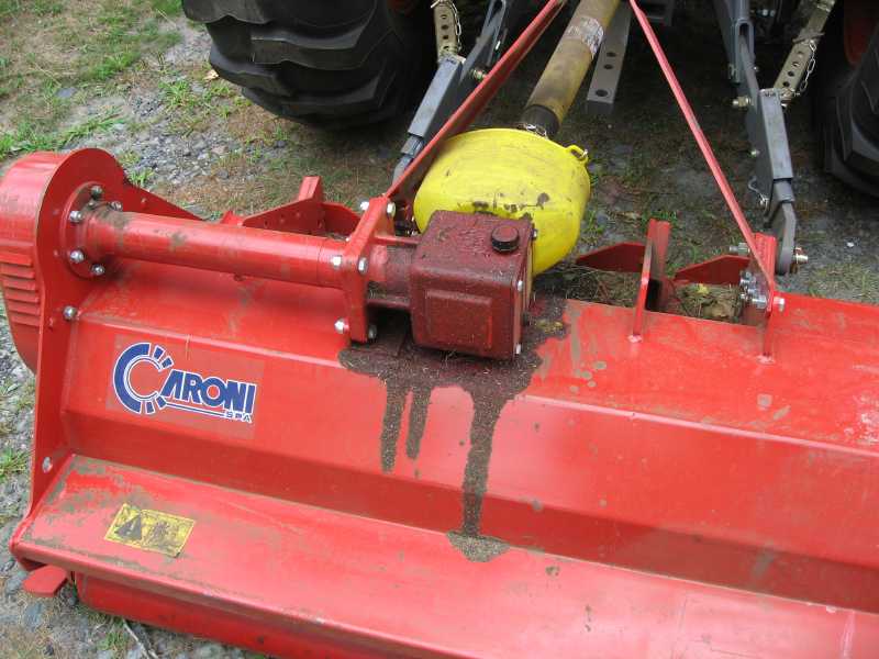

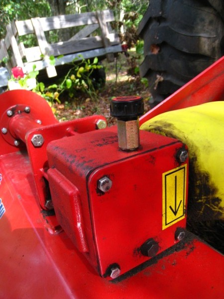

All of the Caroni flail mowers seem to puke out oil from the breather cap. Basically it looks like the factory dipstick is just calibrated wrong so it encourages people to put in too much oil and the gears just fling it up against the breather cap once the oil warms up. It stops leaking when the dipstick shows minimally acceptable oil level. I wonder if too much oil could be part of the OP's problem.
I put in a two inch stand off on mine which works fine but I think just keeping a lower oil level would work just as well.

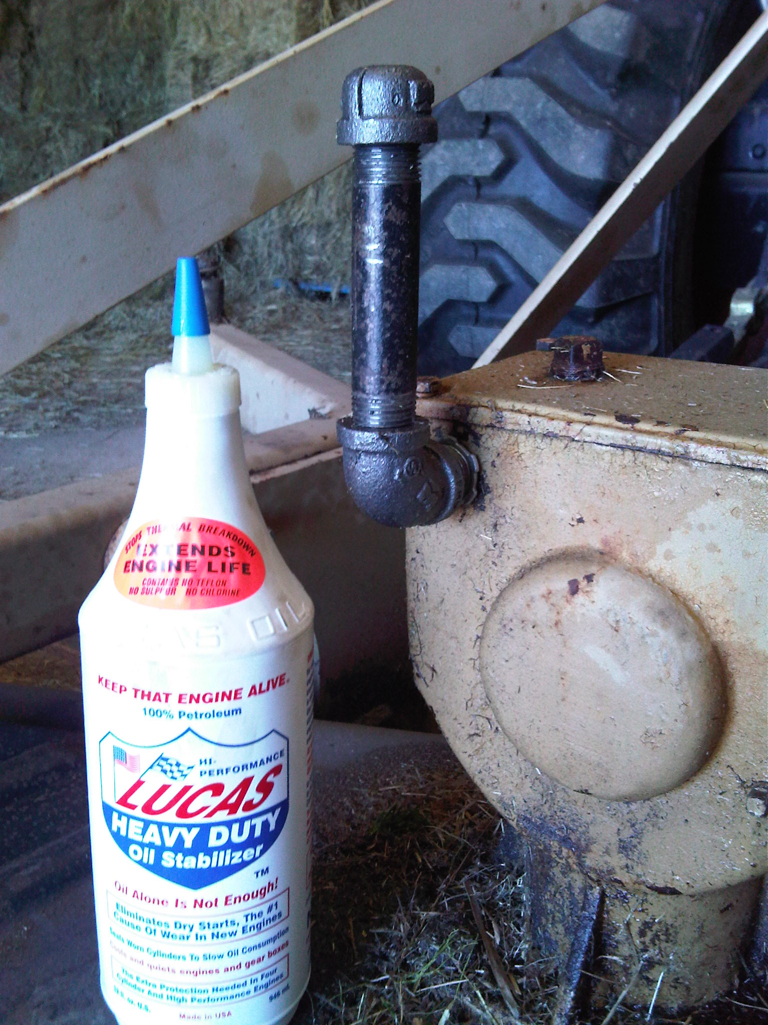

First of all thanks for the help.
Here is my solution for the benefit of the helpers and also the future "searchers"
First I tried to order the vent plug but a solid plug was shipped. I was not comfortable with that so I started with possible solutions:
1. built the stand off that soundguy and island tractor talked about--still foams out
2. drained the gear oil by picking it up with the FEL and refilled with 80w-90 valvoline--still foams out
3. added some seam foam thinking perhaps it was residual water--still foams out
4. drained again and refilled with chevron 85-140--still foams out
5. drained a few ounces and put in some lucas heavy duty oil stabilizer (that is some thick stuff) it foams up into the stand off but never came out. finally problem solved! I mowed for about 20 minutes and no problems. If it foams next summer in the heat will probably use some more lucas. I still don稚 know why it foams so badly but this seems to have solved the problem
Now it is time to clean off all the oil that has leaked and get some touch up paint.
Thanks again for the help
