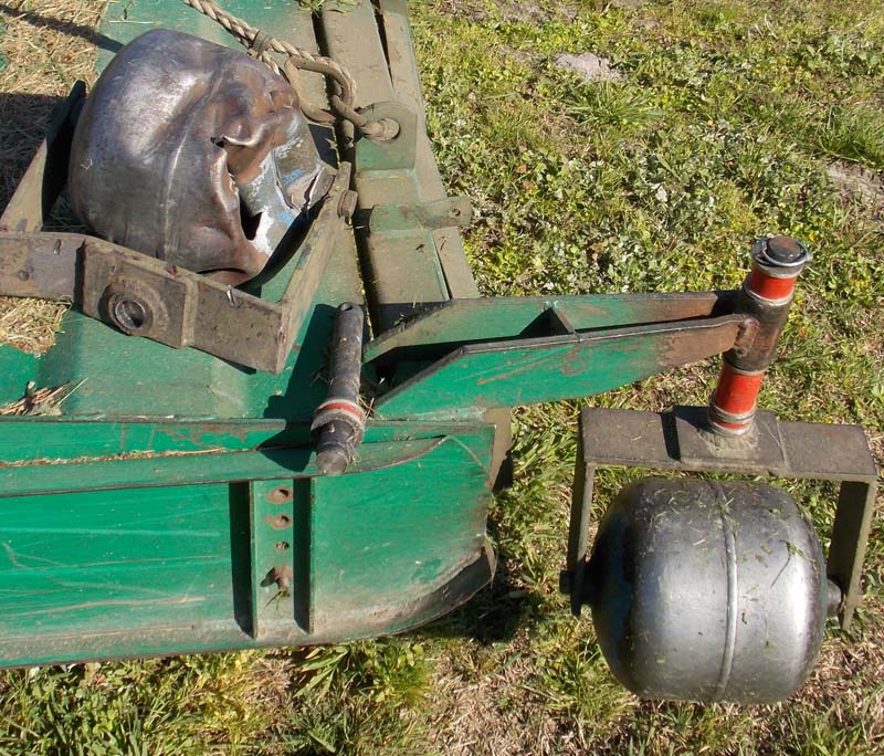

I have steel wheels I made from small propane tanks.
BUT, as you can see on the top left of the attached photo, I still got a flat.
Well, sort of a crumple.
