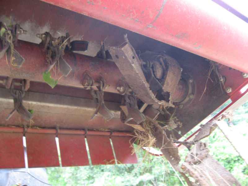

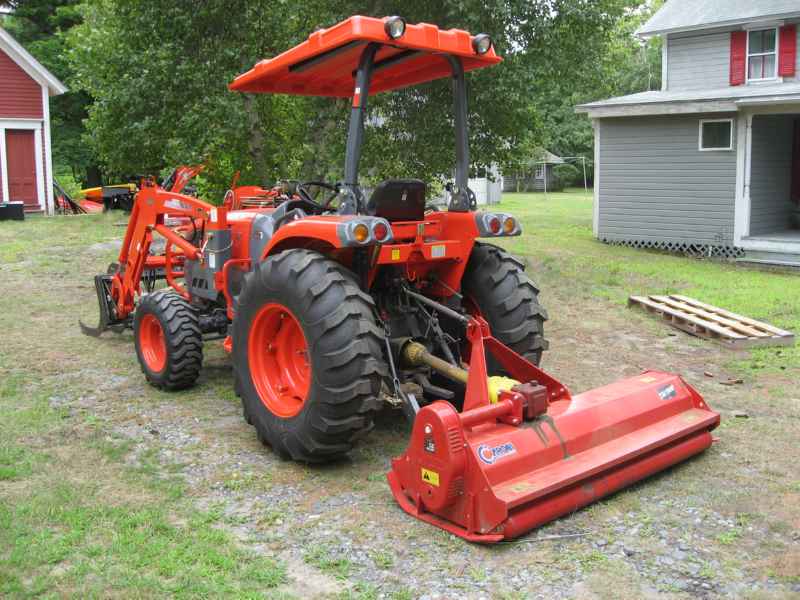

Having said this, I am now converted to flail mowers. They cut like a finish mower but are just about as tough as a bush hog and are much shorter than rear mowers so are more manuverable. I have the Caroni TM1900 on a DK40se and that one is too big for the CK20 but the TL1500 would be a nice match for the CK20. I think a CK30 would run a TM1900 like I have very well. Might be slower in bush hog mode but would do just fine as a finish mower. Quieter than even a finish mower too.
Third photo shows big chunk of metal debris wrapped around mower...took a few minutes to peel if off and then kept on mowing. No damage.

I expected to see a lot more flails/hammers/teeth on the flail mower. Since they appear to cut more vertically is the finish flat or all jagged looking?
How do you control the mowing height without any wheels? Drag it along or just modulate the 3ph alot?

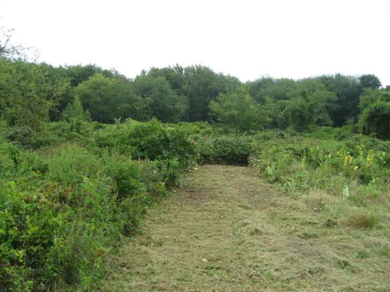

The TM version has fewer and bigger flails. The TL is more the finish mower and had double the number. The cut looks pretty flat to me. I have been mostly cutting in brush so far so don't have that much experience with a lawn but the finish with the mower is way closer to the finish type mower than to a bush hog. It mulches sticks to pulp rather than leaving big chunks the way a bush hog does.
I have been modulating height with the 3pt but you can also lower the set of skids/skis on the side of the mower.

I'm not sure there would be any benefit. The flail is short enough that you don't get the "lever" effect you see with the much longer finish and bush hog mowers extending off the back of the tractor. I haven't experimented yet with the skids but I think the idea is to set the skids so they are not quite touching the ground and then mow by lifting the mower just slightly. The skids would then prevent any scalping. There is a big roller at the rear of the mower that essentially serves that purpose anyway so I don't know if the skids have any real critical role. The brochure from Caroni makes it sound like they are optional even though the mower comes with the skids standard.
