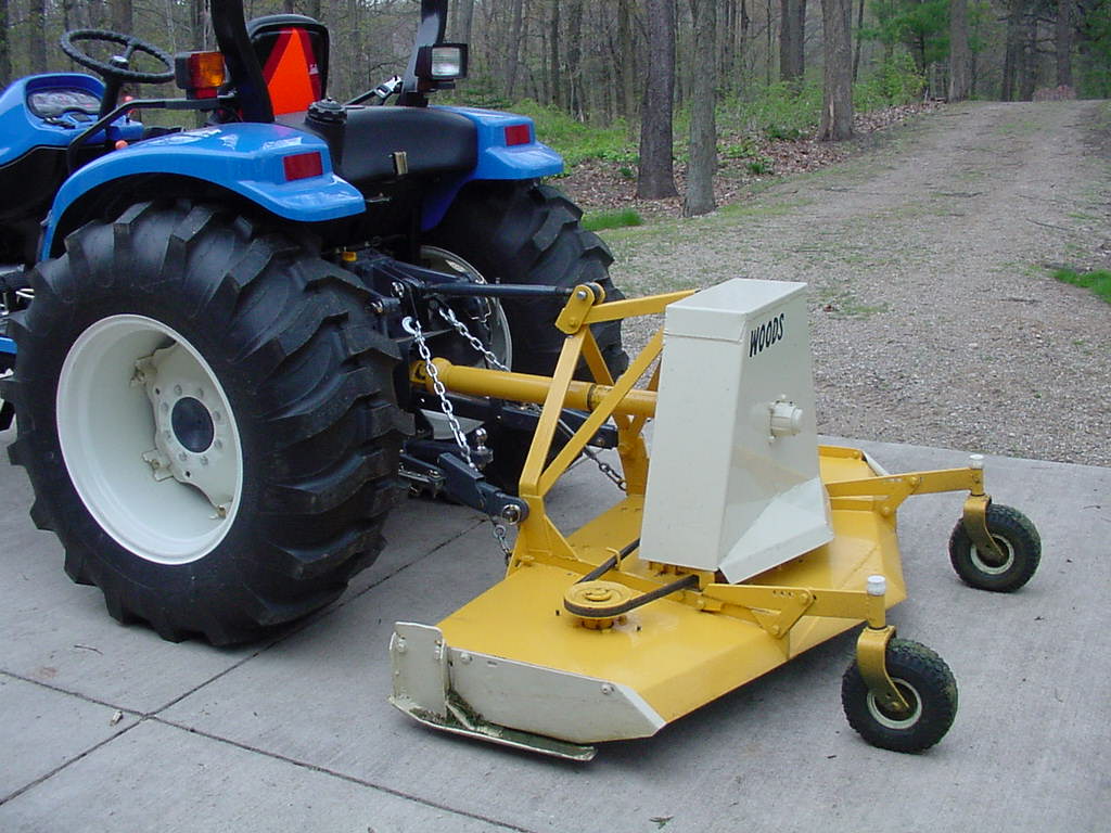

Gary, it's probably too late for your mower, but others should take a look at another way of supporting the front of the mower. "Check chains" offer many distinct advantages such as a smoother ride for the mower, level mowing, and no need for front wheels. A flexible top link is required, but most mowers come that way nowadays. Take a look at the attachment and see if it works for you.
