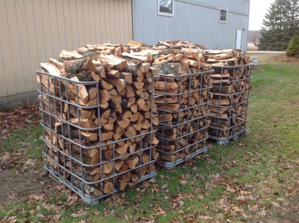

Nice. I'm going to start working on 2018/2019 season soon as the snow stops. I use a similar plan on the baskets but they are those 275 gallon oil tank cages that I got for free from a friend. They are already pallets I just cut down the fronts for easy access and fill them up. They stack too.
   / Finished up my firewood for 2020-21 #7
They hold about a quarter cord.
