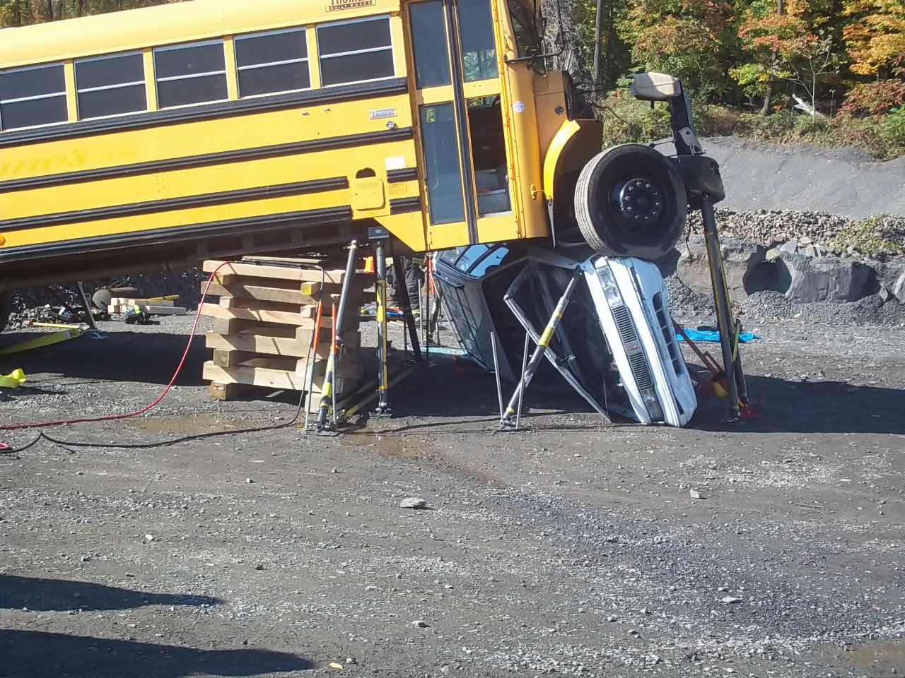

We did some training like that last fall, but instead of lifting parts of a tractor, we lifted a school bus off a car:
