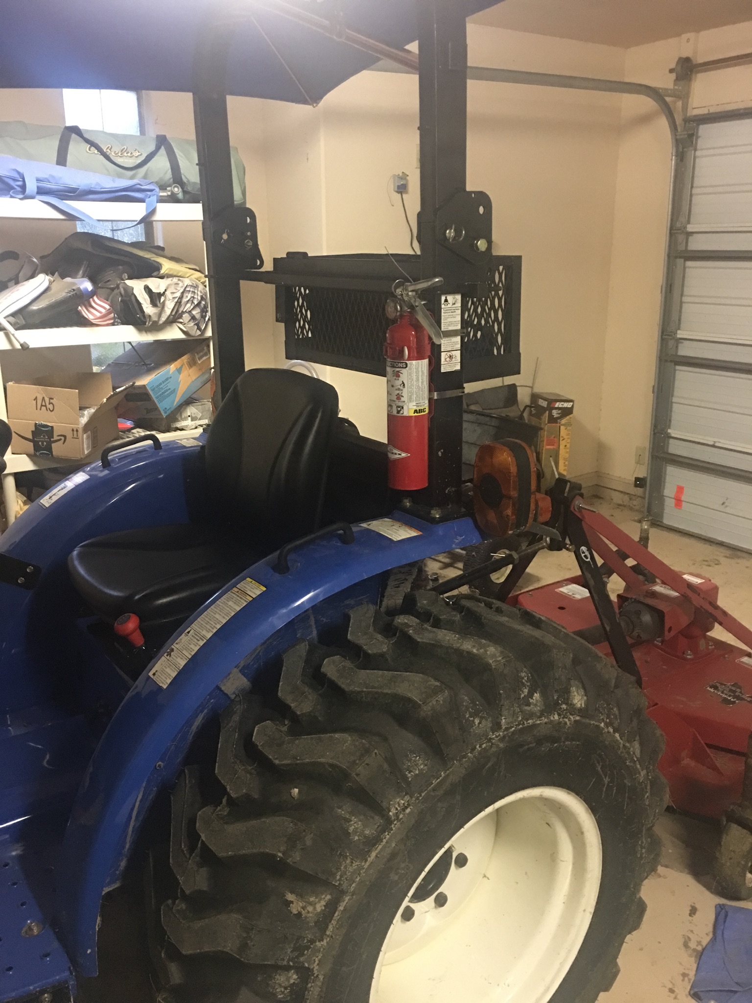

I owned a NH TC24D for 13 years until I recently traded it in for a 2017 NH Workmaster 33. The Workmaster has a regen every 5 hours or so. I got concerned with the increased exhaust temps, especially when bush hogging way back in the back of my property where I could expect no help and the grass and weeds were always 18 or taller, much taller. So I decided to add a fire extinguisher to the new tractor. Nothing new here, but maybe I will save someone some research time. The pics show an Amerex 2.5 lb abc with the metal mount. I installed it on my 2 x 3 ROPS with two 3.5 stainless hose clamps.

ABC will do good for something on the tractor but won’t do much for a grass fire. Carry a shovel or other digging/scraping tool and check out the Indian Backpack Pumps. A little water will go a long way.

Just remember. You need to be able to direct the extinguisher at the source of the fire. THAT, may not be achieavable given the design of much modern equipment.
A friend set fire to a tractor while doing a welding repair. It had a plastic fuel line with a top mounted gravity fed tank. A really, really bad situation!

There are a lot of welding fire stories out there. Have several FE in the garage. I was wondering if the 2.5 Lb is big enough, especially for a fuel fire.

Having fire fighting equipment at hand is one thing, but a having a spotter is just as important. A welder, burned down a whole (newly rennovated) ice cream factory near here some years back!
I have seen too many welders that think it's funny when people get excited about sparks and a "little" fire.
But back to the topic. To me, it's more important to consider before hand, where a fire is likely to break out and how to get at it, than where to mount your extinguisher.

You all give some thought to the handles on those extinguishers. Tree limbs and loose clothing can be a issue. Tree limbs also can pull that safety pin right out. Guess it depends on your mowing conditions, but it’s something to keep in mind.
