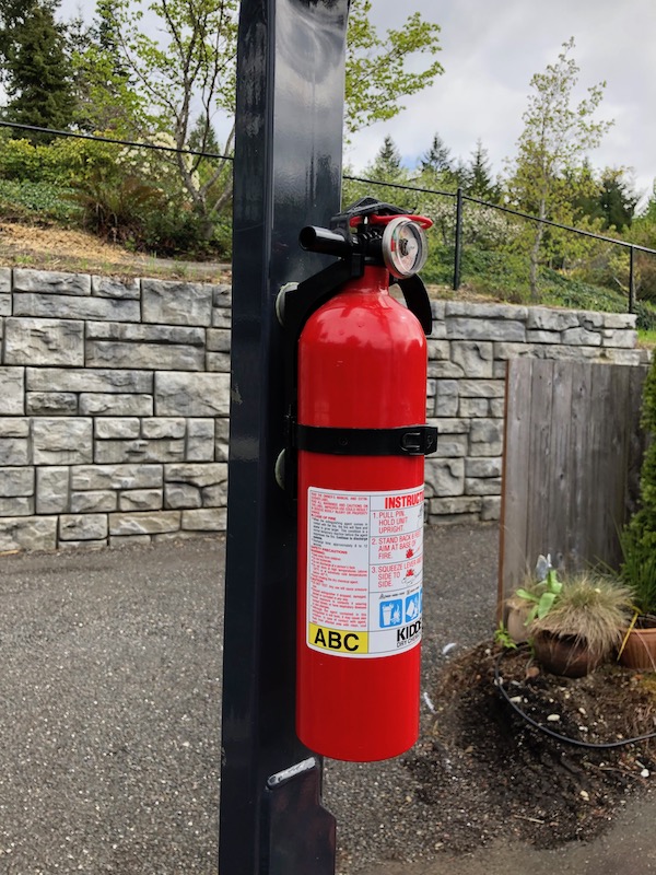

   / Fire Extinguisher (I think I was lucky) #14
Always a good idea to have a fire extinguisher on board and around the shop. Oh, one in the kitchen too! Here is how I mounted a small one to my ROPS on my BX.
Mounting a Fire Extinguisher on a BX ROPS - YouTube
