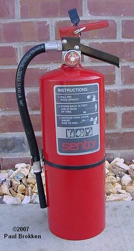

Yep. It took me a while to get the message, but my friend will not even touch an extinguisher with a plastic valve.
It is worth the extra money to get a "Real" extinguisher with a metal valve, because: 1. The gas will not leak out of it. 2. If you use it, you can get it refilled.
I have a question Bigfoot, how do you get the gas in the extinguisher? I once tried to blow air backwards into one that the gas leaked out of, and it would not go in. :confused:
Ray, The fire extinguisher techs have an adapter, specific to the make and model, that will screw in the valve where the hose goes. It is then charged with a regulated supply of nitrogen.
You do not want to charge a dry chemical extinguisher with air:
1. Air contains moisture. (nitrogen is dry)
2. Air contains oxygen. (I don't have to explain what happens when you blow on a fire with oxygen, do I?) :D
I had no intention of using the fire extinguisher, I was only experimenting with a unit before discarding it.
It was clear that they had to have a way to attach it to the, what is it N2 bottle?
I was surprised that I could not hold the valve open, and blow pressure back into the bottle, which made me wonder how it worked.
