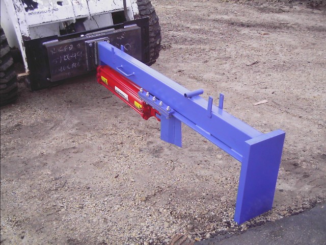

No, I was not trying to embarrass anyone, but to show that the cylinder chosen is not a good choice. A 2 in shaft has much better advantage if you have any potential bending forces. I had to calculate back-wards to find the shaft size, because it was not stated. I used trial and error. You could even use the same cylinder bore and change out the shaft and still have the same push force. The difference would show up in the return stroke. You might get by with that same cylinder for a while, but one day it will come into that big knot, and bend the shaft.
As an illustration your diagram is fine. It looks similar to this commercial model.
Pictures are for reference only.

I looked at those units at NH. I don't care much for the design. They had the Powerhorse splitters on display alongside this machine, which made them look like toys. As to their functions, there is no auto return valve, so you have to place logs from both ends of the machine, or run the wedge back manually. They only handle 19" logs, which may be all you need, but the majority of splitters seemed to be designed for something a little bigger.
You would hook the unit up to the PTO QDs. You probably would not have to run the PT at full throttle.
A nice simple concept. Thanks for sharing.

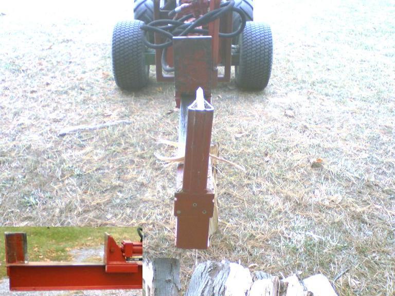

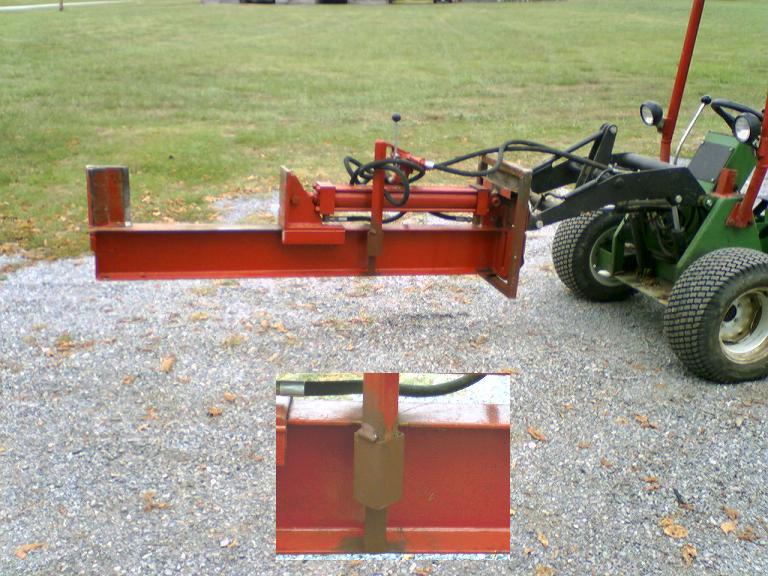

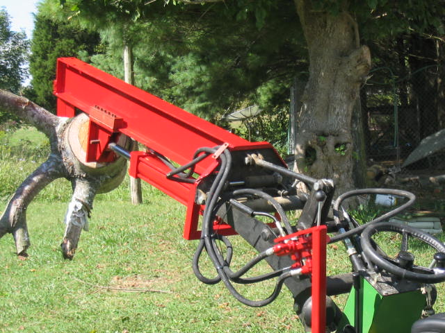

Yes when I first built the upside down splitter it didn稚 take long to see that it was only handy on splitting and moving the large cuts. That痴 when the upright feature was added. Still haven稚 fixed the frame where I bent it but by not treating it so rough it hasn稚 gotten any worse. It is on my to do list though.
I can't turn mine side ways. Never thought about that when building it. But so far we have been able to make do without that feature.
