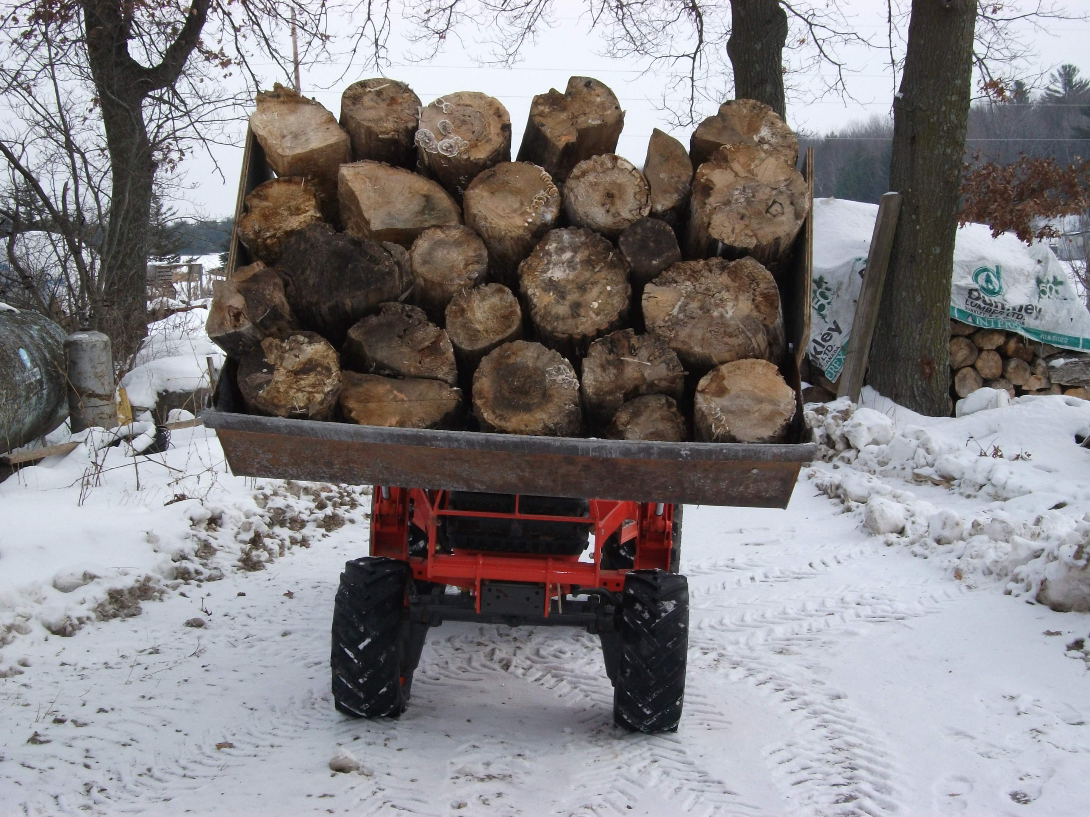

This is what I built out of an abused Kubota bucket. Use it for measuring when loading the trailer for delivery and for hauling in boiler wood for myself.Have often thought about building a trailer that I could grip with my 3PH grapple and pull it out at the end of the day.

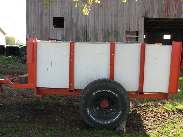

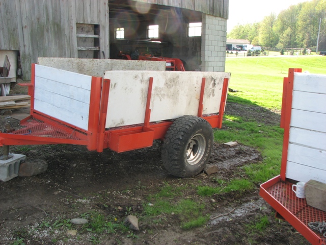

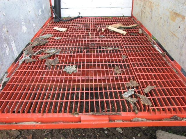

First question is what will you be towing it with??
Judging from your avitar, you have two smaller tractors. SCUT's or CUT's amybe 25-30HP.
I have a L3400 bota and out trailer that hauls a cord is about all the pull it wants if it is even remotely soft/and or hills. And it has 35 x 12.5 truck tires to make it float and roll easier.
We only have hardwoods around here and it is about 4000lbs per load green and the trailer itslef is ~2000lbs. I don't think I would want a 2 cord trailer. 10k in weight and not nearly as manuvarable in the sticks.
Plus, to haul 2 cord with a 6' trailer, you would need a 14' trailer (assuming 3' sides). 4' sides would almost be too tall to chuck wood over the side. Also a 2 cord trailer takes twice as lon to load as a 1 cord.
As far as how you build it, it all depends on your skills and resources. Are you going to buy steel? Are you good at welding? Will you use old 3/4 ton axles or buy trailer axles?
The 3 that we have built all have truck axles. (ability to us large/easy rolling tires). There is no suspension to worry about. (Simpiler, cheaper, and keeps it lower for loading).
Here are a few pics. If you want more I'll be happy to post.
