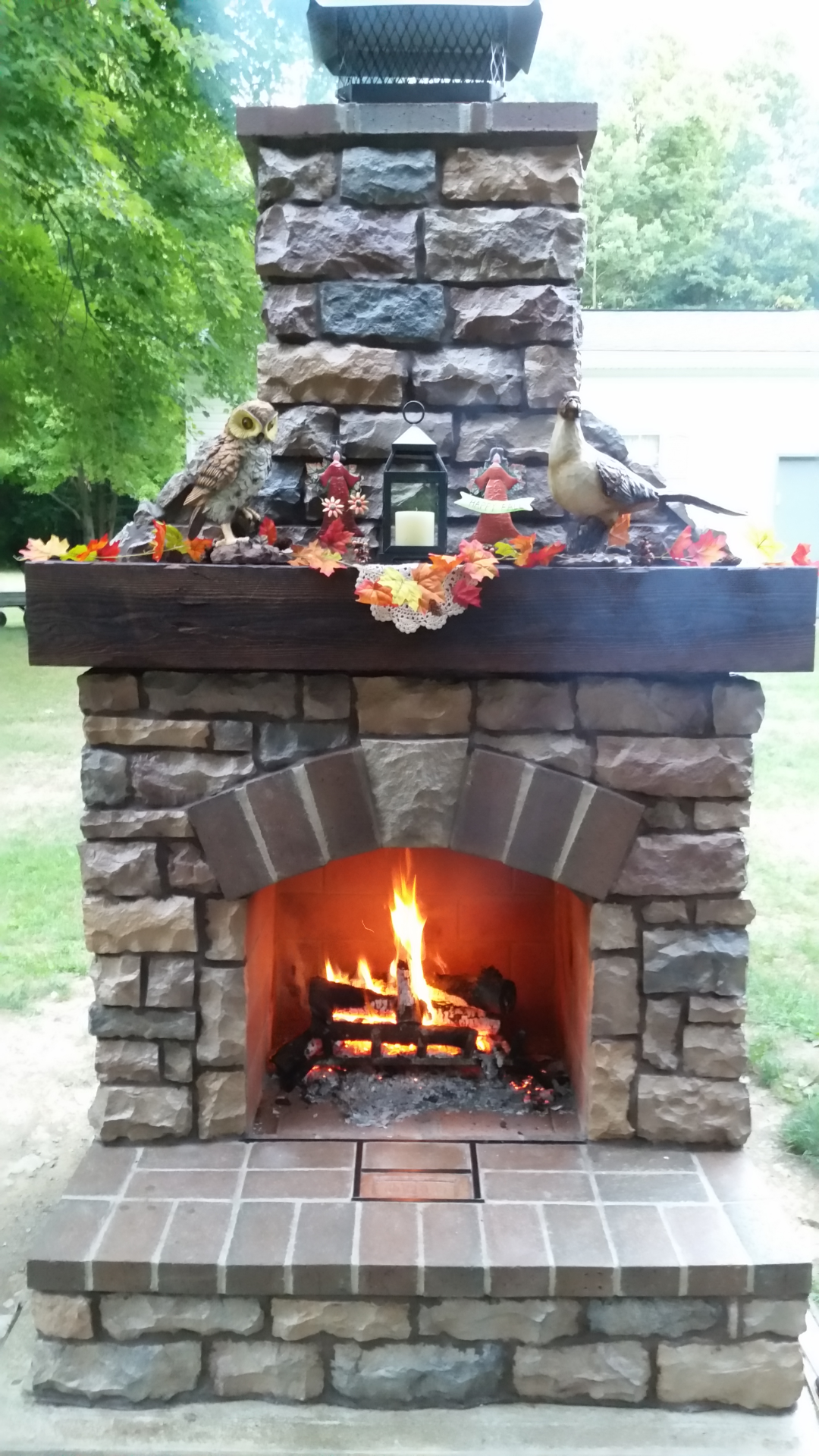

Fireplace added to outdoor patio

Another pic

Very nice. I need to build one of these at my cabin.
   / Fireplace added to outdoor patio #4
You did an awesome job! Looks nicer than the one in my house.:)

Thanks all !
I have an electric smoker already and I have a cooking grate for the fireplace!

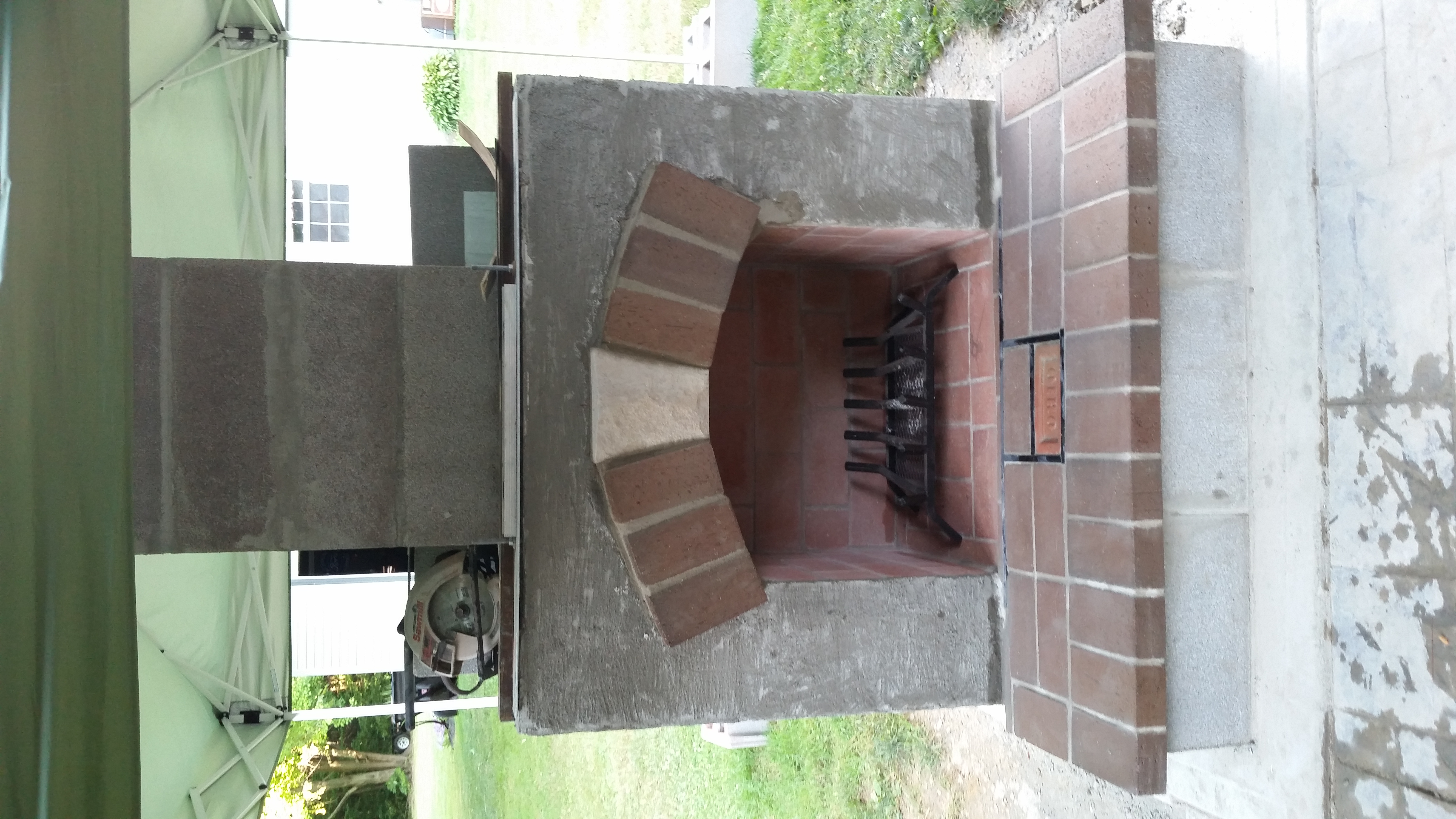

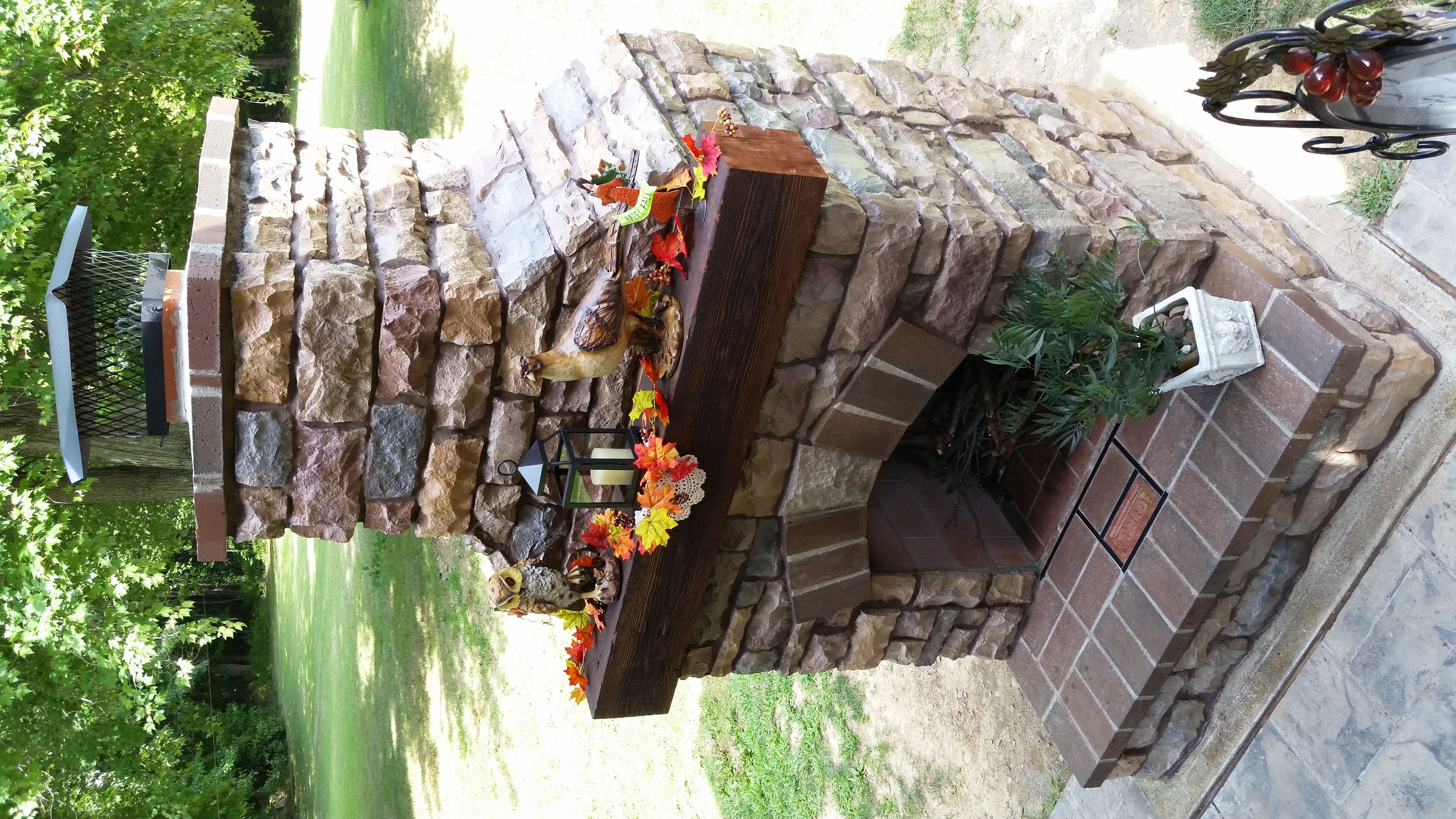

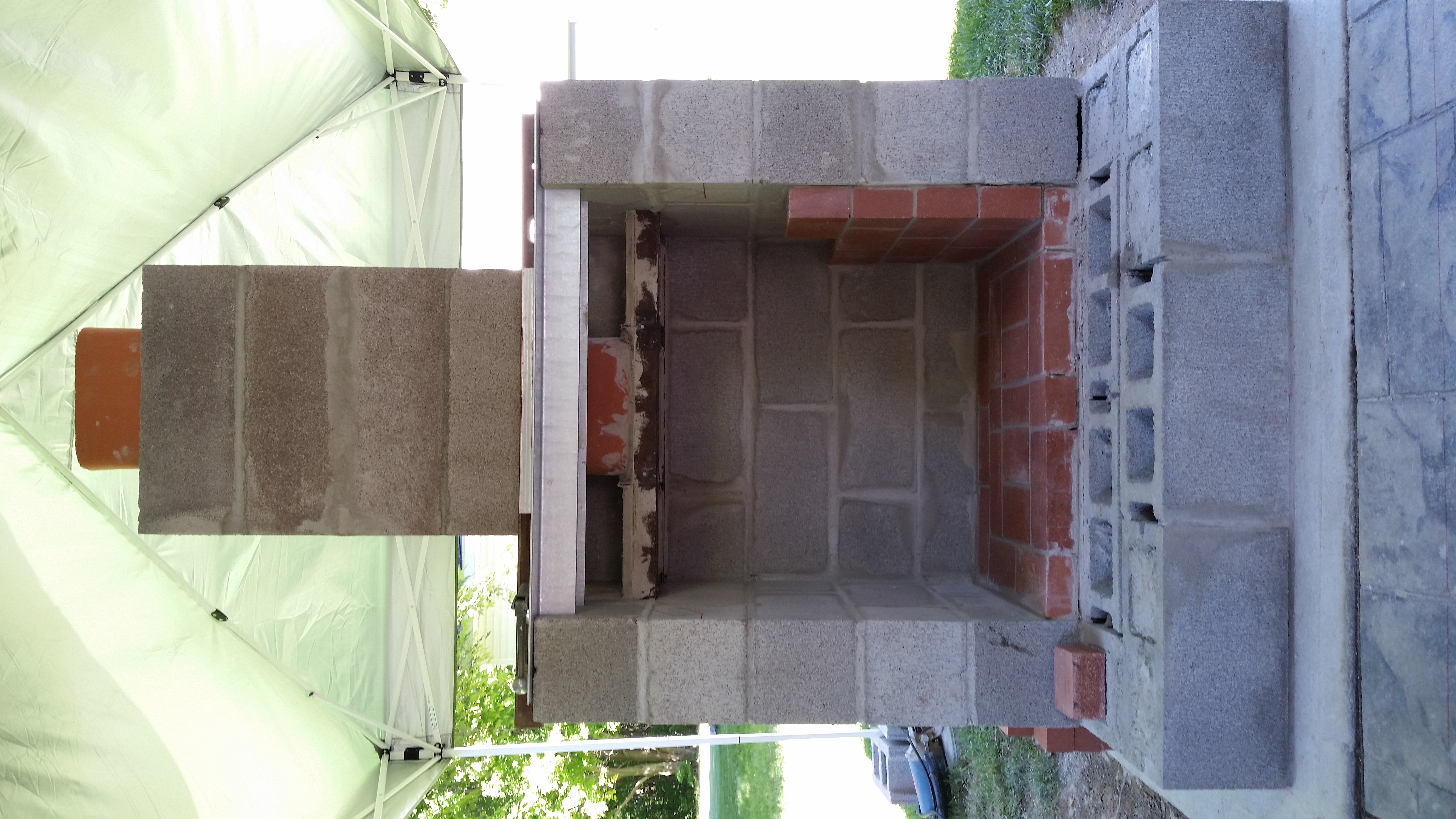

Details man! Is it built from scratch, or did you buy it. I've seen some preformed fireplace fireboxes and chimney throats that you essentially veneer with your stone. I'm looking to incorporate one into our patio remodel. Does yours throw out much heat? It looks somewhat deep, but that might be necessary to keep the wind from scattering your embers.
I have an outdoor fireplace on our back porch, but because of it's location, a stiff gust can pull some of the embers out. Our patio is in a different orientation, so I don't think wind will be an issue with that one.
I built it from scratch. I looked at those kits that you can buy , but I wasn't to impressed with them !
It throws out plenty of heat. I do get some smoke that rolls out the front , I think that is do to the fact that my fire box is a little bigger than it should be.
I built the box large and deep to allow me to cook on a grate !

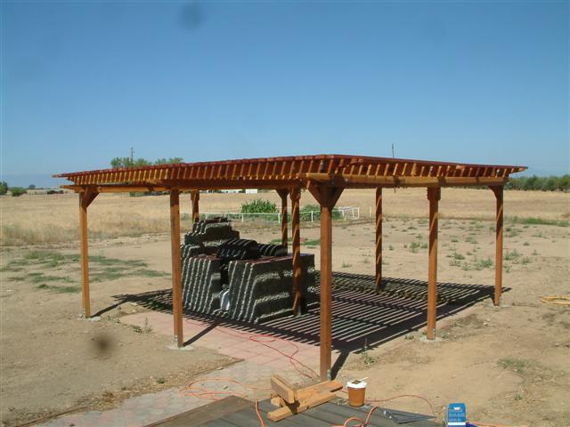

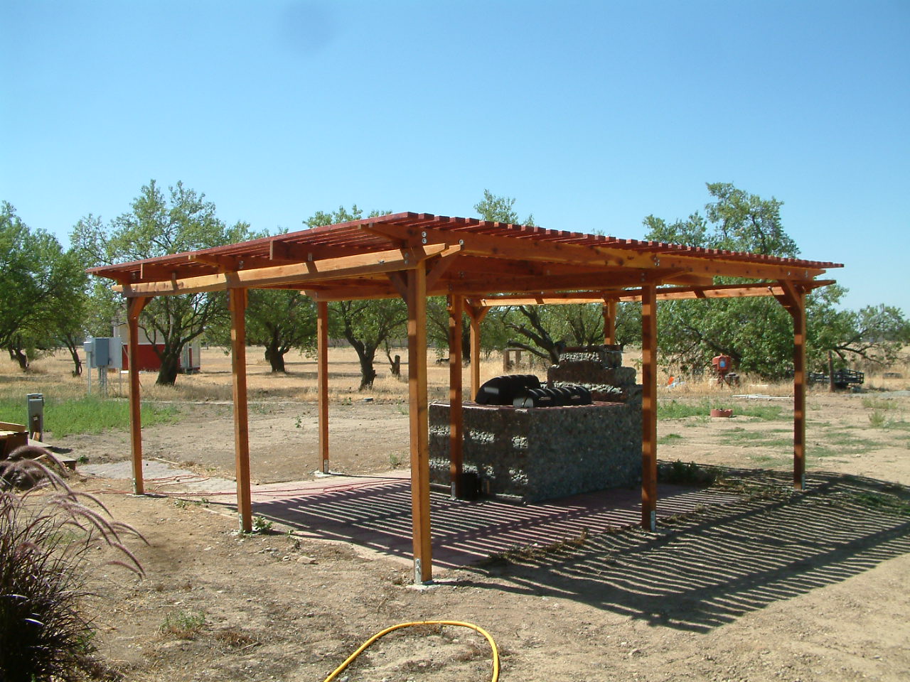

I did something similar about 10 years ago at my ranch North of here in Tehama County--pergola, patio, BBQ combo with gas grill and smoker.
