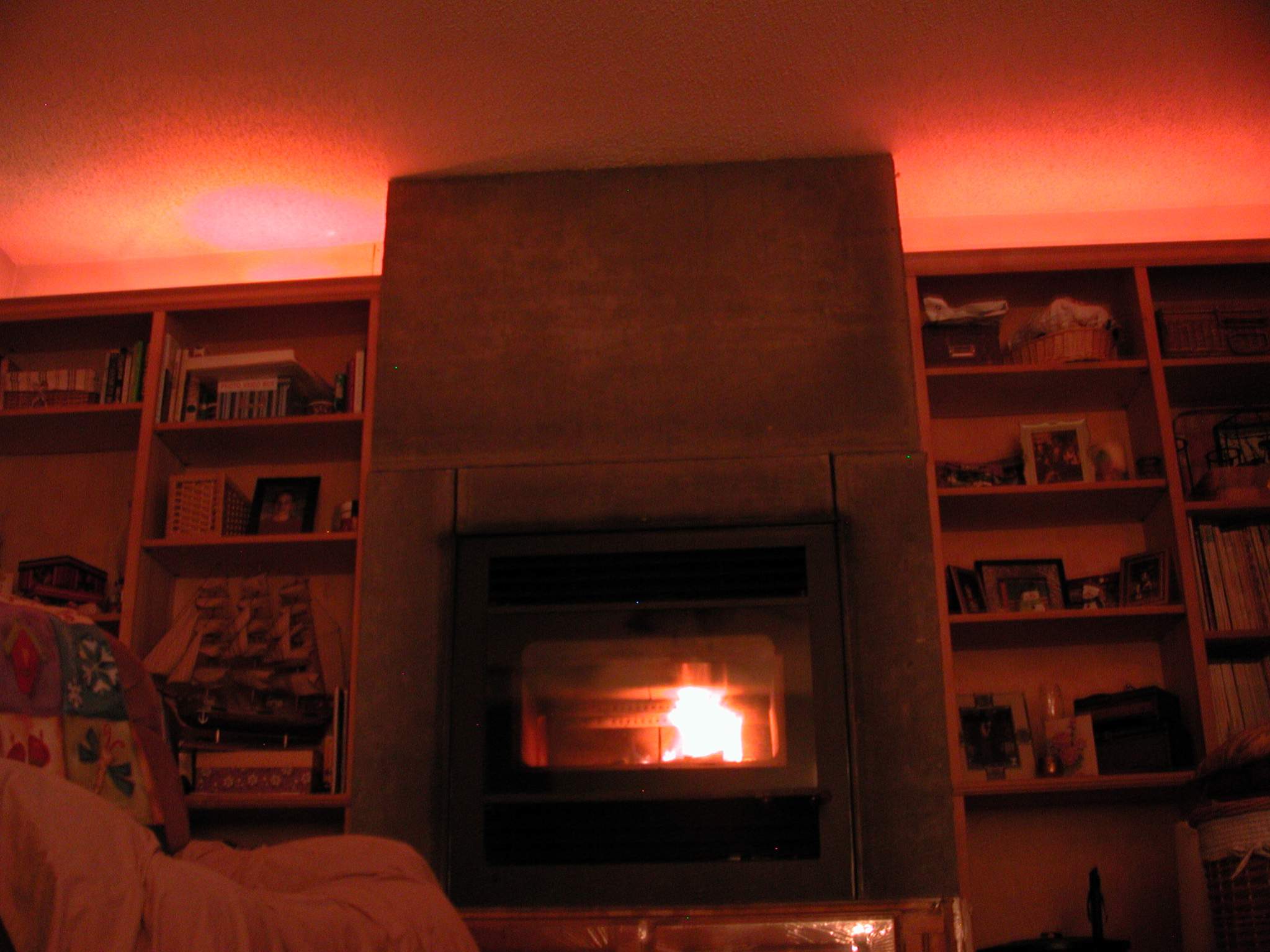

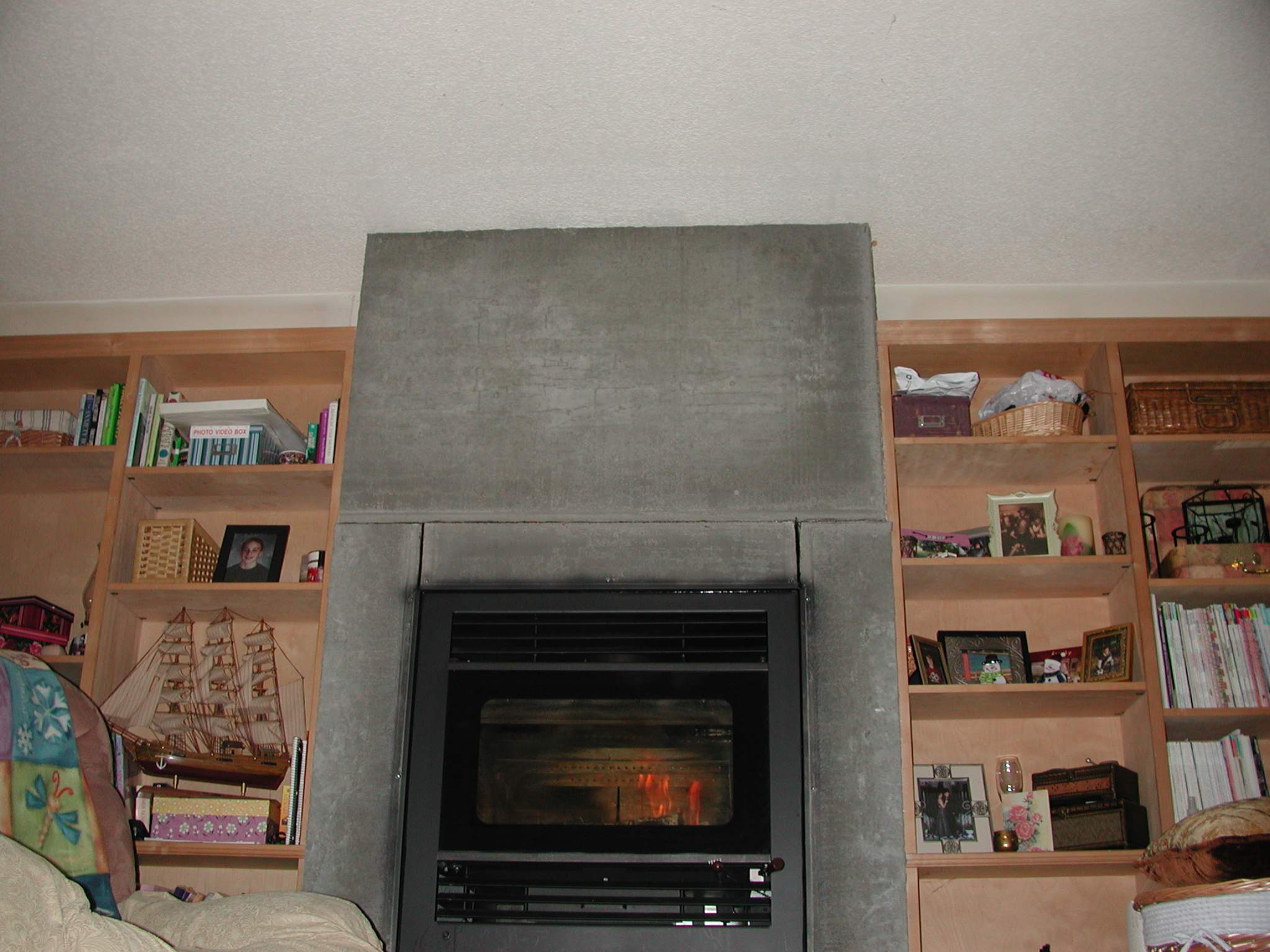

We had the same situation with a pos zero clearance prefab fireplace in our house. I replaced it with a bis nova a few years ago. It is basically a zero clearance wood stove that installs in the wall. It creates great heat! We heat the upstairs with it. You really can't use an insert because you have no firebox. Once that fireplace comes out you are left with a big hole.
