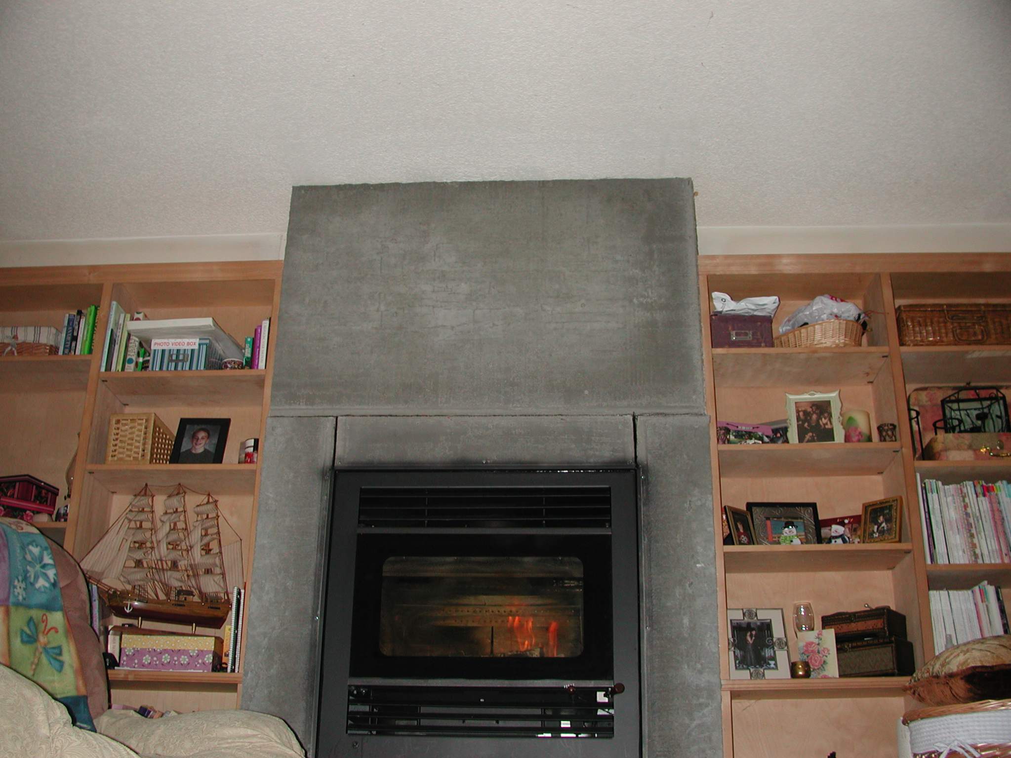

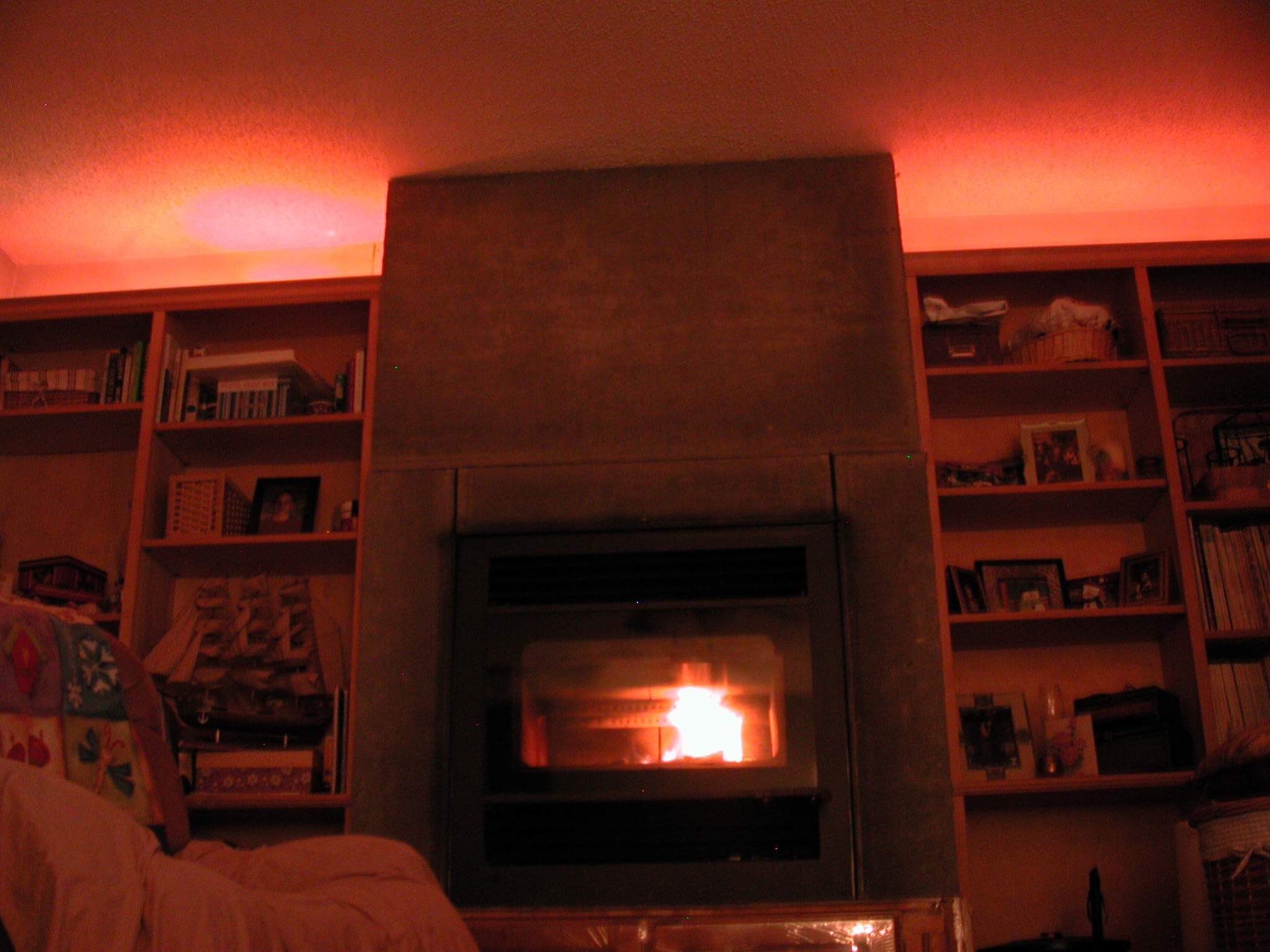

I heve this fireplace (actually, the Onyx-1) and its a Zero-Clearance fireplace (ALL of their fireplaces are zero-clearance http://www.icc-rsf.com/c/iccrsf/file_db/pdfs.pdf_en/Onyx_ang.pdf) that would work perfect in a pre-made fireplace, or even not. Mine is built into an outside wall with nothing but 2x4's and sheetrock around it. It should work great inside a pre-fab. There are blowers, gravity vents, screen door kits, thermostat kits, HVAC kits (hook to existing vents), etc.. Its even gas log caplable :) The 7" Excel stainless insulated ventpipe they use are better than the SuperVents with a higher certification.. Take a look around.
Onyx 2 Fireplace | ICC Chimney - RSF Fireplaces
After first burn and 'cure' - Daytime and night time pics... These were taken after install before finishing.
