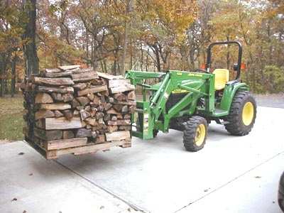

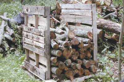

I've been the route of splitting in the woods and hauling it out, restacking to dry, then re-loading to haul to the house for burning.
But now, drag the logs from the woods with 3pt quick hitch, buck to firewood length, then set up the woodsplitter. Stack directly onto pallets, and the wood stays on the pallets until they are set off in the garage 2-3 yrs later for burning. Drape used rubber roofing 5x5 cover's over each pallet to shed water. This works great for split wood, but the tops that are not split go into a "bin" arrangement of three pallets. Have the forks on the 3pt when snowplow is on in place of the FEL.
That's similar to what I do. I usually cut timber to ~7 foot lengths to fit on the trailer, and load and unload those pieces using the carryall. Then I buck, split right there and load onto my 1/2 pallets. The 2x4 sides make it very easy to load and also keep the wood from falling off when I move the racks.
