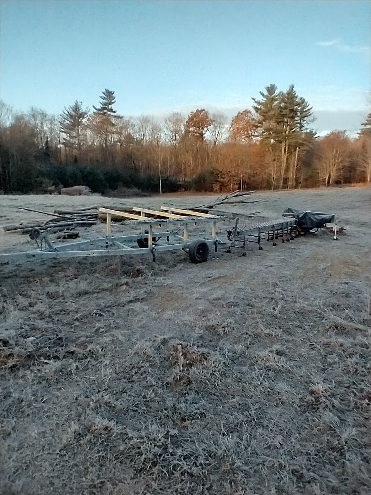

Getting old and moldy but I do enjoy a good warm fire, cheaper than oil too.
Got logs, old splitter, saws, tractor with forks to move IBC totes, grapple to move logs.
Building a cutting table to get the cut pieces to the splitter without breaking the bank or my back.
Wolfe Ridge Mfg. has one for $1,000+
This one does not have a tray to slide the cut pieces to the splitter.

Traded for a sturdy boat trailer this summer, new springs arrived today. Applied Kroil to the retaining bolts.
Waited for Harbor Freight jacks to go on sale got 4 tubular weld, swinging crank jacks.
Also, picked up a accordion roller conveyor and a 10' galvanized roller conveyor.
Have been looking for ideas on log racks, thinking 6' wide x 8-10' to be welded to the boat trailer frame.
Just went through the thread, already modified the woodsplitter with a table, the conveyors can roll the butts
from the cut-off to the splitter, just need the log rack.

Not sure if I get it running this year, still some setup due.
