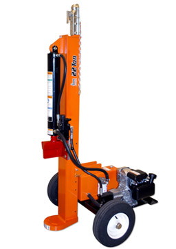

Sawyer Rob and 4570Man do A LOT of firewood so their splitters and needs are a bit above most. Professional really. Some other members do as well. I have a Brave 22 ton now and it does just fine as it would for most people. I do 12 to 15 cord a year for friends and family so a little over average. Beside the big bucks of the Wolfe you are going to have to store it too. This is an advantage of my model (for me) which folds up nicely out of the way. Stock photo.

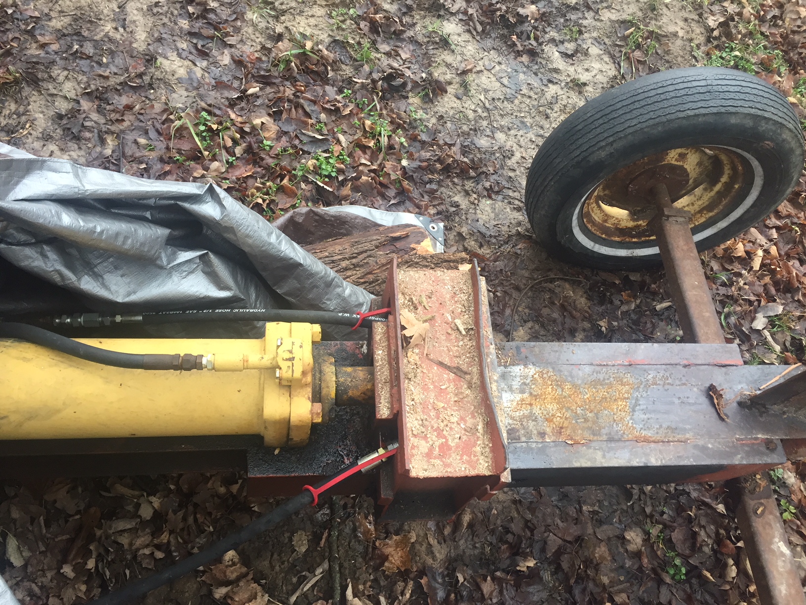

Hoses are 1/2", Stroke is roughly 24", I do not know the diameter of the cylinder. I do have a partial picture if that helps, its massive from what I have seen on other splitters.
That cylinder is far too big for a splitter. Looks to be off a Bulldozer or similar.
Yes it is very strong but will take a long time to send it enough oil to move the piston.
Also it would be designed for much higher pressures that you could ever provide so it is a monster without a true purpose.
