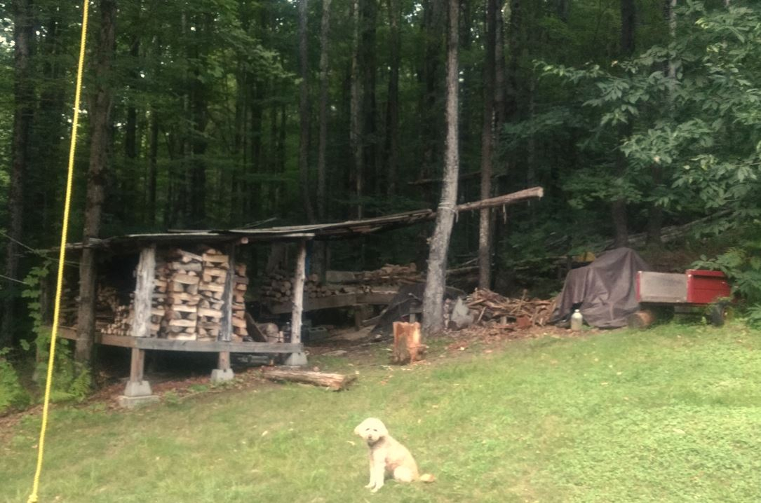

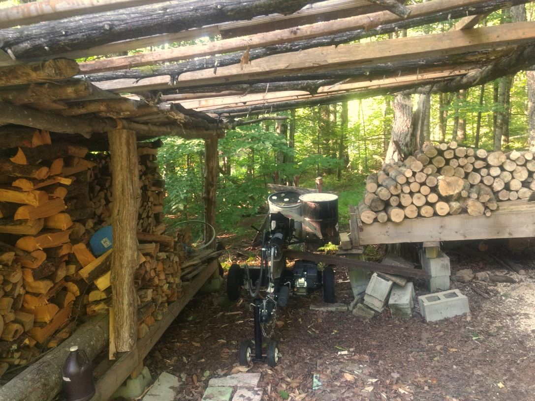

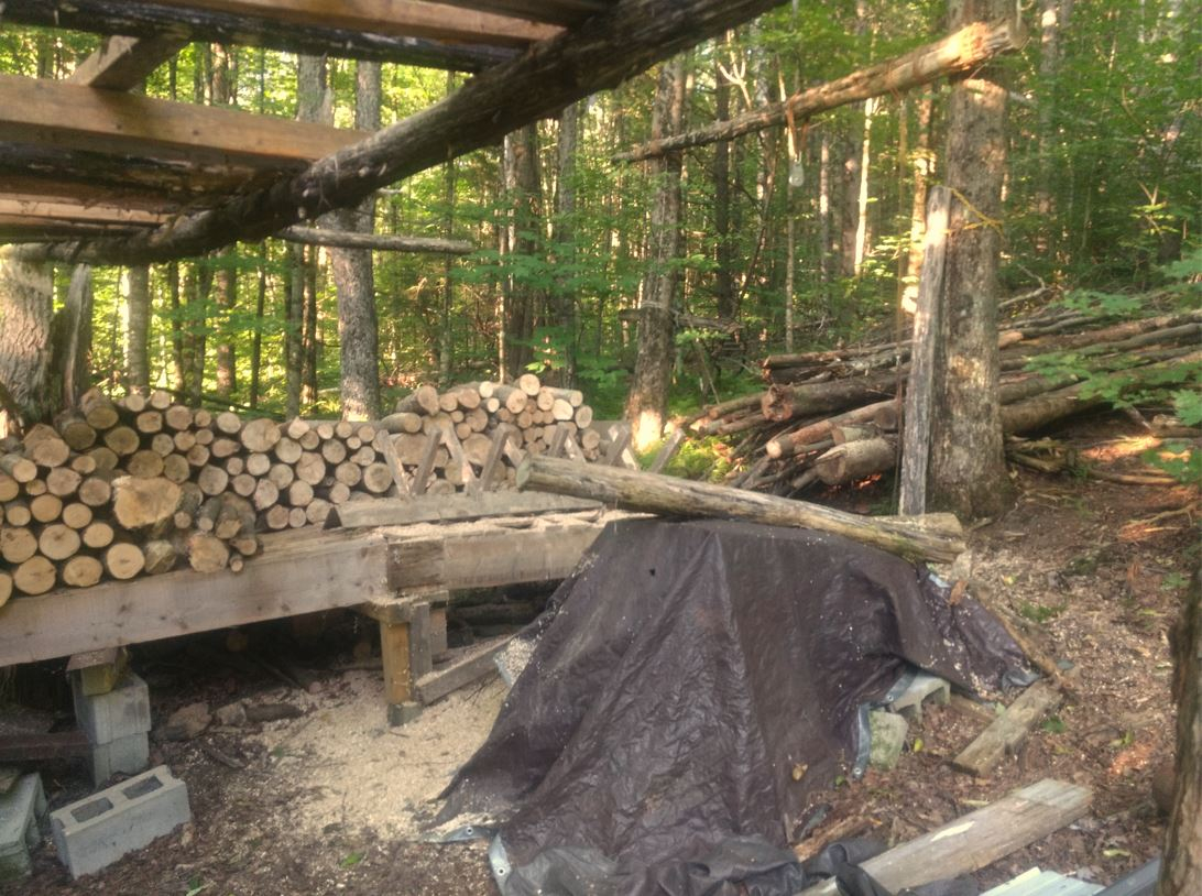

I took the advice of building enough storage to accommodate a current burn season and a seasoning quantity. I now have a platform to season enough wood for a winter plus a little. Not as much fun building that, but yes, necessary. A few weeks ago we had our last snow/wind storm which took the roof off of both platforms so I will need to fix the before proceeding.
Welding of a basic processor frame also started and pretty quickly pointed out my lack of gas welding skills (oxy acetylene), so I "had" to get a stick welder. Not so bad in the garage, under controlled conditions, but outside was humbling. The frame is 2x2 square tubing only b/c I have the tools to work with it. In many places plate would have been better but my saws-all and harbor freight horizontal band saw wouldn't 'cut-it'. :) It is overkill and damn heavy so I picked up a few old all-metal tractor wheels for the eventual move into place.
Unfortunately I have not made any progress on the plumbing. There will be a crash course in valve selection in the next few weeks.
