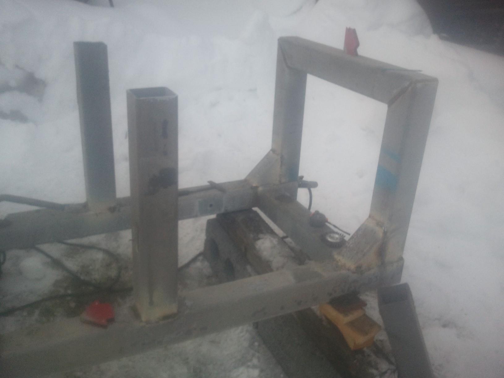

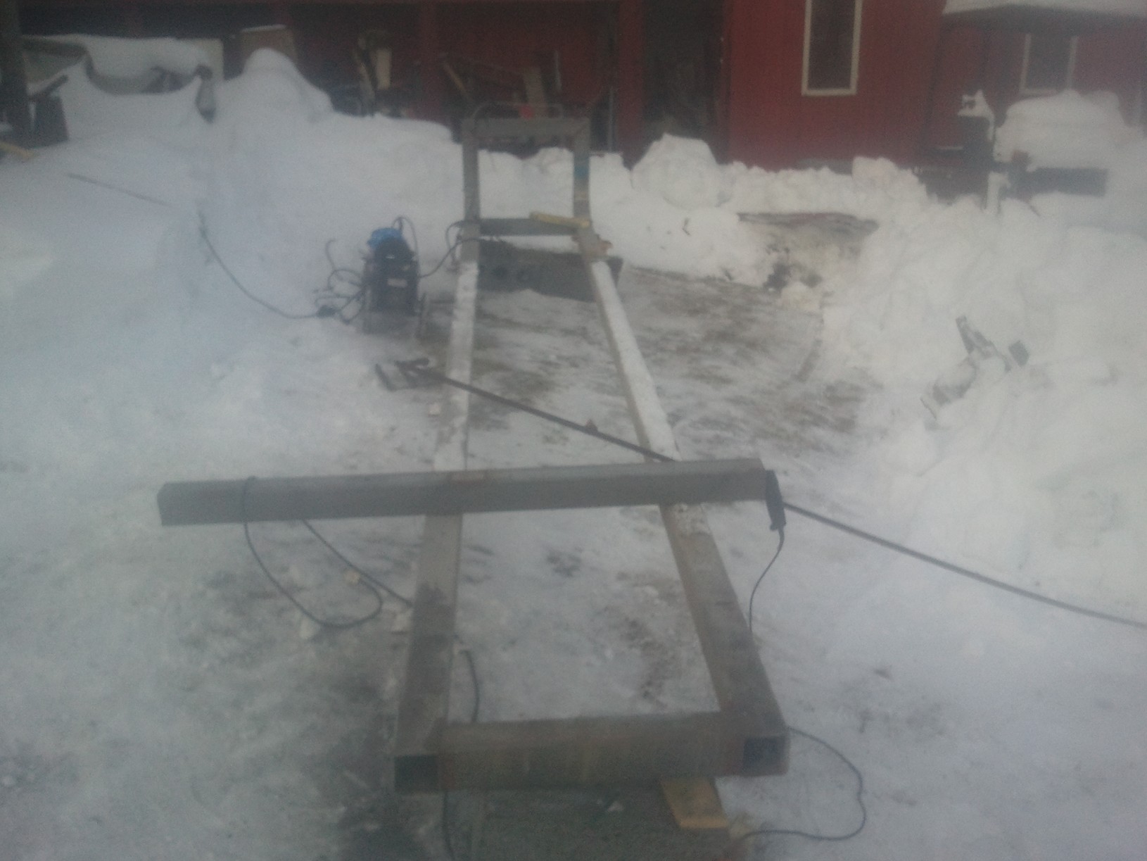

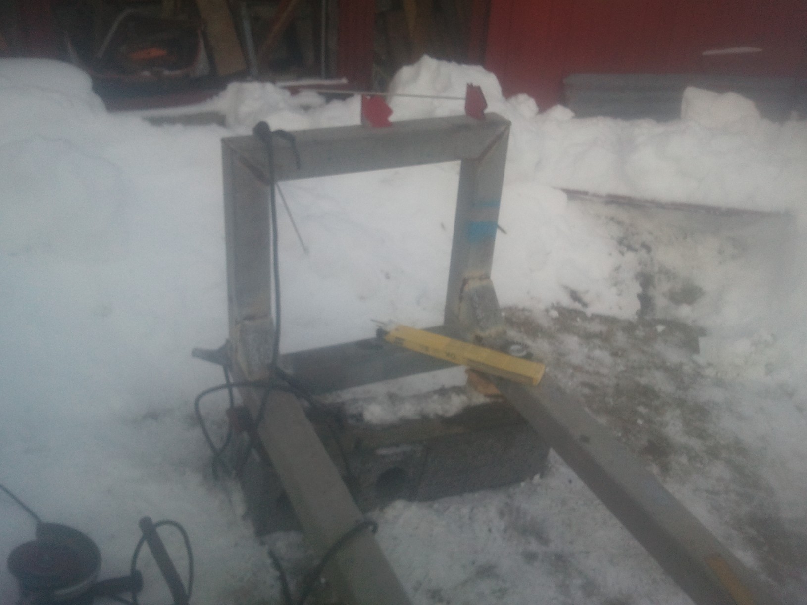

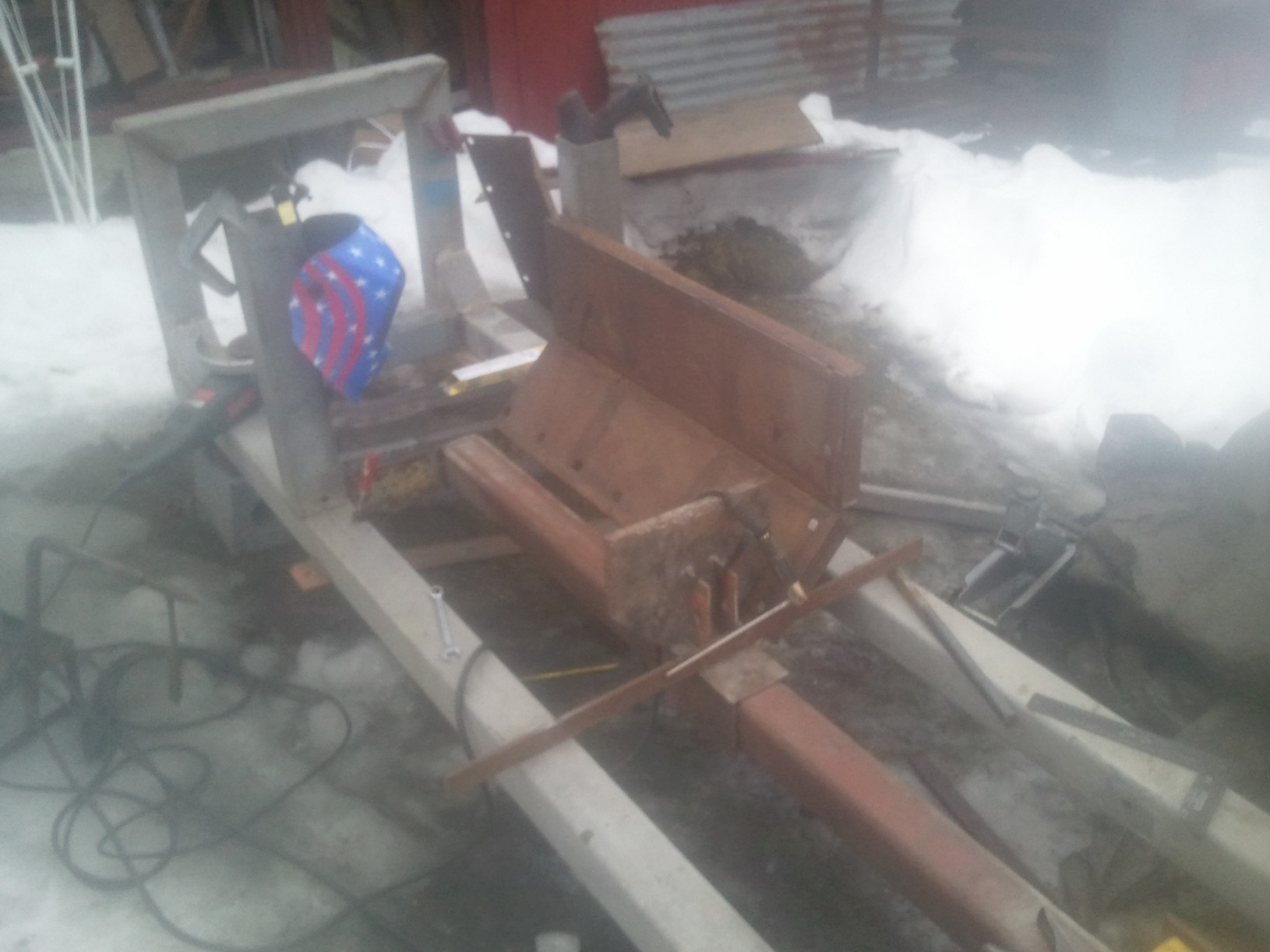

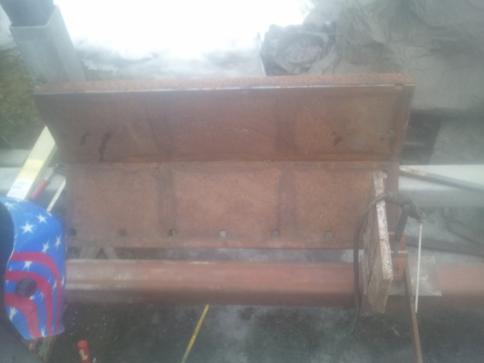

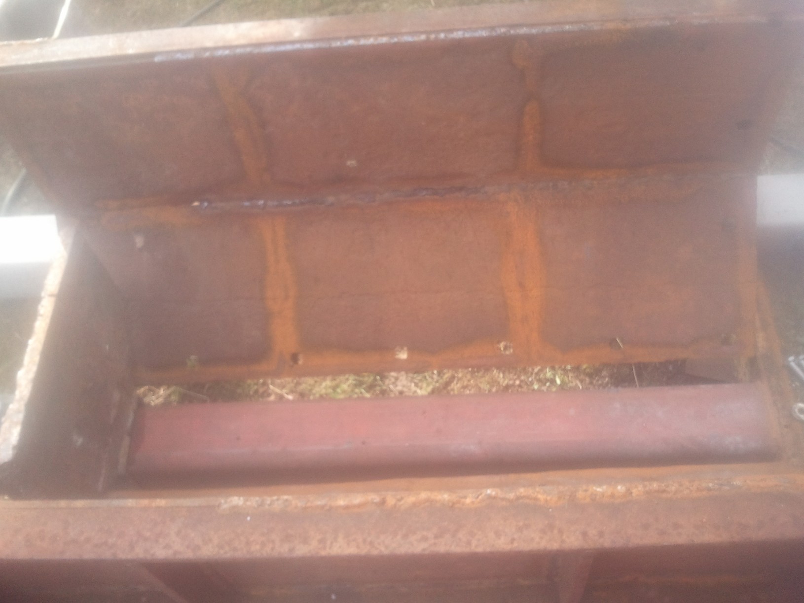

had done a bit on the firewood processor today, mounted splitter and begun to make plates that will be on both side of the splitter reinforced with a flat iron frame

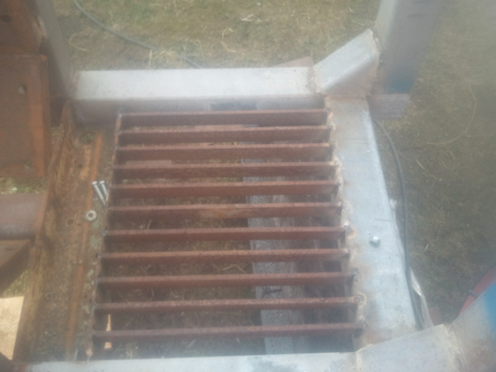

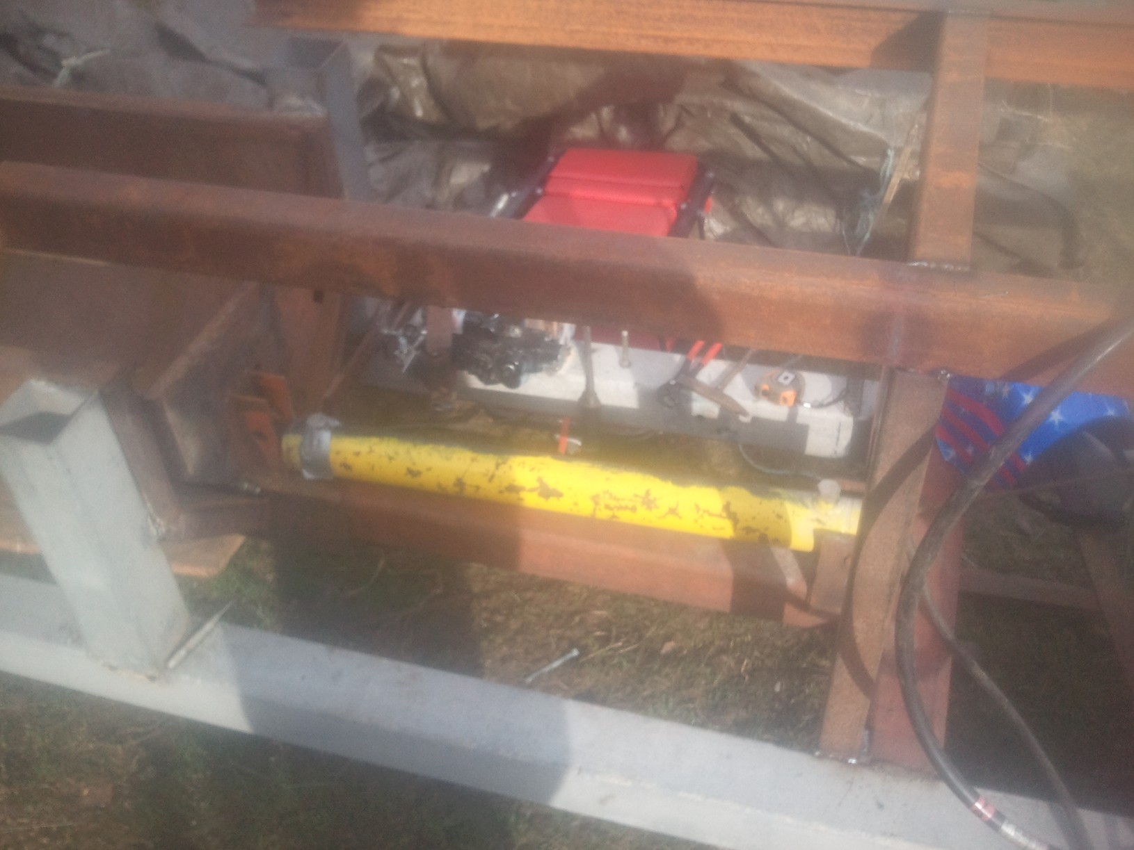

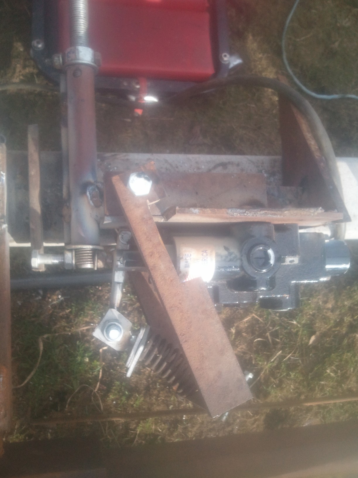

Here is a status update on the Firewood Processor
Have made ​​the bench as the conveyor belt will be mounted on a rack that will sort the wood chips and bark from the wood. And after reading online about the frustration around the auto cycle valve, I have decided to go for the mechanical solution to the problem, not quite finished with the mechanism and fine-tuning but you should get an idea of ​​how it works.

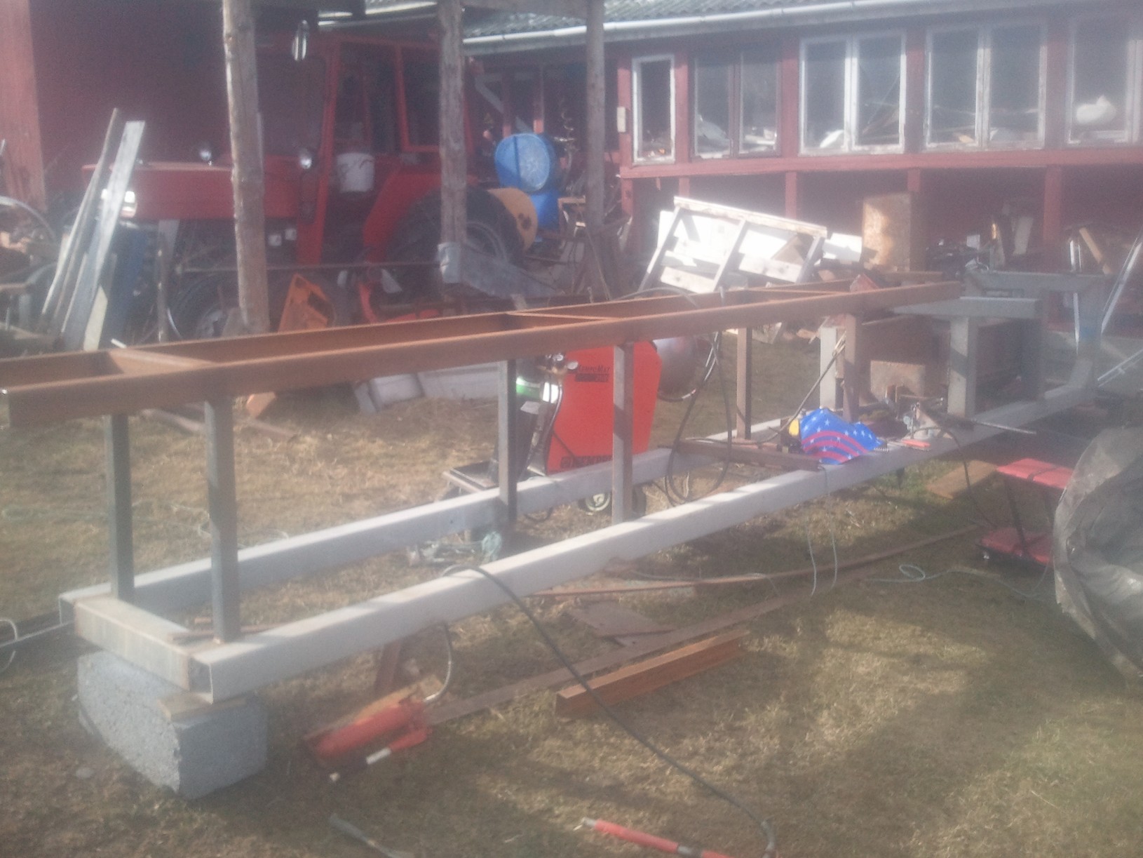

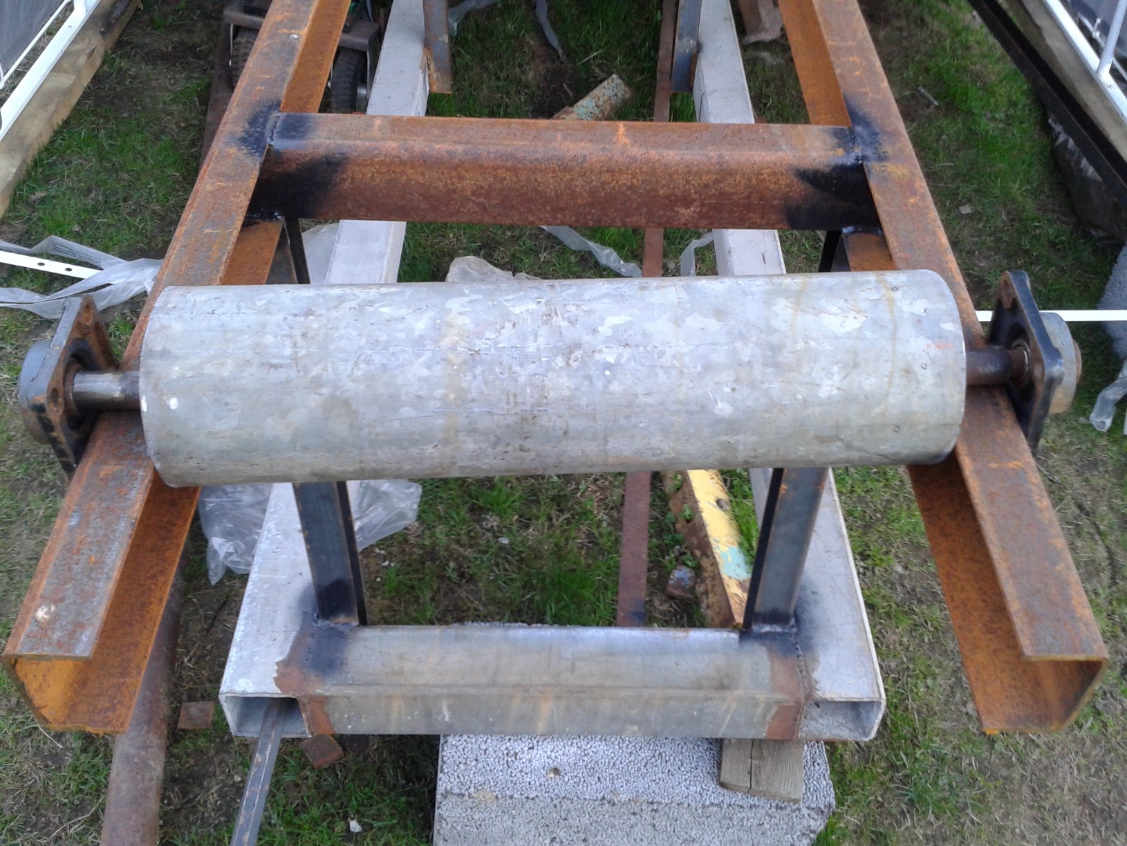

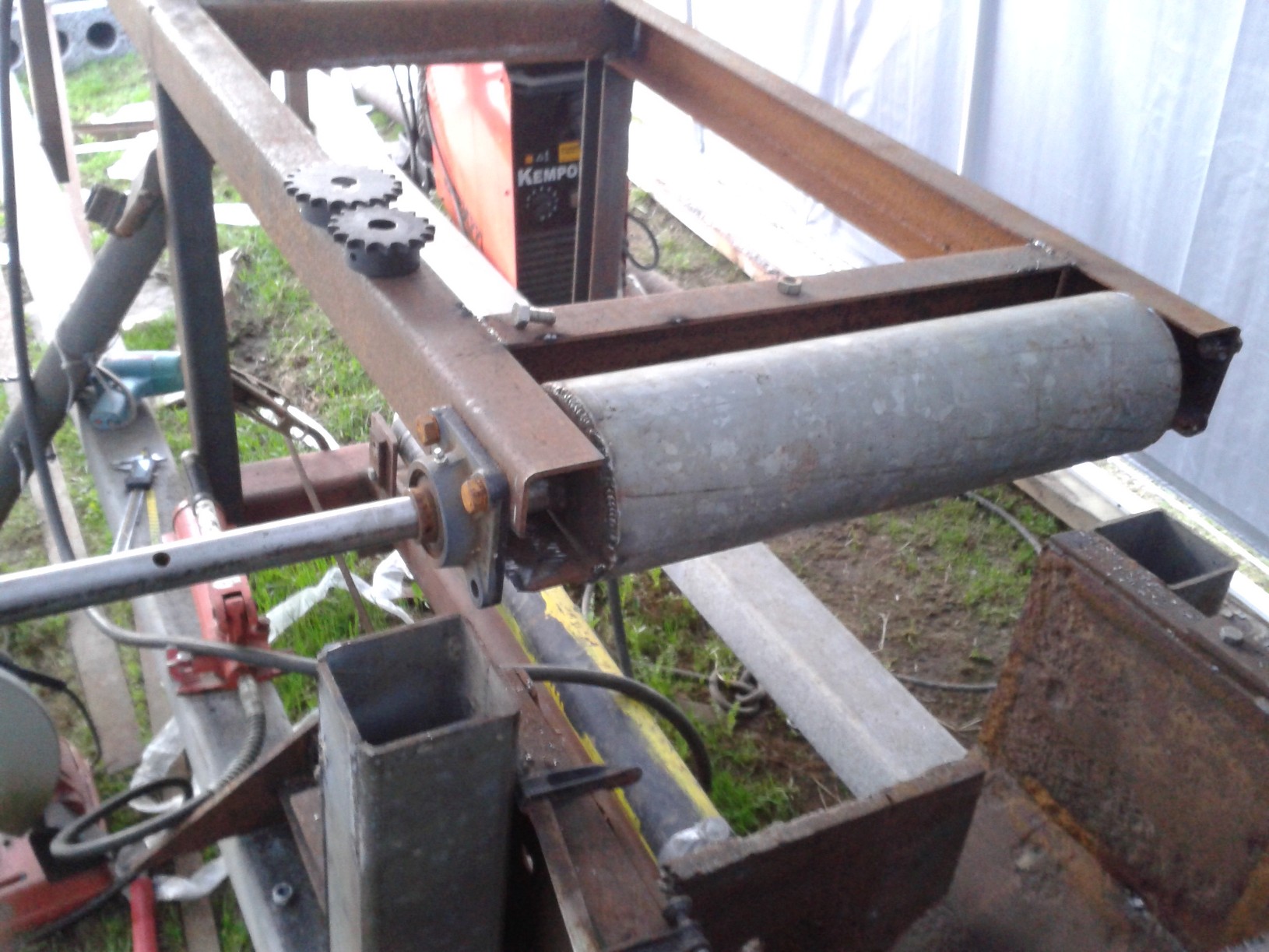

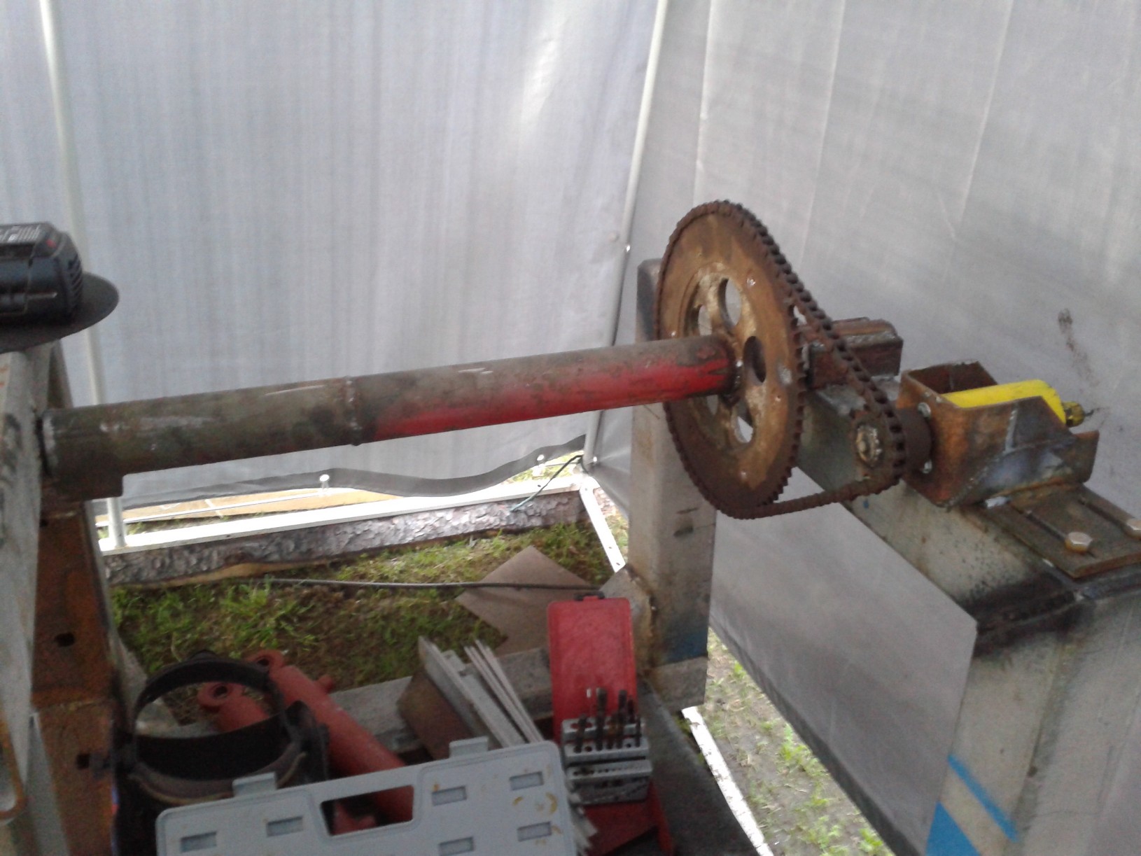

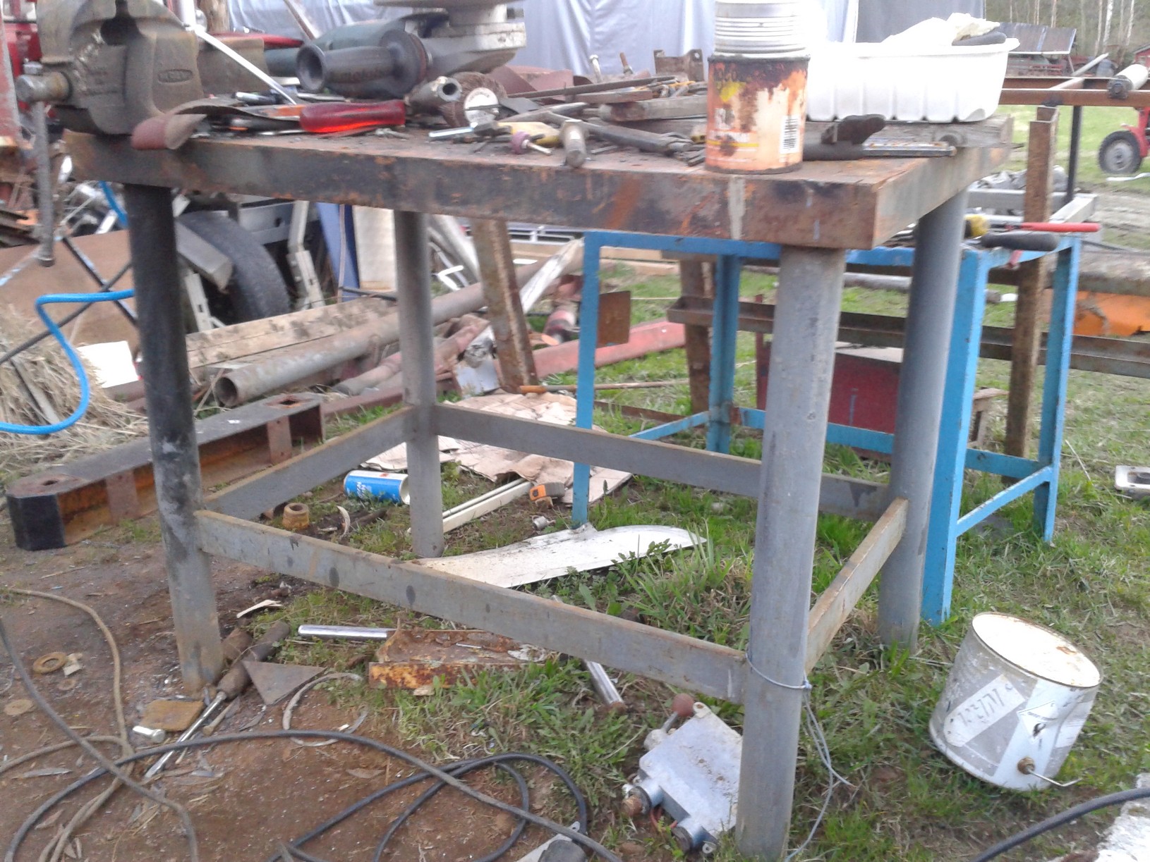

Have been a bit much to do in the past month since my dad died, but had got done some work on the firewood processor. Have been making ​​rollers that will be in each end of the infeed conveyor, made bracket to the hydraulic motor to the same conveyor belt. As you remember, I wanted to have an easy way to change the split between 4, 6.8 og12 so I've started on the shaft to rotate the wedges. Also sends a picture of the welding table, my plate at the top is almost 2 and a half inch thick. Never need to be afraid that it will be a dent in it when I massage a piece of steel into submision with a sledgehammer

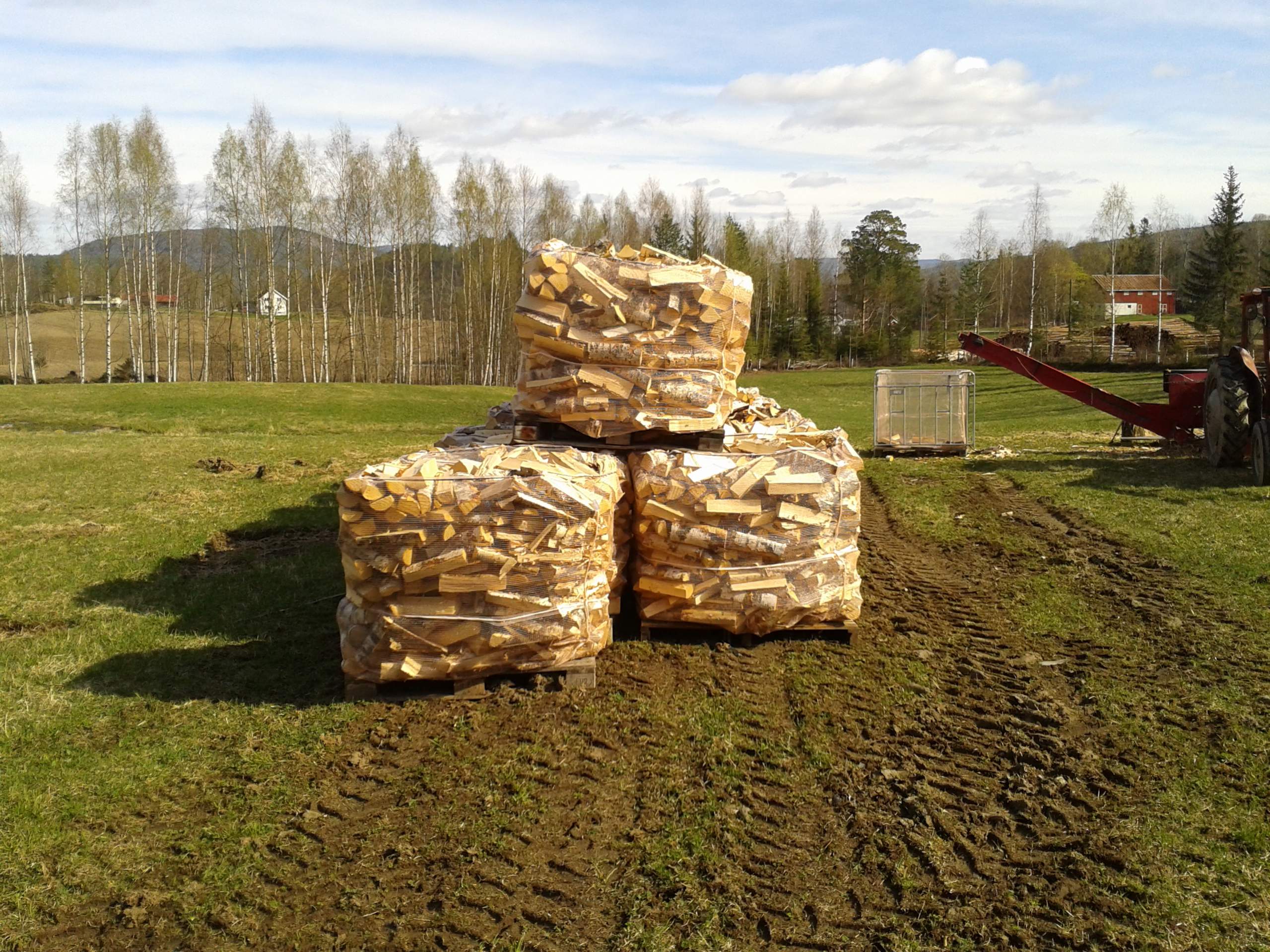

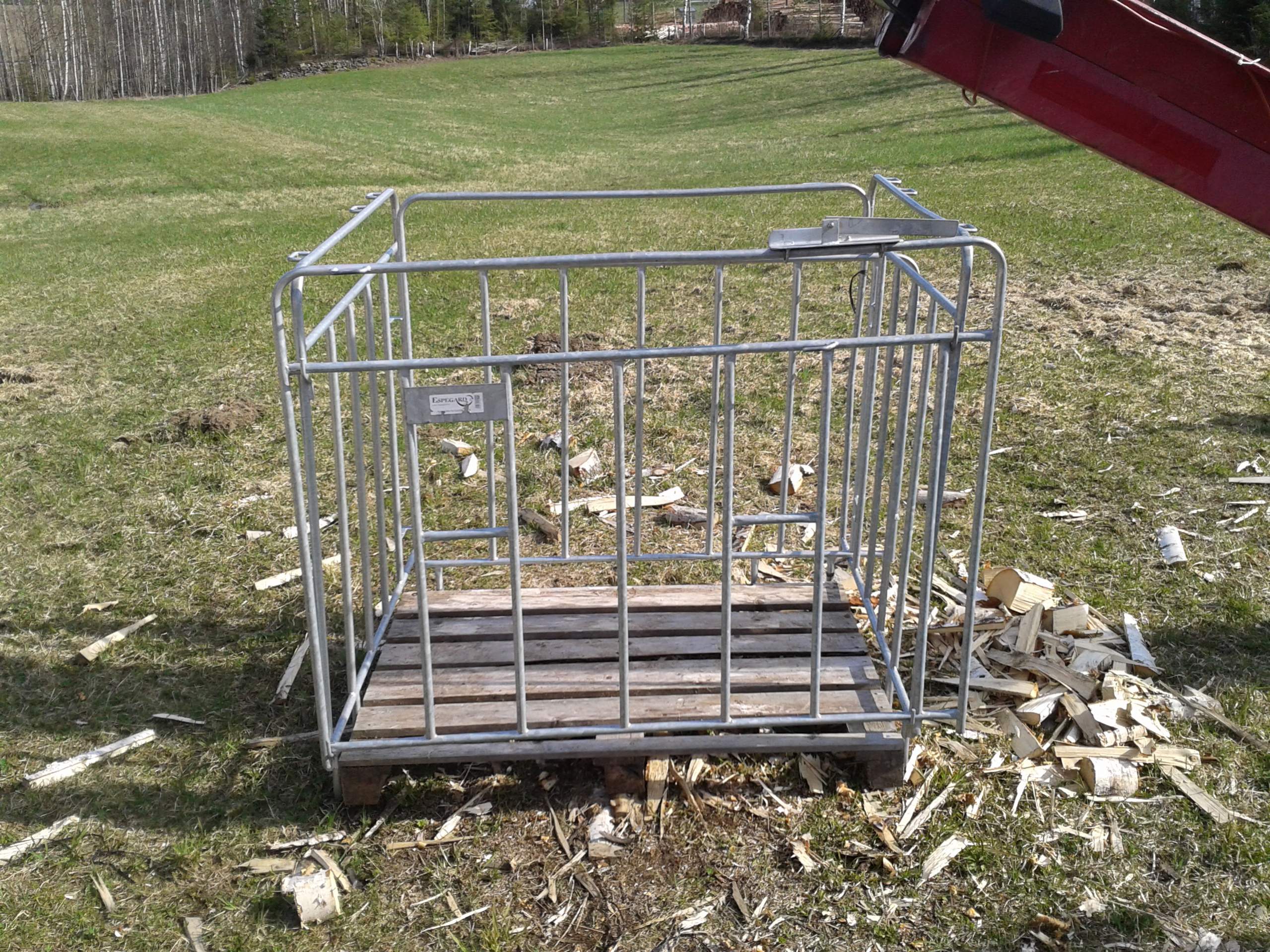

I've been trying to figure out the best way pile wood on a pallet and have it stackable. I just ordered, and received the very next day, these firewood bags that are going to be awesome. I'm in the process of building a frame similar to the one shown and will start piling this weekend. Each bag was only $3.50, they're bunched in groups of 200, but he let me buy only what I needed. He also has other products that may be better for your needs. His name is Maurice Wilson and he's great to deal with. You can get his contact info from the site.
I use the same bags for the wood, here in Norway you get them in 2 sizes 1000L and 1500L. also smaller bags in sizes 40L, 60L and 80L. These are standard size for all fuel wood sold in my country. 60L is the most popular of the small bags. I have also seen IBC cages have been used by people who only produce for their own use

How do they work for you? I'm building my frame tomorrow and I'll start trying it on the weekend.

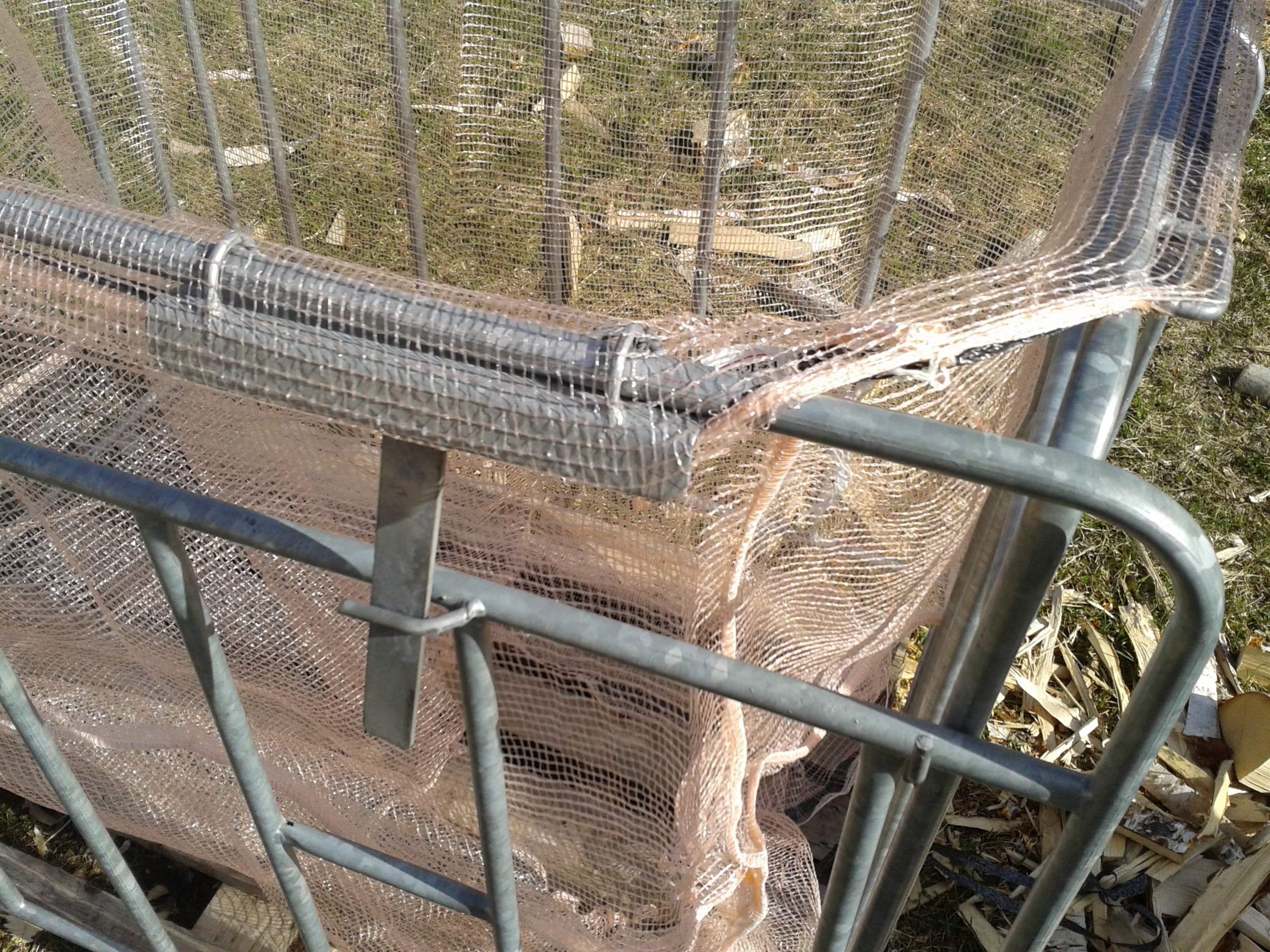

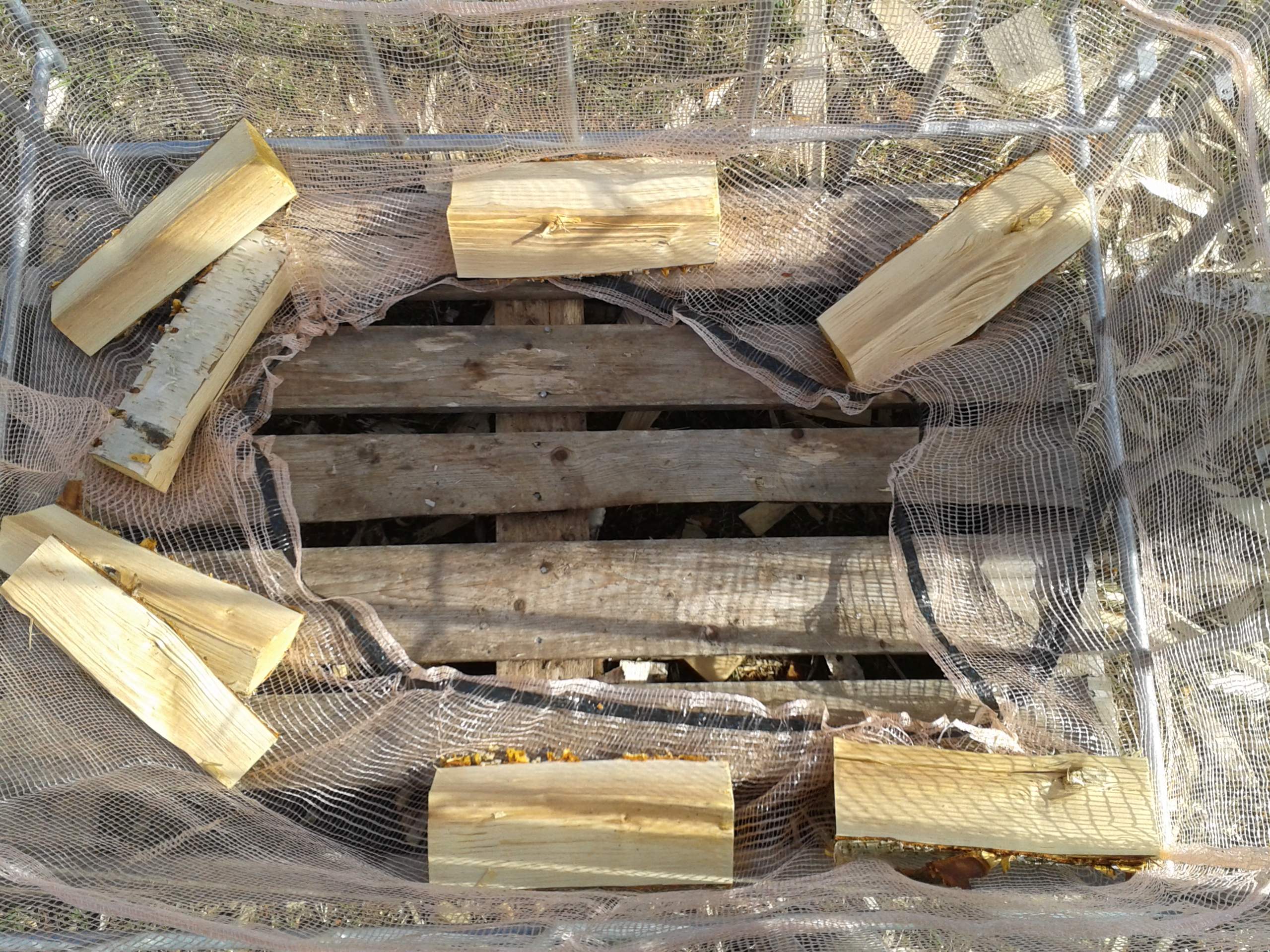

I am pleased with the bags just make sure and throw a few pieces of firewood in the corners and edges, otherwise you will have a bag where you can be sure that either fall over or come loose at the bottom with the consequence that you have firewood everywhere. Tighten the cord in the bottom about an arm's length and you should be ready to go.
Also make sure you pause once in a while and make sure you get the wood evenly around the bag. The beauty is that you can stack the bags, I've seen stacks up to 6 levels in a large shed with three walls where cladding set 2 inches apart.
