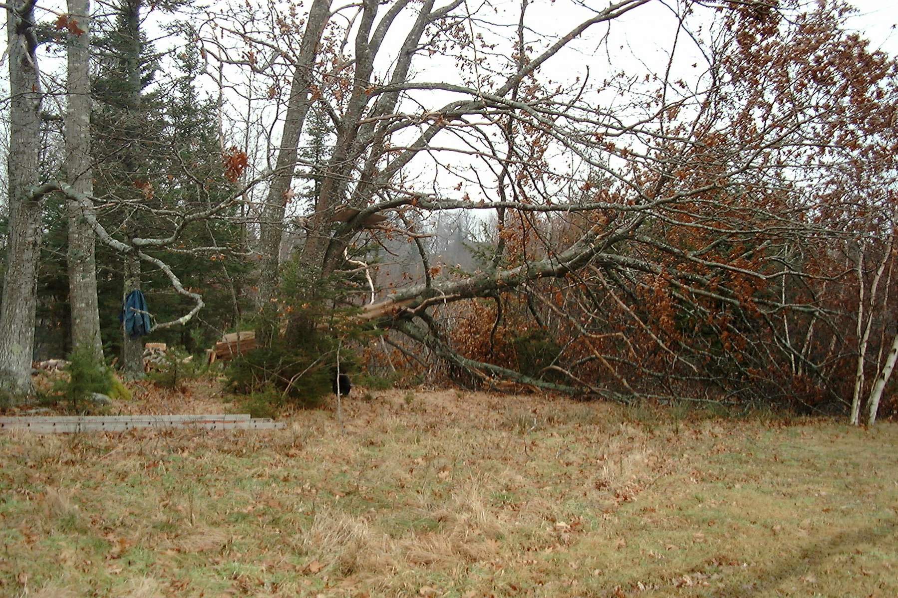

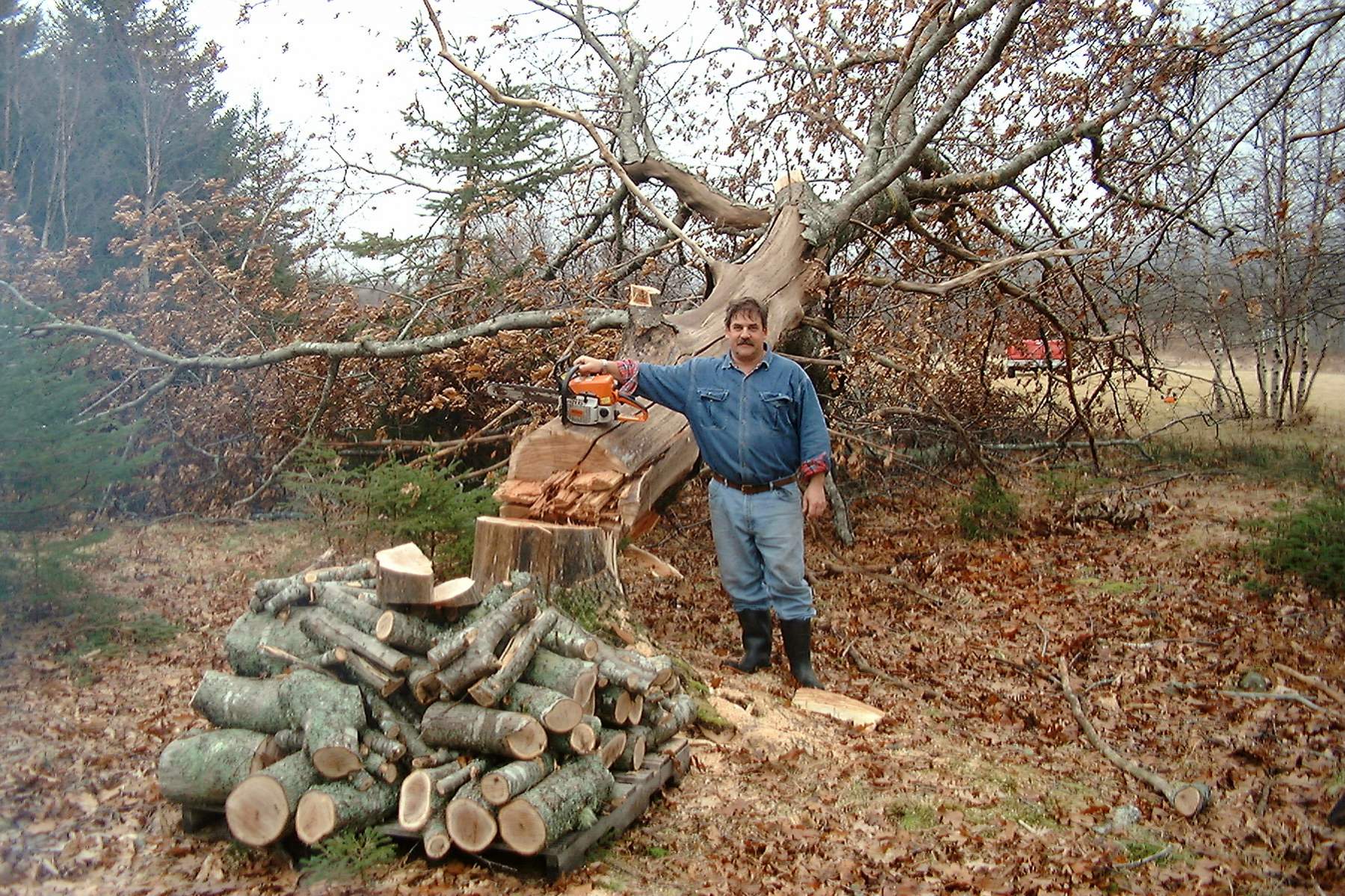

Many years ago... We had a major thunder/lightning storm. Heard a loud crank and boom. Got the family up... scared the crap out of me. A few weeks later my daughter and I were sitting in the back yard looking out over the fields. We saw this vertical "orange" line in the woods. Off we go to investigate. The oak was hit by the lightning. It peeled the bark off and split the tree trunk. I think I got a full cord and a bit from this one. The hard looking guy is me before the weight loss. And yes, I do wear protective gear now. I am older and wiser. And I put that stihl 025 saw through its paces!
I love working in the woods... and sometimes I find a stump and sit and think... peaceful.
