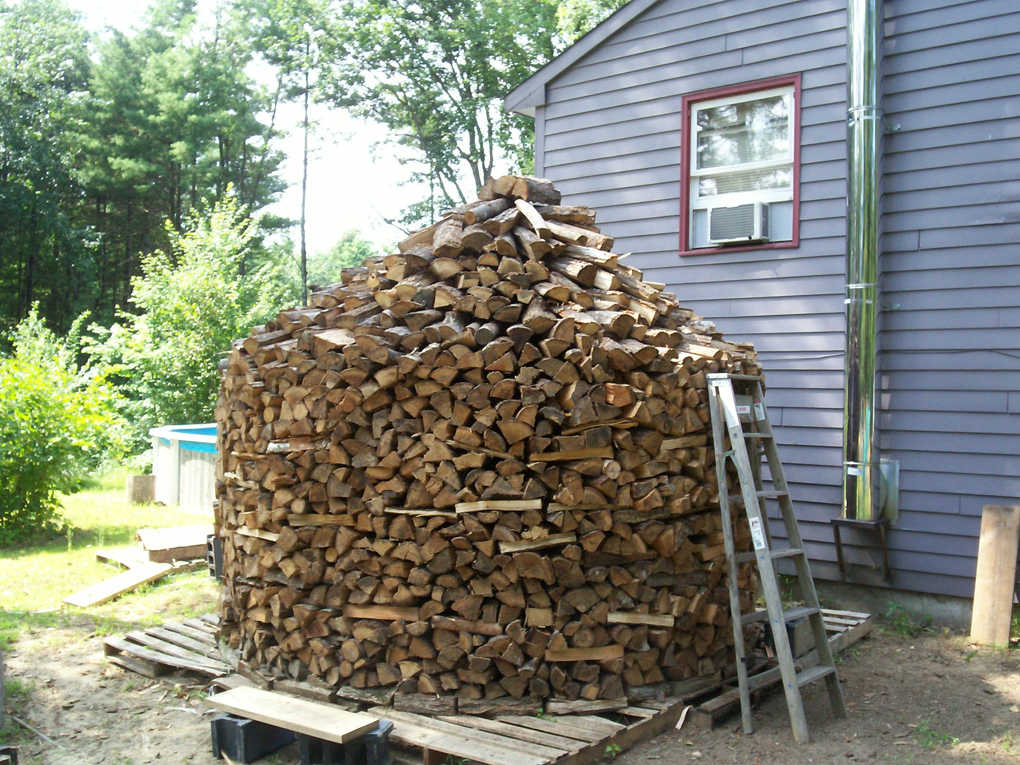

I've been reading about the holz hausen and built my first one. My first attempt (10' diameter) totally collapsed into a big heap when I got to 8' tall because I got impatient. I randomly tossed about a half of a cord into the middle with the idea that I would climb in later to restack it correctly. I didn't realize that the little impacts of each piece landing were slowly causing my side walls to expand outward. When I jumped off my truck to look at it, the walls were tilting out badly. As I was realizing what happened, it fell with a mighty roar. I got discouraged but decided to rebuild it. I stopped the outside wall at around 6 feet tall and started tapering in the top pieces. My estimation is it has 4 cords. The wood was already seasoning for about 6 months so I didn't do it to dry the wood quickly. It took 2 people about 8 hours over the course of a few days. I plan on building a 10' tall one soon.

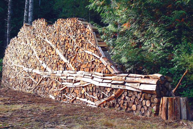

There are some artistic souls out there. Not my pile. Found this on the "freecabinporn" site:
