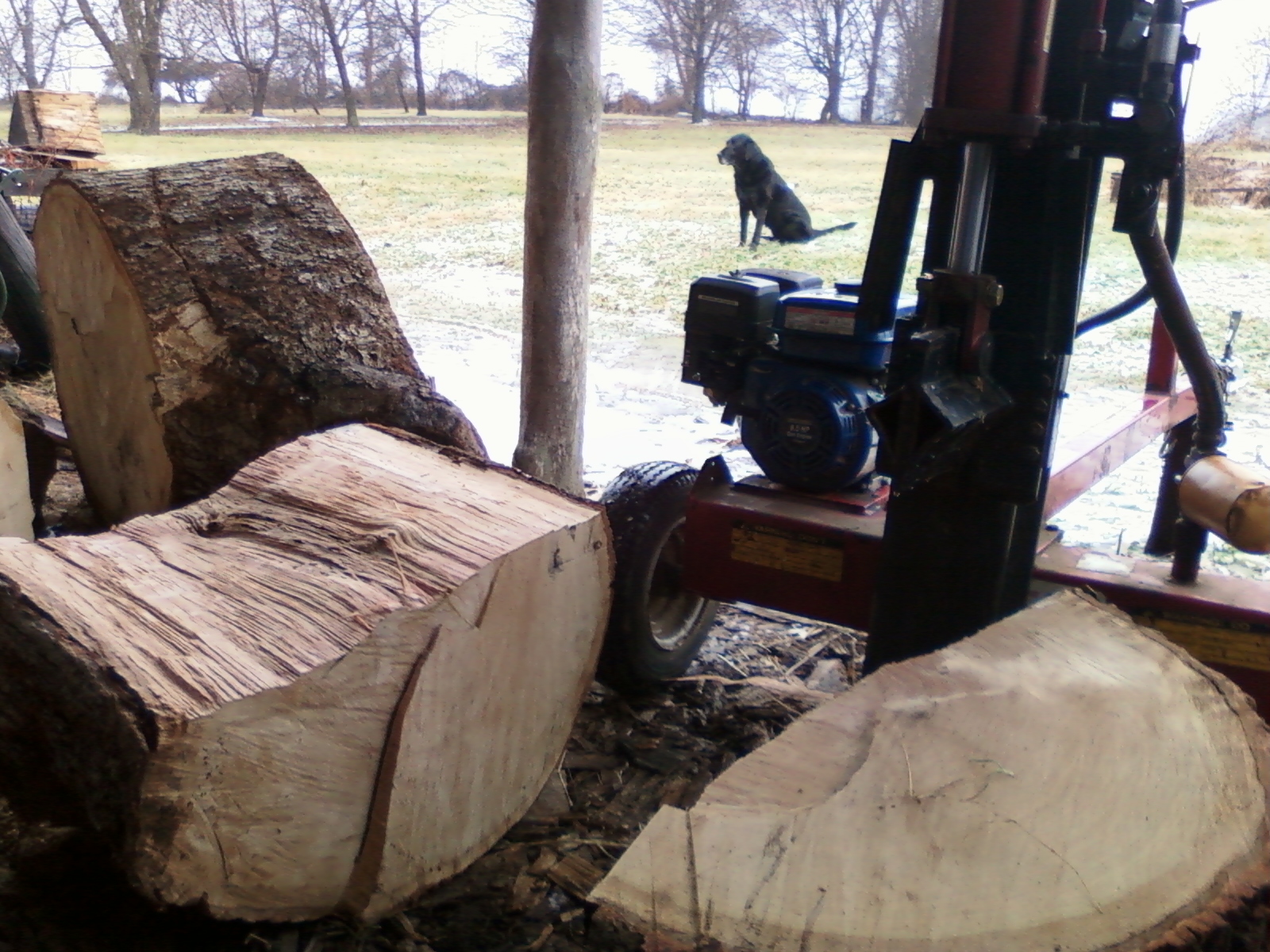

I like the stand up splitter so you can roll big stuff in place and operate the lever .....all by yourself.
