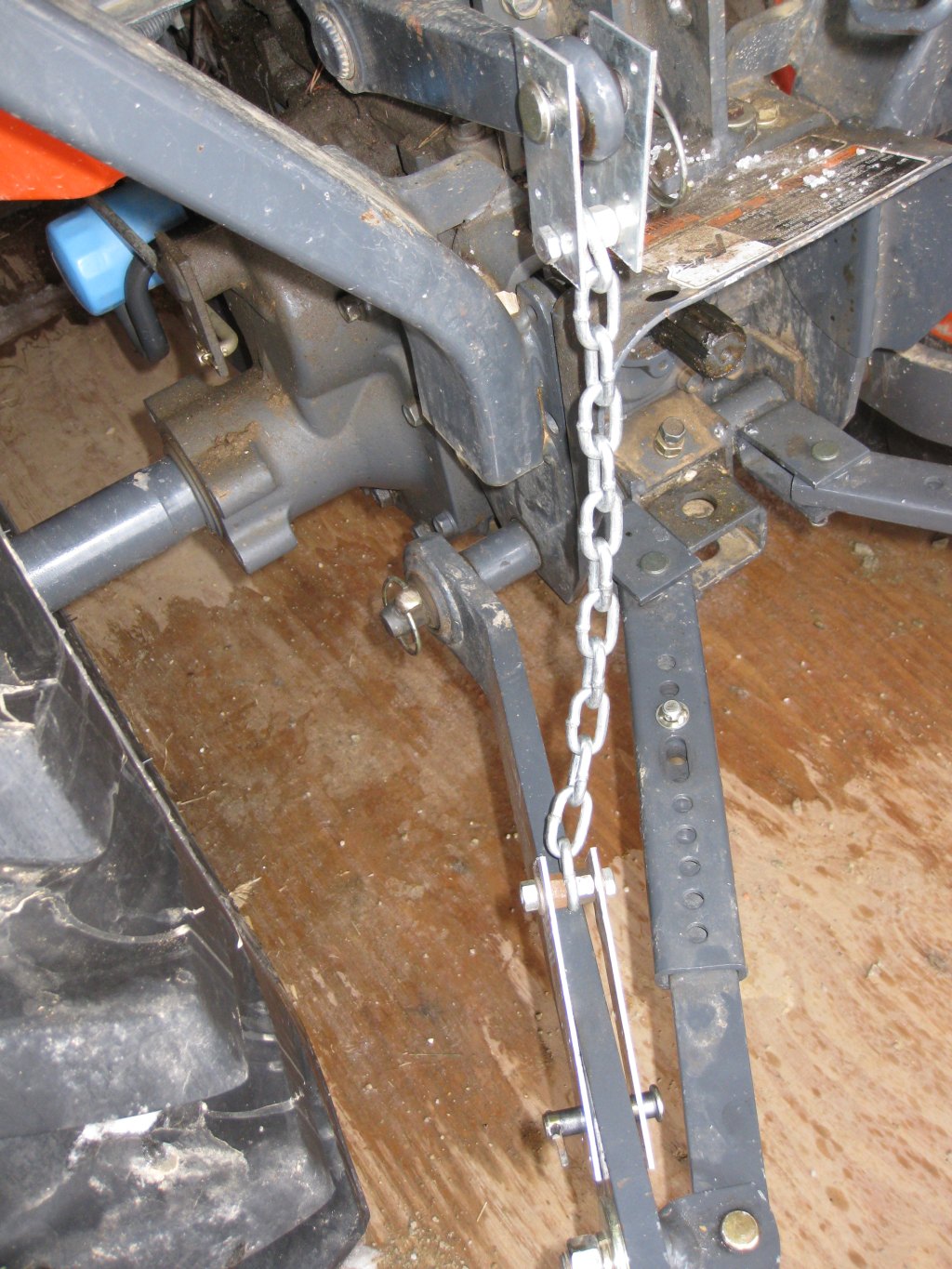

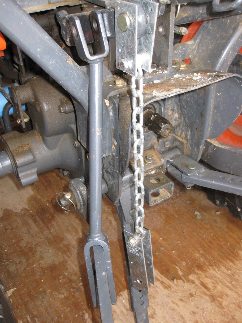

Gotcha do you have a picture. How did you connect the chains ?
On my B7800 I replaced the vertical links on the 3pt with pieces of
chain. The rear blade can now float over the surface and doesn't
dig into the driveway. Works better than I thought.:D
Bill
   / First 5 hrs on the B7800 #14
From the two "lift arms"of the 3pt., I removed the vertical links, and using bolts and a u-shaped pieces of steel, replaced the vertical links with chain. The 3pt still lifts the back blade as usual, but if the tractor and what you're plowing don't match, both sides of the blade are free to float and match the terrain. No more gouging the driveway.

I think the chains were installed to allow the blade to adjust its height side to side to areas with different crowns. Floating straight down frequently results in ripping off the crown or digging up the edge of my gravel drive. It never seems right until I have essentially flattened my drive and removed the drainage crown. Then water runs down the center of the drive and erodes it. So I build up the crown again in the Spring. It is a pain on the B7800 to get off the tractor and adjust the tilt of the 3PH with that screw on the right side. Also, I noticed that when the tractor tilts a little, the blade tilts too and digs in. There is not really one setting that works for everything.
If you had some pix of the chain mod it would help us match it. I think this is a wonderful idea that I could really use for both my landscape rake and the blade. If I could get that blade to conform better to the gravel drive it would dig snow instead of gravel!

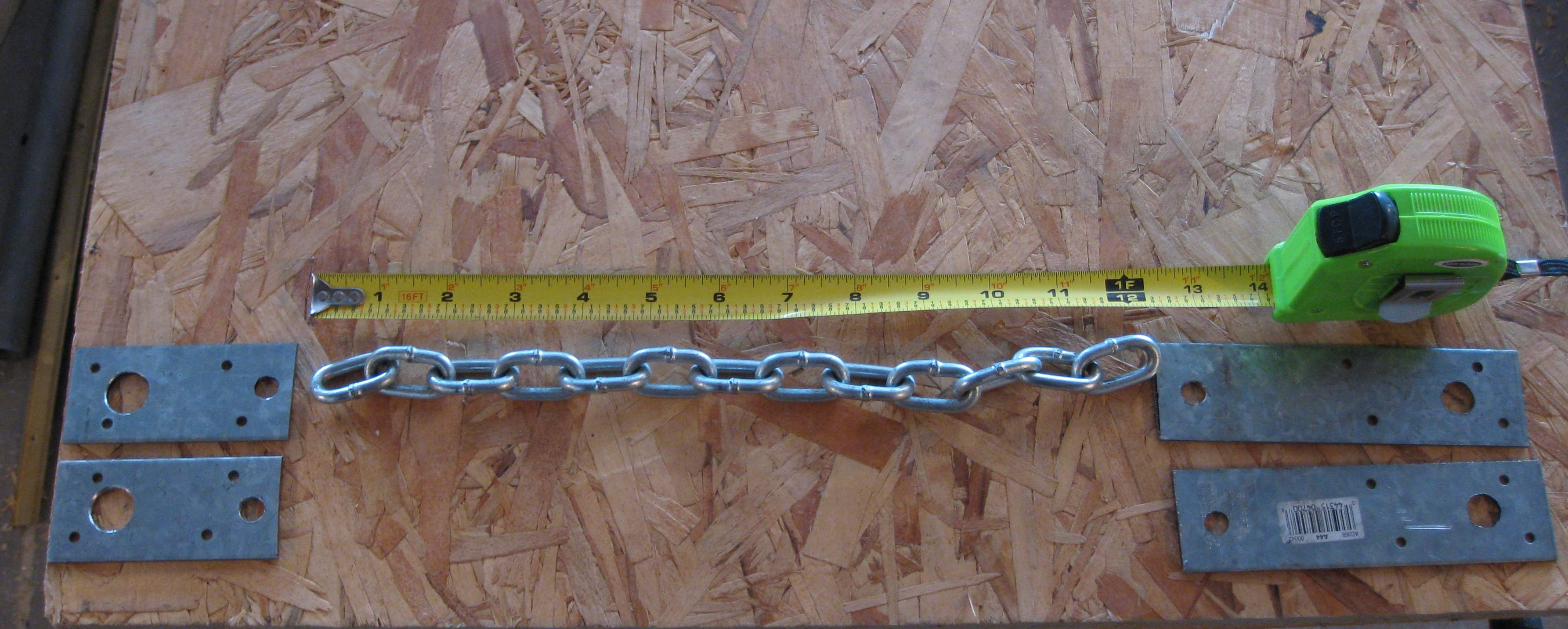

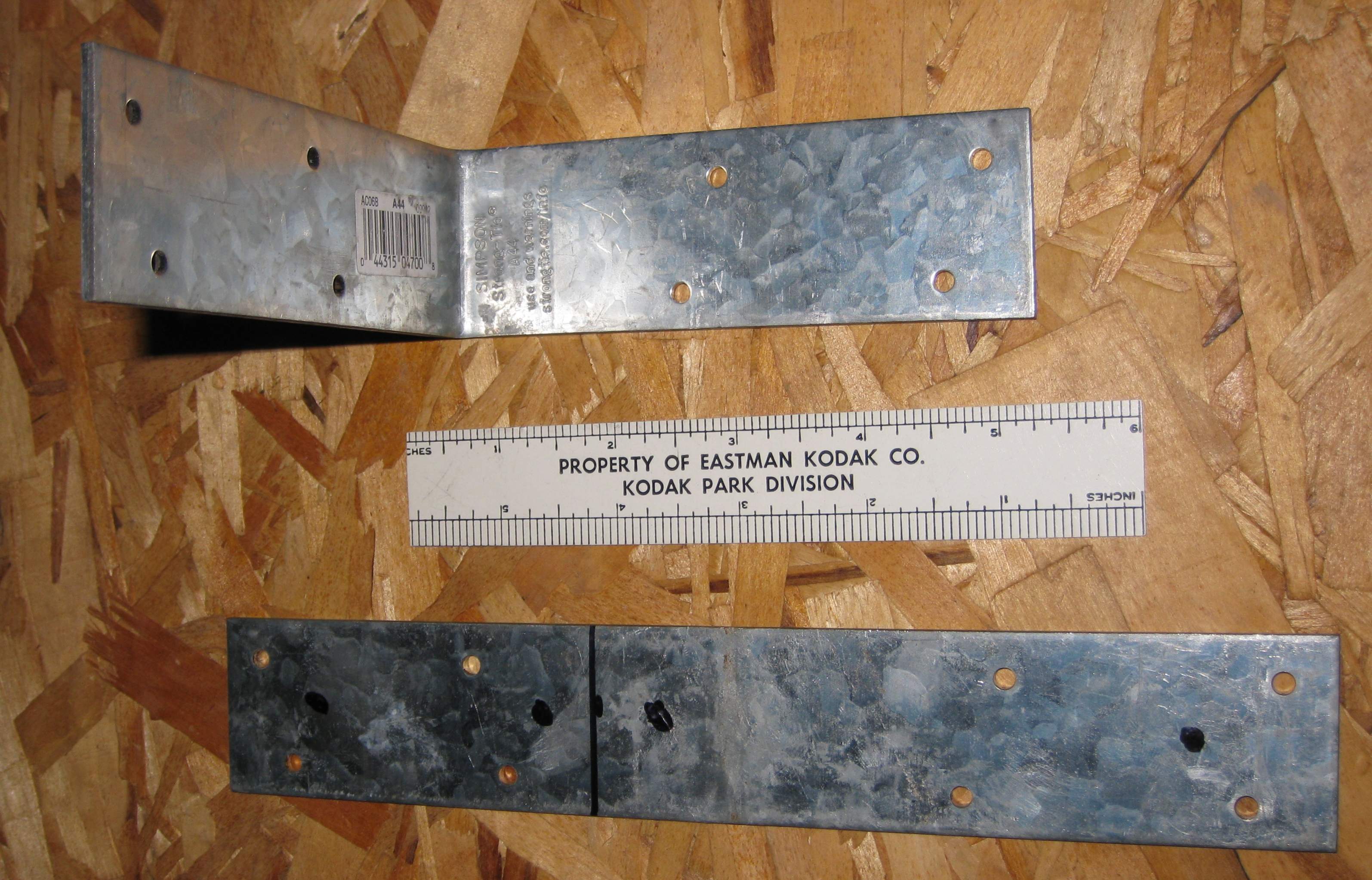

Well, I am no machinist, but I put a chain on one side of my B7800 (the non-adjustable side) today, using what I had laying around. I made it about 2 inches longer than the original arm. When I lift the blade, it sags a little on that side, but when I lower it, the blade conforms to the slope of the drive really well. I should have done this a couple of years ago! Here are a few pix.
