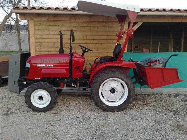

Hi All, It is time for my first service and am asking if any one has any particular advice for me. I am in France and the local agricultural garage has not seen a Jinma before. They seem to know their stuff with the more common tractors. There is the language problem and where you could normally have a chat with the mechanic here I can't. The handbook is in English so that's no help to them. Any suggestions / comments would be most welcome. Thanks.
