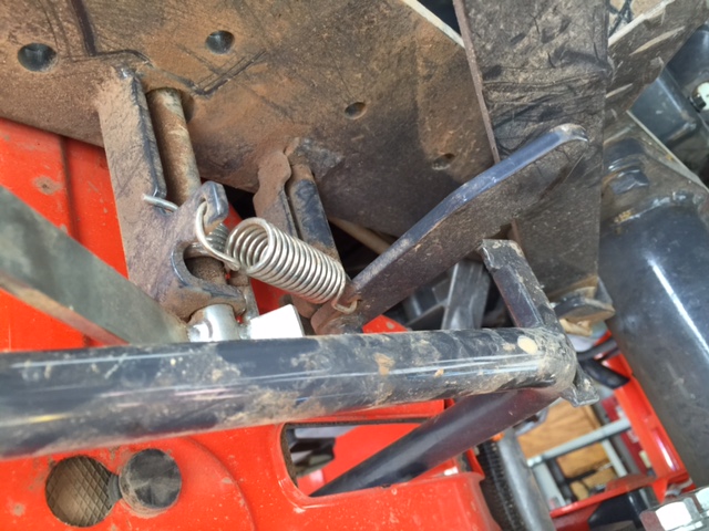

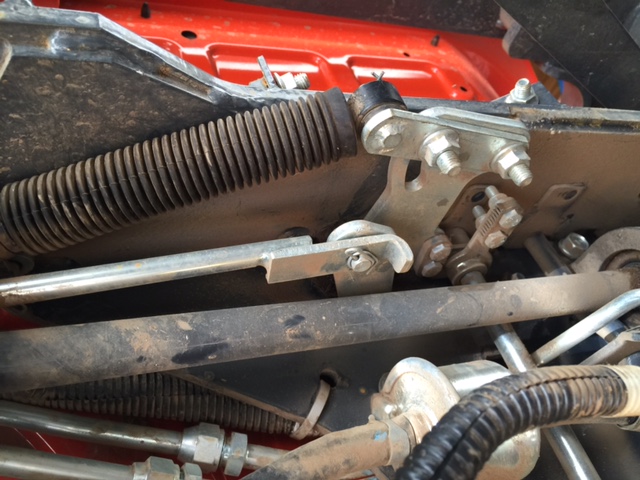

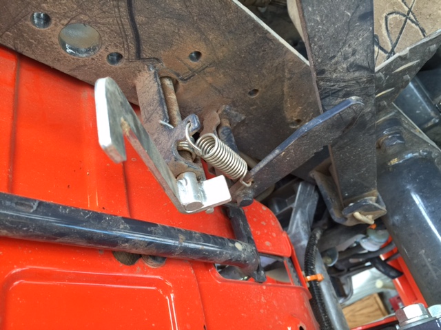

Hey could somebody climb under their BX (without skid plates) and take a couple pics of parking brake mechanism, both directly under the parking brake pedal and on the left side where the brake pedal and ratchet is at? I think something is missing or bent because I don't have engagement of the ratchet on the brake pedal.

Here are a few pics of mine... sorry should have rotated for better orientation.
